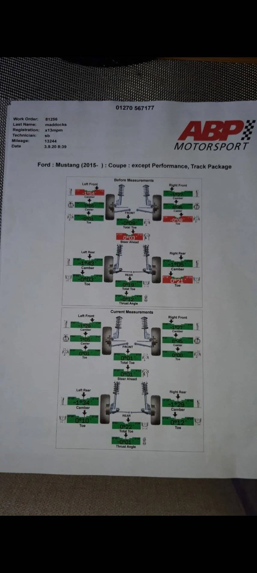

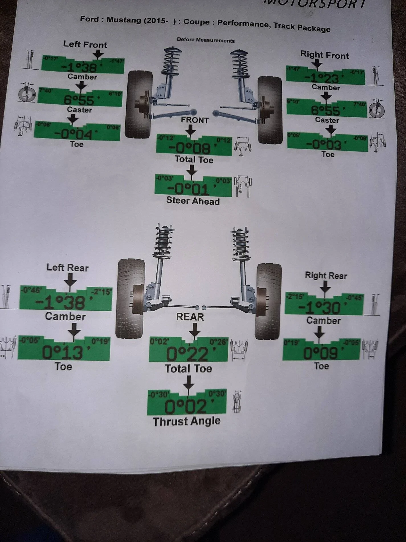

So I had the bmr cradle lockout, steeda centering sleaves and bmr 2 point brace fitted last aug. I took the car for a full allignment about a week later and they aligned it. Fast forward to about 1400 miles later and having her serviced today the mechanic says the tyres are wearing on the inside edges. So looking at my printout it shows non performance pack non track pack which is wrong. I've been back to the shop today and they said if anything the settings they applied would reduce the inside wear and going by the performance pack settings it would run more camber handle better but increase wear. Does this sound right? Attached is my printout. I'm taking the car back froday and can have the performance pack settings put on but if this has resulted in my MPS4s tyres prematurely wearing id really like to know!! Tyres have around 9000 miles on them.

Your front Camber value is a bit strong for a PP. Standard PP's from the factory quote around -1.03, Toe-in on a PP is around 0.00.
Have you changed the front strut to hub bolts with the adjustable cam ones to dial in your Camber?

Thanks for the reply. Do you have a picture of the settings? So 1.03 is less so therefore would reduce inside wear? Abp were having none of it saying the pp has more camber so if they change this it will wear more. Should I be pushing for new tyres?

Go to a thread from 'Gibbo205' titled Gibbo's Handling Guide to the S550 Gt Mustang from 1st March 2016. A lot of your questions will be answered here.
The Camber Bolts are a must if you want to sort the front out, either BMR or Eibach do them.
your inside tyre wear is very definitely from camber. I'd also try the toe-in at 0.00 to reduce wear.
Hope this helps.

So I've been back to the shop and they said they couldn't pull any more camber out which is funny as they did manage to last time. They have added more toe to offset the increased camber, they said that should move the wear from the inside to the out. I'm tempted to take it another garage. Sigh
