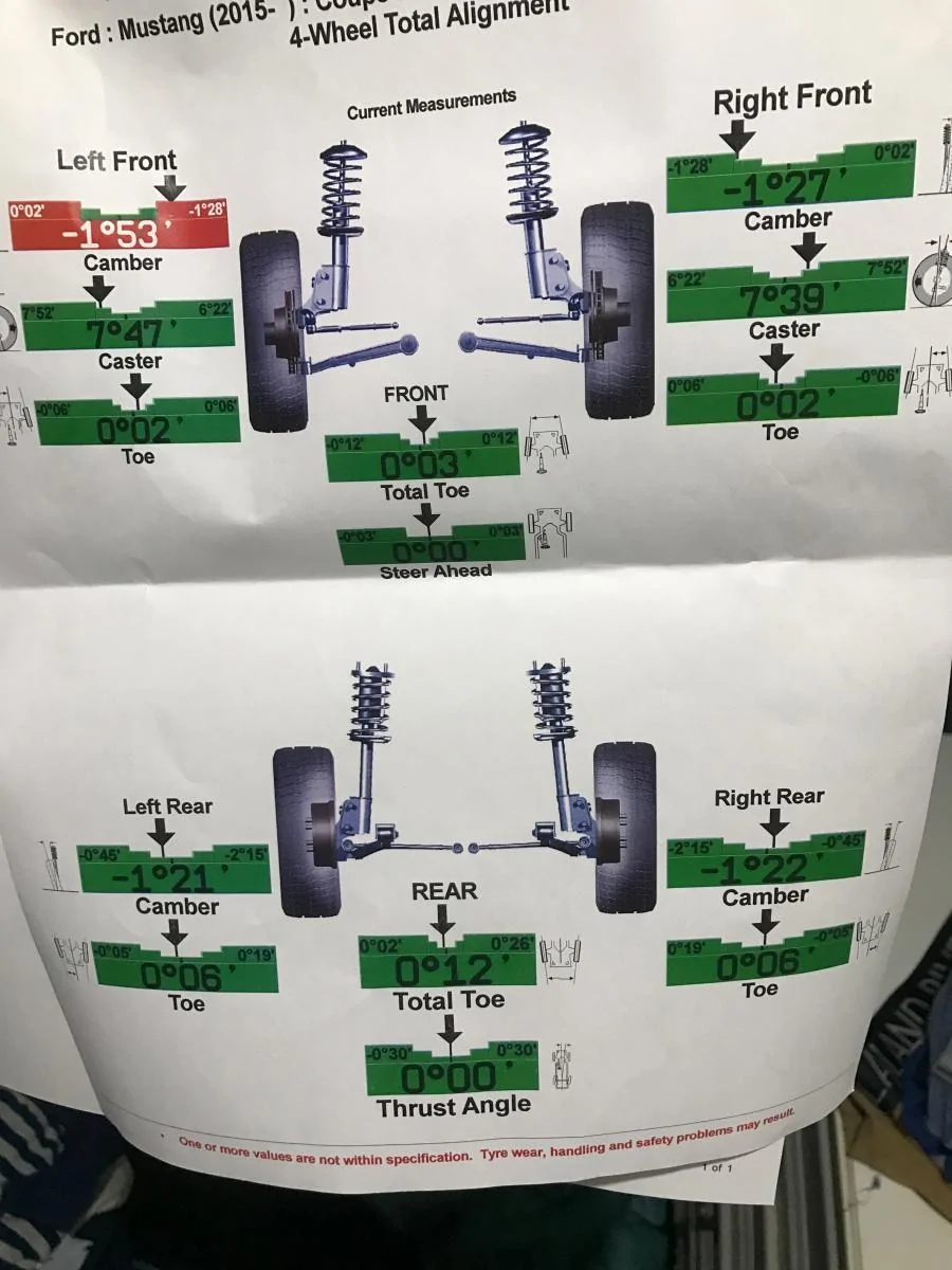

I had my alignment done the other day after installing some sportlines. They couldn't get the front left camber to spec (-1.50), although it is only slightly out. I am going to leave it at that tbh.
Anyone see any long term problems other than maybe faster tyre wear on the inside..?
Thx

Should be fine, if you find its a bit twitchy on the front either get camber bolts or dial in a touch more toe in on front axle but I see your running 2 minutes toe in per side so it should feel pretty planted.
Tyre wear maybe a touch on inside, just keep eye on it and swap front wheels side to side if one side wears more than other.
