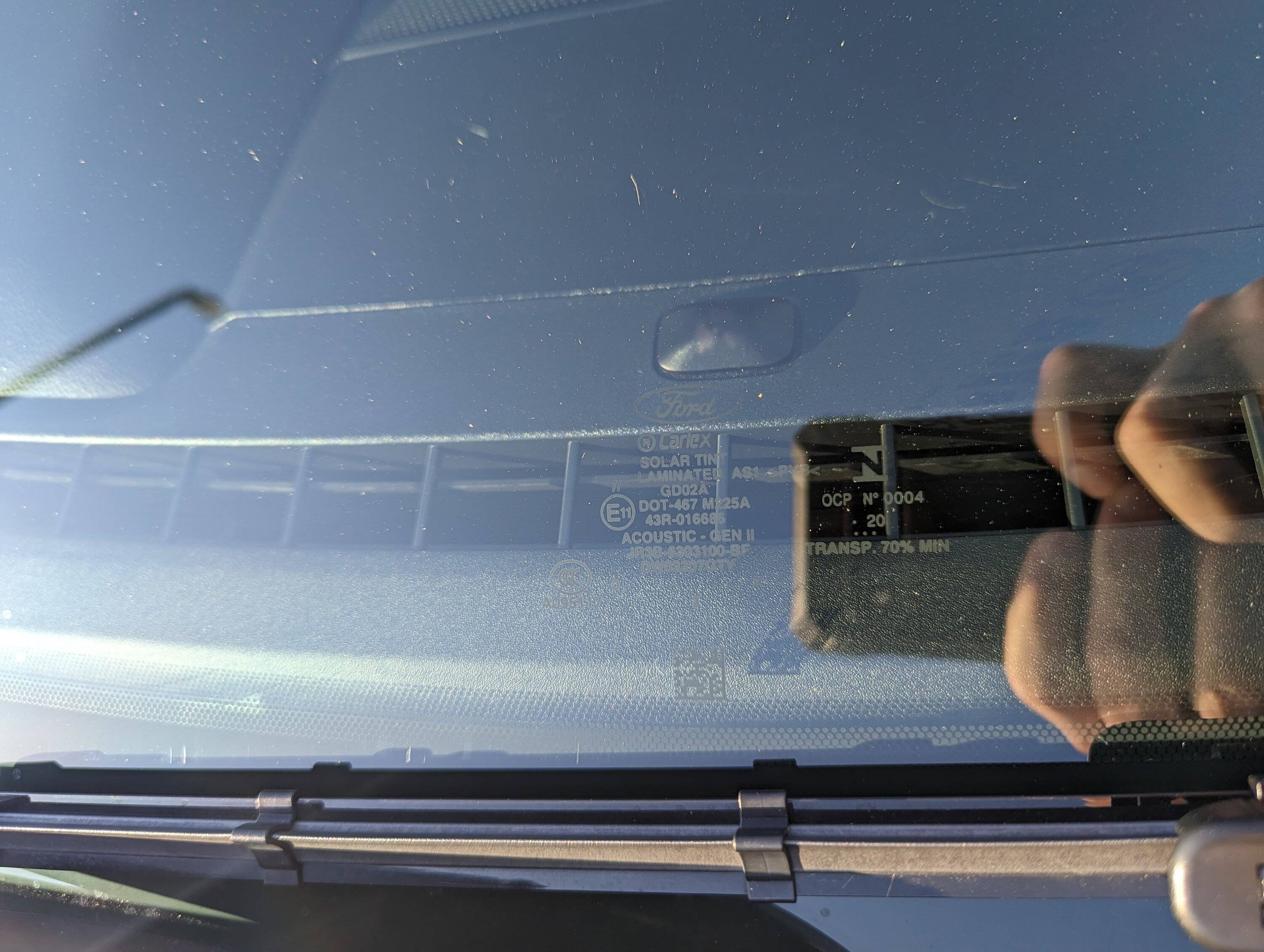

Outside of that, I've dealt with F-150s for water leaks into the BCM causing all sorts of weird stuff and corroding connectors - not to say Mustangs are exempt. Have you had the windshield replaced or noticed any water leaks? Even OE windshields haven't been installed with the best sealing lately...

As far as I can tell there are no water leaks, I have the car in the car wash at least 3 times a week right now and I don't see any water at all in the car. Since I am the second owner of the car I have no way of knowing if I'm still on the original windshield or not, but since the car only had 6K on it when I bought it, I'm going on the assumption that it's OEM.

I don't see anything that says Soundscreen. It does have the Ford logo. See attached image.
Looks like an OE windshield, most aftermarket ones don't have a Ford logo. If you have Forscan, I think so. I've never used it, but the PIDs you'd be looking for would be alarm_event1-4. Worth a try if you have a laptop and USB-DLC cable (see what works on their website).
