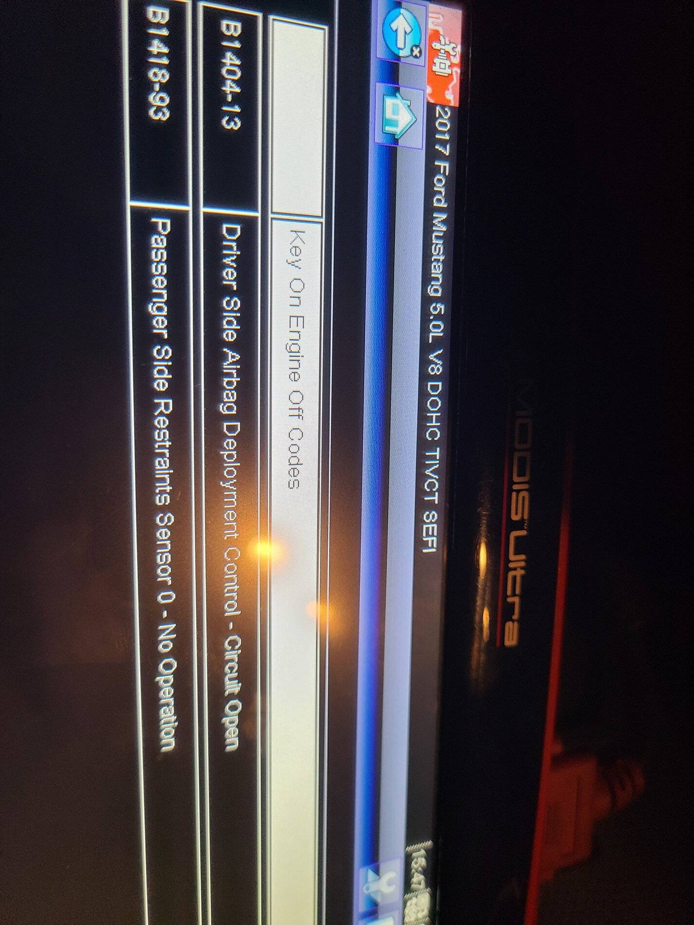

I bought a 17gt roller that was parted out. I built it with a wrecked 16gt I got from copart. I'm having these two codes and can't seem to go away. I put in the 17 a steering wheel bag, knee bag, (they were previously sold) and used the 16gt seats where I only replaced driver seat bag. I tried the sensors in the front radiator support and sent the module to safety restore just in case.

I don't if this will help, 1st post below is an older thread where I had posted airbag diagnosis from shop manual:
https://www.mustang6g.com/forums/threads/next-step-in-repairing-my-2018-airbags.120096/#post-2514527
This post, read from #96 forward - and if you need additional help, try reaching out to @PaulyB - he did a salvage repair and dealt with airbag issues:
https://www.mustang6g.com/forums/threads/dealer-wrecked-my-2019-gt350.129539/page-7#post-2679184
