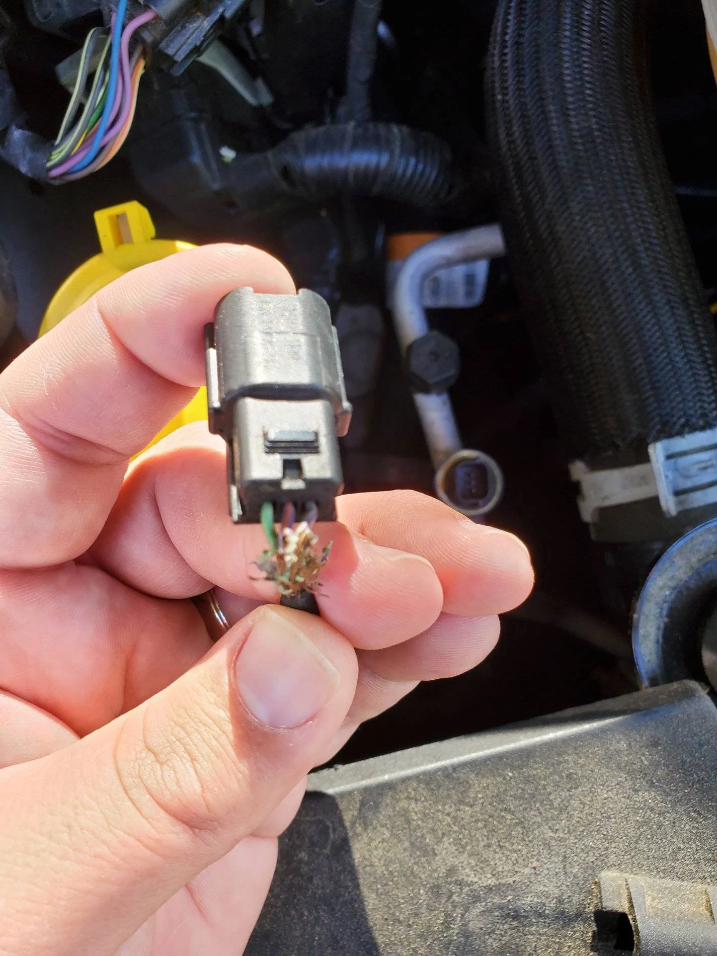

Just to put this out there. The problem was found. The A/C sensor plug was worn/chewed through causing a short. See pic below.

So an A/C sensor was causing all the other faults, including limp mode??? Damn; that makes no sense. But good to know that could happen. Now take care of your rodent issues :devil: .

Yeah, I didn't think this would be the cause of all the faults since it was for A/C pressure but I guess so. I actually found another post here from a while ago that had this same plug causing throttle position sensor faults (wire was rubbed through).
FatBillyBob - I ended up just purchasing the plug head and splicing it in so I'm all set, but thank you.
