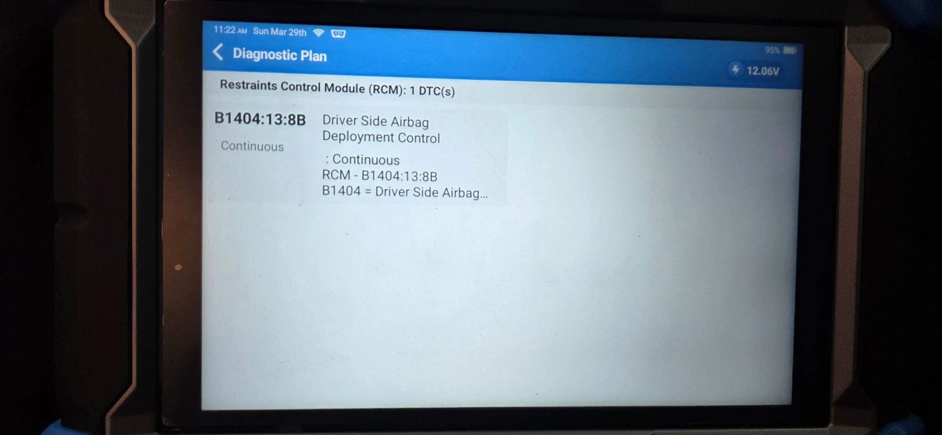

I have been chasing an intermittent and now constant lit airbag light. The code associated with the light is B1404:13:8B (Driver side airbag deployment control). I have a 2021 mustang GT premium with heated and cooled seats. I have read that it could be a broken wire under the driver's seat. I removed the seat and could not find anything out of the ordinary with any plug or wire. Also checked for any software updates and all modules are up to date. My battery is new and the BMS was reset so I know it's not a voltage issue. Has anyone had this light come on before? I'm hoping to be able to find it myself without the dealership tearing my car apart looking for the problem.

Yes, all of my buttons are working. Im almost certain its a wiring issue under drivers seat. If I move the seat around the light comes and goes. I had the light go out and cleared the DTC with FDRS and it stayed out untill I moved the seat. I disabled easy entry exit seating and as soon as I adjusted the seat the light came on. Im scratching my head because I checked all the plugs and wires. All the pins in the connectors are also fine.

Okay thank you Brother. I sprayed duster into driver's side seat buckle and the light shut off as I was spraying it. I cleared stored code and all seems to be well. Key cycled a bunch and a few rides and no airbag light. Never in a million years would that have been where I thought to check. I'm relieved that I didn't have to go to the dealer for this problem. Another win for this forum. Thanks for everyone that contributed.
