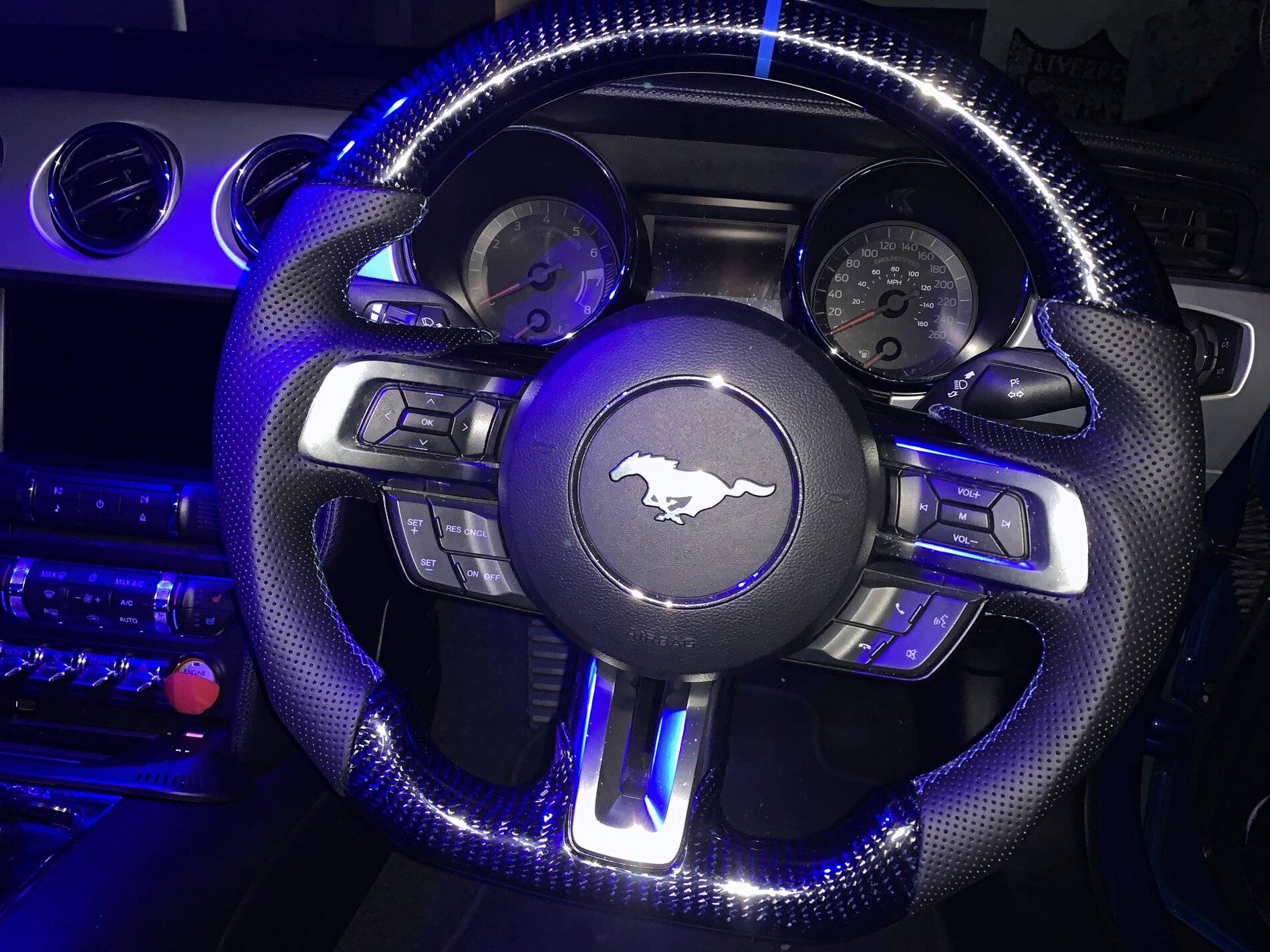

I have the blue one. It fits perfectly. I'd say Royal Steering wheels are higher quality, but I got this so I could put the car back to standard if I ever wanted to.
It's easy to swap over the hardware between the two, the ford screws are like chocolate though so go gently.

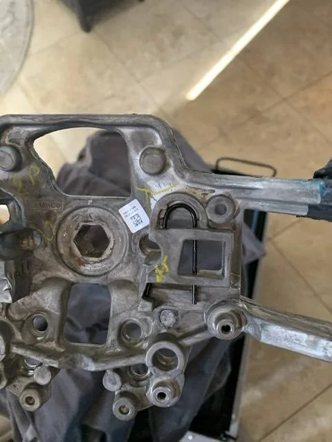

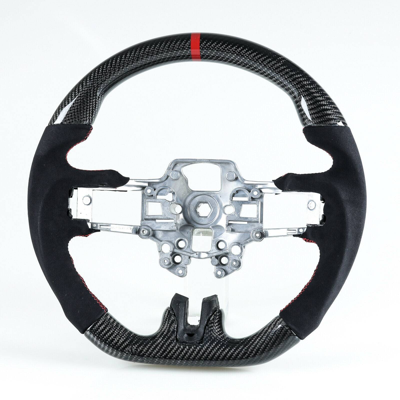

I have one but I got it through dynaperformance. I didnt want to chance having any flaws/fit issues that I would be reminded of daily. Everything transferred fine.
I don’t see the little black airbag clips that you see here in my OE wheel. They came preinstalled in the new one. Since they hold your airbag on, I would double check because they would not be easy to remove while keeping their rigidity to hold the bag on.

Noted. I noticed that too and just assumed I’d need to remove the pins from the original to the new one but is that not possible?

At first glance I though not but it comes out, you just really have to pinch it together to slide out the bottom. By doing so, it might not be as tight a fit going on the new one. I’m sure you’ll be fine, just a heads up.
Regardless, you will not be disappointed with the look and feel.
If I could redo it, I would’ve had a plan to dip or wrap the aluminum bits of the wheel before putting it back on. They just don’t go well with the Carbon imo.

Those pins are not supposed to be removed. They are pushed inwards to remove the steering wheel.
