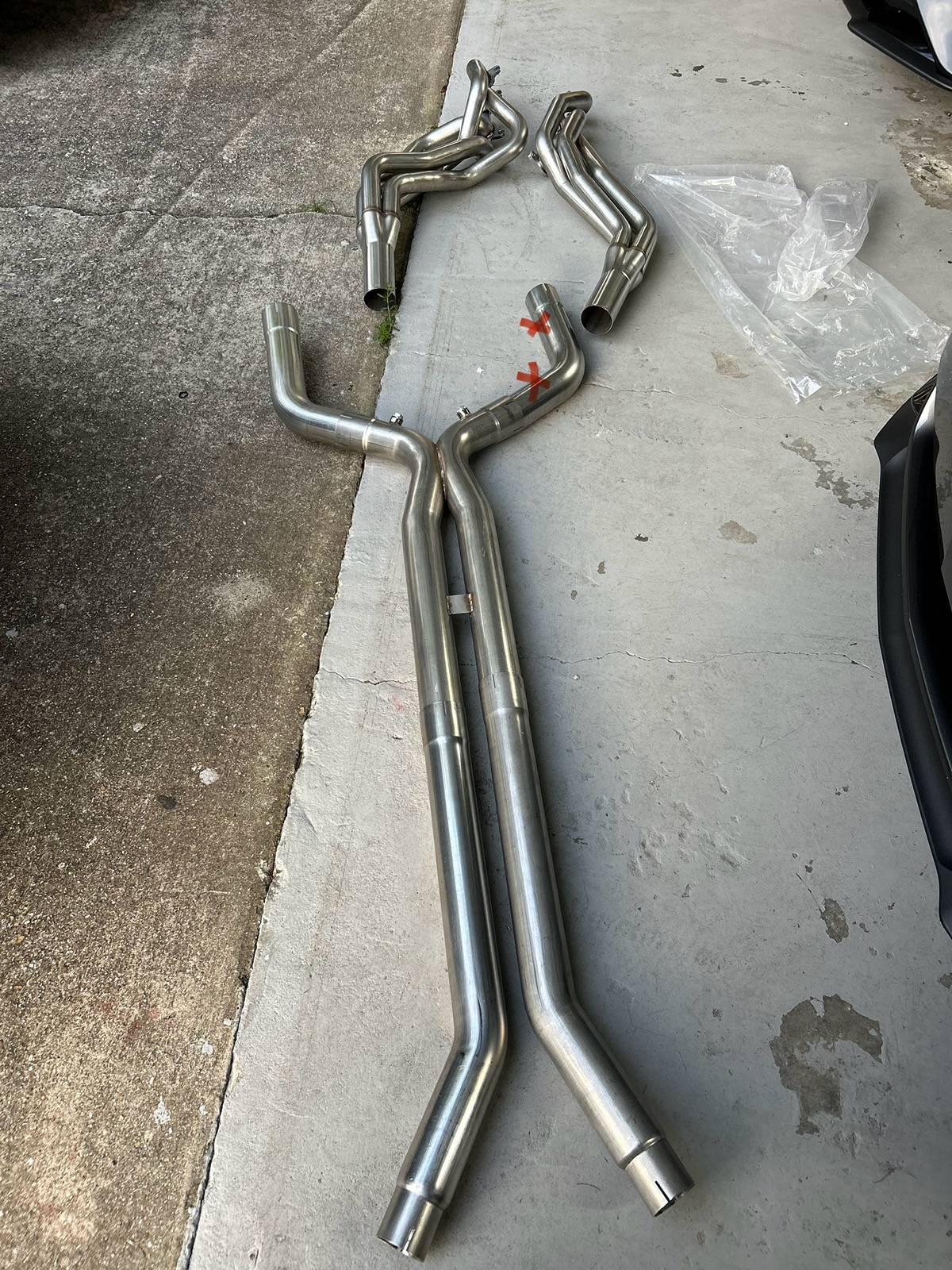

Hello everyone so I just put catless longtube headers on my 2017 GT PP1 and driving it back home I glanced through the gauge screen and notice my af reading was stuck at 14 not sure if that has anything to do with the headers being catless and the car not having a tune yet (tune is ordered waiting on Lund)? I drive the car back home about 100 miles , the car drove fine and didn’t throw a check engine light surprisingly. I’m clueless as to why it wouldn’t be reading the afr correctly.
one more thing , the headers installed on the car are speed engineering and they are hitting on the frame. I wouldn’t buy these ever again. Only reason I picked these up was because I got them brand new for less than half the price of what they cost new on FB marketplace lol but I wouldn’t ever recommend them to anyone , just spend the extra $$ on some stainless works or Texas speed headers.
