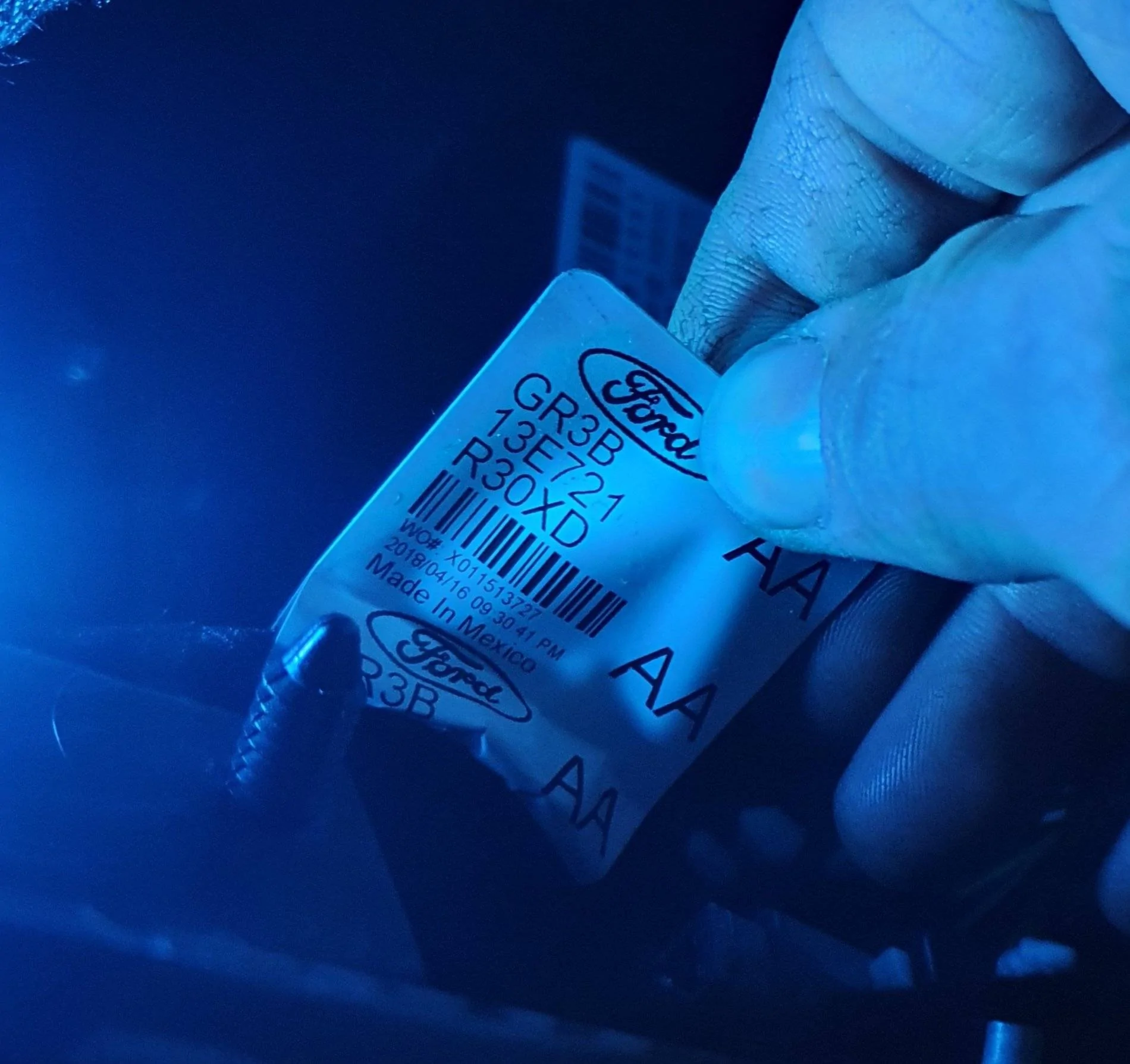

Strange how you folks have a different harness code to me...

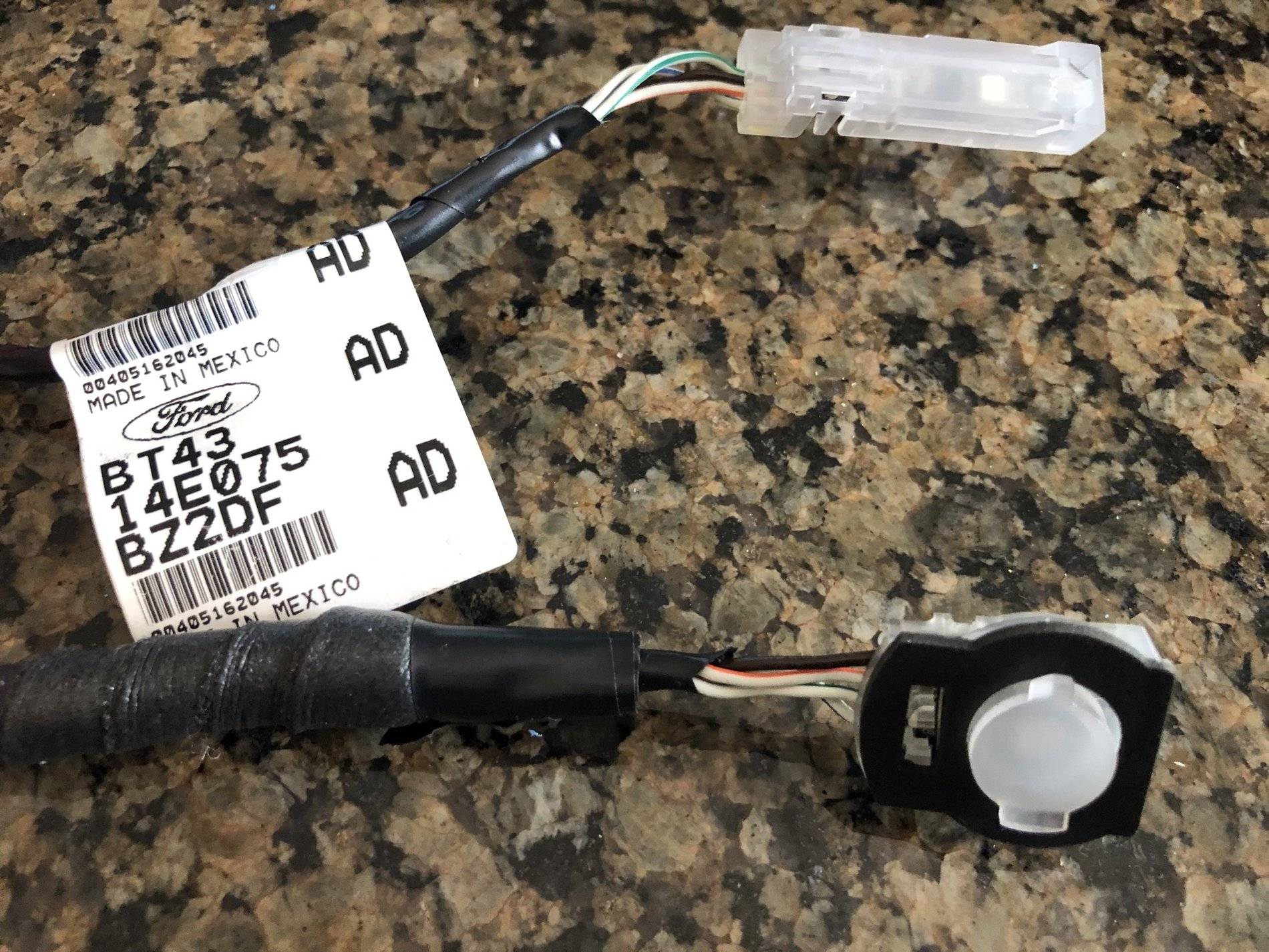

I bought the ones that goes to a Ford edge because it comes with two LED lights on each harness. The plan is to take one light and install in the storage compartment and the other from that harness and install it under the seat or somewhere else I want more mycolor lights. It was a better bang for your buck getting this harness.

Thank you friend. I'll search for your part number instead.

What would I look under on Ford part sites to find the footwell lights? I plan to try and find them used or from a junkyard, but I'd like an idea of what they classify under. Any part number I use comes up blank. As a slight aside, I'm also trying to figure out where they run to inside the vehicle, anyone know where they plug into?
Edit: Answered the second half myself, the socket is on the passenger side footwell and it looks like the harness goes to the driver side from there, couldn't find the connector on the driver side however, though it's a lot more cramped on that side to find anything.

If anyone is looking for the OEM foot well lights or door handle lights, the part is #14A318X (X being A-E for the specific part) for everything but the passenger foot well light. The passenger side foot well light is #14A411, and they list two separate lights, one less interior group, one w/ interior group. No idea what the difference means there, but I ordered one with the interior group.
