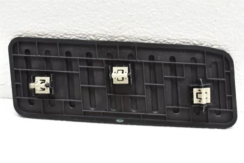

Hey guys,
Been stuck in the house for 3 days now because cold in Texas.
My ACC dead pedal cover was delivered yesterday and I'm itching to do SOMETHING today.
But not outside under my carport in 29°.
I'd read somewhere that the dead pedal just snaps out.
It's an 2018+ GT.
Anyone know how to just "snap it" out, without effing something up?
Looked on YouTube and Zippo.
Thanks in advance 👍

Just pull on it. It has trim clips like all the various dash panels, etc.
I just replaced my pedals. For the dead pedal, I decided to just buy a spare cover (FR3B-6312020-ACW) and drill into the spare which I can then snap on.

That's awesome.
Thanks!
