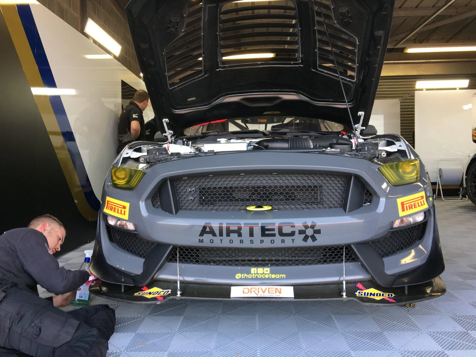

Well, yesterdasy I went to Donington Park to see the British GT cars on their press day. This year we get GT4 Mustangs from Multimatic!!
I was able to get up close and personal.. this made me very happy indeed...
Sorry for getting in the way in the first pic.. but I just had to!!
