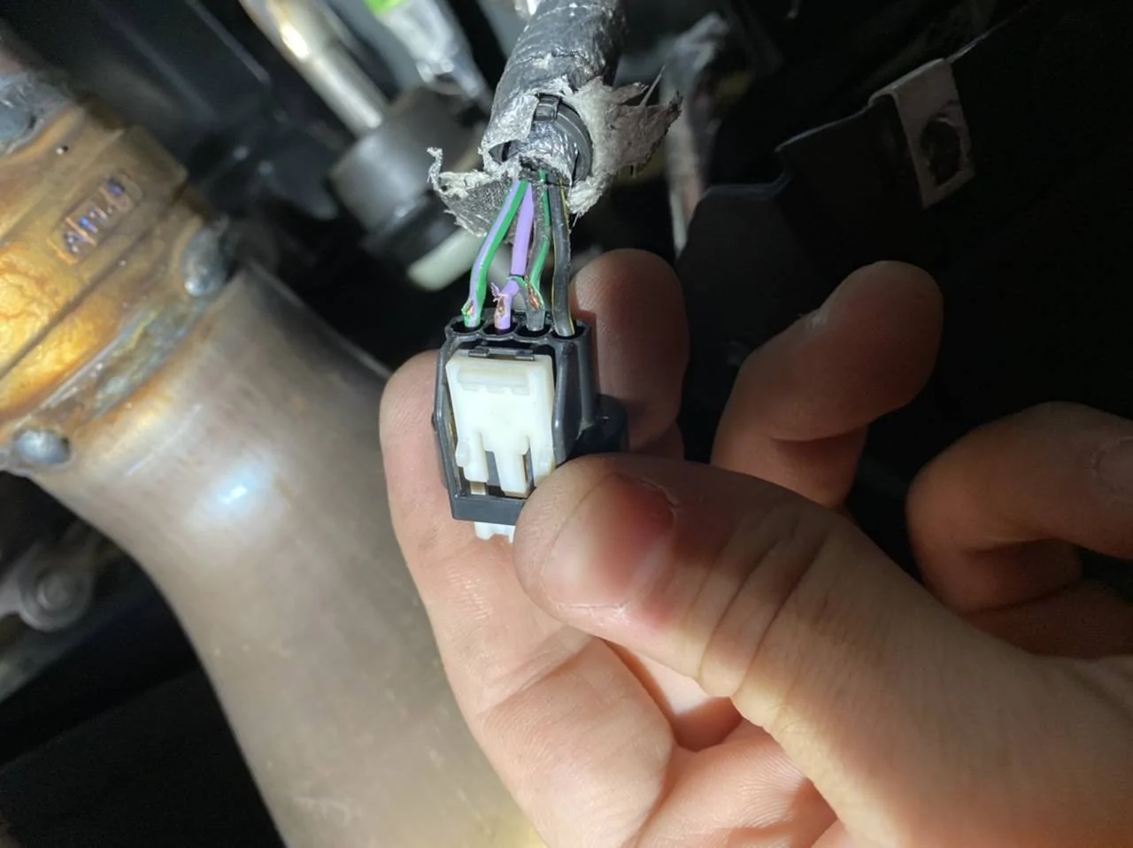

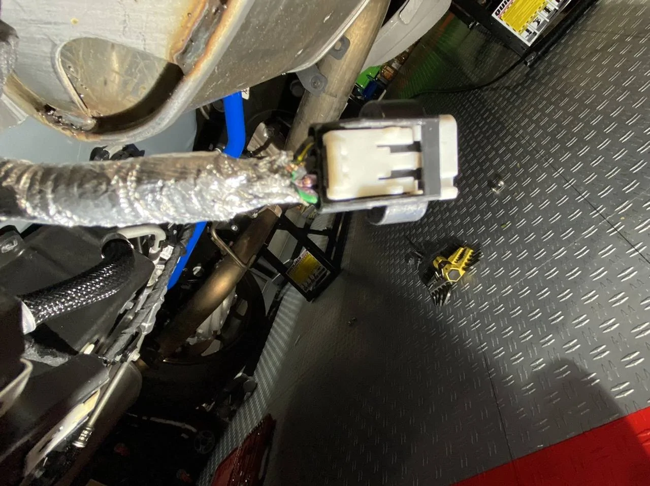

Update:
Warranty repair today.
They replaced the actuator once. Tested, had the error.
they put in another actuator.
tested fine.
I picked it up, drove it, it was fine for awhile and then got the error again.
pulled it apart tonight and found this.
3 of the 4 wires in the actuator connector on the passenger side had wires exposed. Looks like it was probably pushed against the pinch weld from the factory.
Looks like a harness replacement is in order.

That is what I was getting at earlier in the thread. My harnesses were tight, with no strain relief, and too close to either the exhaust or to edges that could chafe or cut. I yanked some of the pushpins, rerouted and ziptied it for better clearance all around. Glad you found the issue.

It depends on how much slack you have. The pins can be removed from the connector and the wire can be trimmed back to where insulation damage isn't present and new pins crimped on. Another option is remove the pins from the connector and slide some very small heat shrink tubing over each conductor.
I dont know if I'd want to replace the harness. Ill look at the manual and see how detailed that harness is.
This is on my list of things to do when I get my car back.
