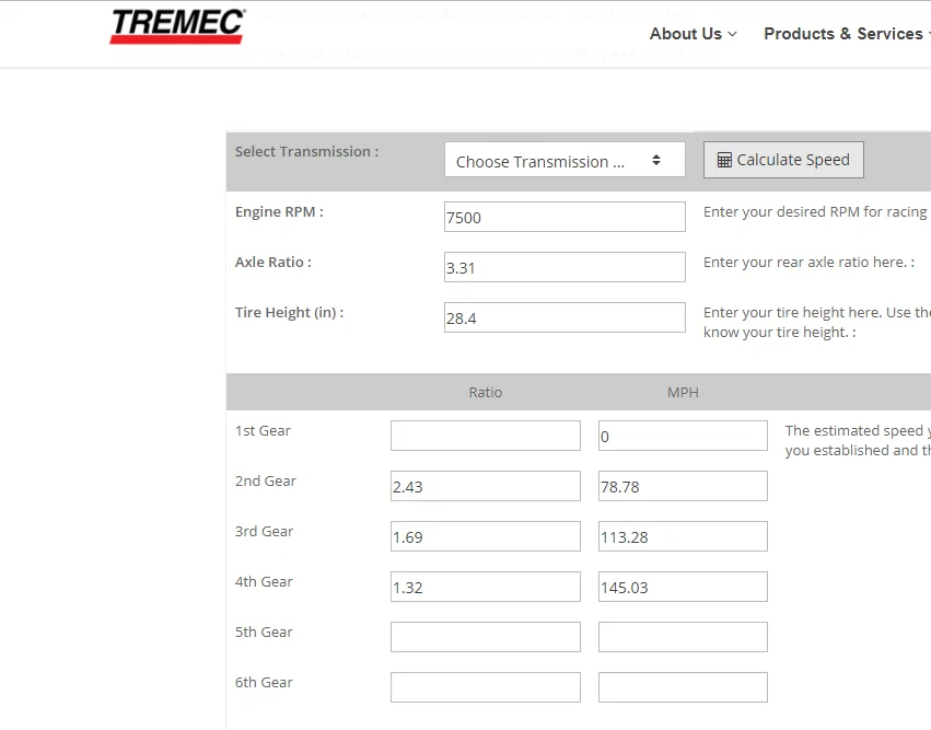

The thing to do is figure out what speed you race to and back into the gear ratio that way. You can see here I'm good to about 145 mph in 4th which is probably faster than I'll ever race to, so a little more gear wouldn't hurt. Conversely I wouldn't want to go too steep and need 5th.
Yeah most people like 60-140 rolls, so I’d like to avoid 5th like you mentioned. Only thing is, wouldn’t I have to potentially start in a lower gear now because of the rpm drop from the lower gears anyways ?

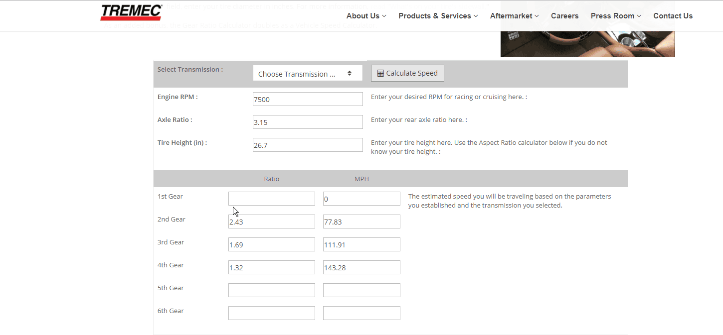

This would be a nice setup, you could start in 3rd and make 140 in 4th. Assumes 325/3019
