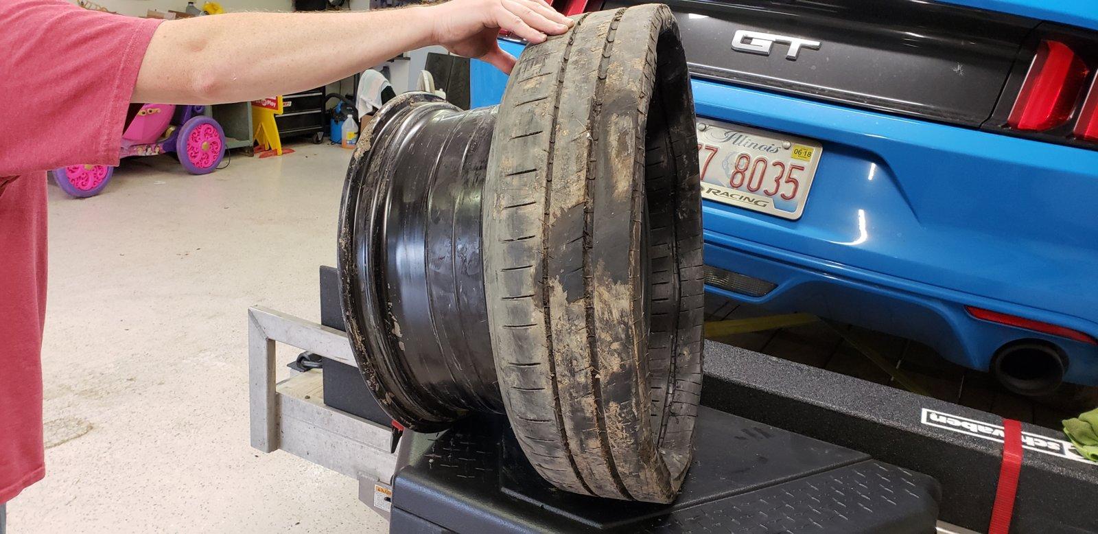

This is very good reference! Needs to be a sticky.
Last summer I ran into a new situation after doing this for 15 years, as an amateur. I had a newish tire go down while on the track. I check pressure all day and torque lug nuts every session. The tire went down while on track and I had the first wreck of my entire driving career, on or off track. They were MPSS2s with 2 track days on them, on 6GR wheels. Have not yet determined how the tire rolled off the rim.
Here are my lessons from the incident to date
1. If car is equipped with tire pressure monitoring, bring it up on display if possible before going on track.
2. On the first couple laps test the tires left and right
3. Always check your distance to other participants, especially when entering braking zones
4. When studying corners also study the best run off zone, make a plan a, b and c for leaving the track
I know there is more to learn from this incident, and while,putting my ride back together I am definetly paying close attention to tire and wheel selection.
I have never been a participant who likes to hang out in others mirrors and force a wave by so I usually have plenty of space to work. In this incident I was coming off a very long straight away, and I had let the car run to its full potential. Unfortunately this put me into a position where I had caught up to a slower moving car that was still in the corner. When I let off the gas and hit the brakes the car caught me by surprise, and took the wheel out of my hand for a bit. I was able to counter steer, but my trajectory was pretty much chosen, as I had lost a front tire. I got the car pretty much slowed down before the corner. I unfortunately still bumped into the slower guy. We slid gently off track.
Things I did as reaction, not sure if they were right or wrong.
1. Kept the Brakes hammered down as I felt this was my best chance to reduce speed quickly
2. Counter steered the wheel when it yanked in one direction
3. Tried to steer the car off course as I wanted to avoid other participants (this did not really work, but I did try)
To be clear I was not aware this was a tire failure until the corner worker told me what he saw. I thought my car broke or I did somehing horribly wrong, that I had never done before.
I actually used the advice from the last bit of the drivers meeting that I had heard for so many years. Stayed in my car with safety gear on and belts buckled as it is still a live track. The other participant did not and it worried me, but we all ended up safe. Of course he was a bit upset, I would be too.
(After reading my post, it may be a distraction to the really good information above. If the the OP or mods would like me to delete it, I will be happy to do so. My intention is to add to the good content, not detract)

Sidewalls do wear and give out. This happens on tighter technical courses and autocross usually, but it is most definitely a thing. Someone with less experience would be advised to run more pressure, in order to keep from accidently damaging their vehicle, while learning. We are not looking for fast times here, just fun high performance driving
