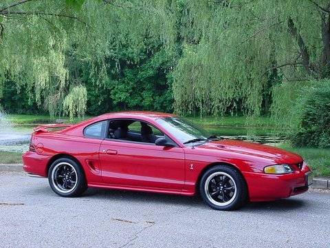

LOL... surely the SN95 (and prior Mustang generations) are inferior to the stock S550 suspension characteristics and interior refinements, but of the time the factory suspension was still tolerated for daily driving.
My 94 Cobra still gets plenty of compliments and has won its fair share at car shows over the years. It was also selected as part of a NITTO Tire Ad Campaign years ago - which ran as a centerfold, separate pages within and on back covers of several Mustang magazines. Nitto was kind enough to even send a 24x30 full size poster of the ad too.
Here’s a pic:

I like looking at that car. The 94-98 SVTs are nice looking cars.
I had a 1990 GT vert, 2001 GT, 2003 Cobra Coupe and 2003 Cobra Vert. For a 6'2" long-legged dude I can't believe I put up with them as long as I did. My 5'3" wife did a lot better because the shifter was close to her.
