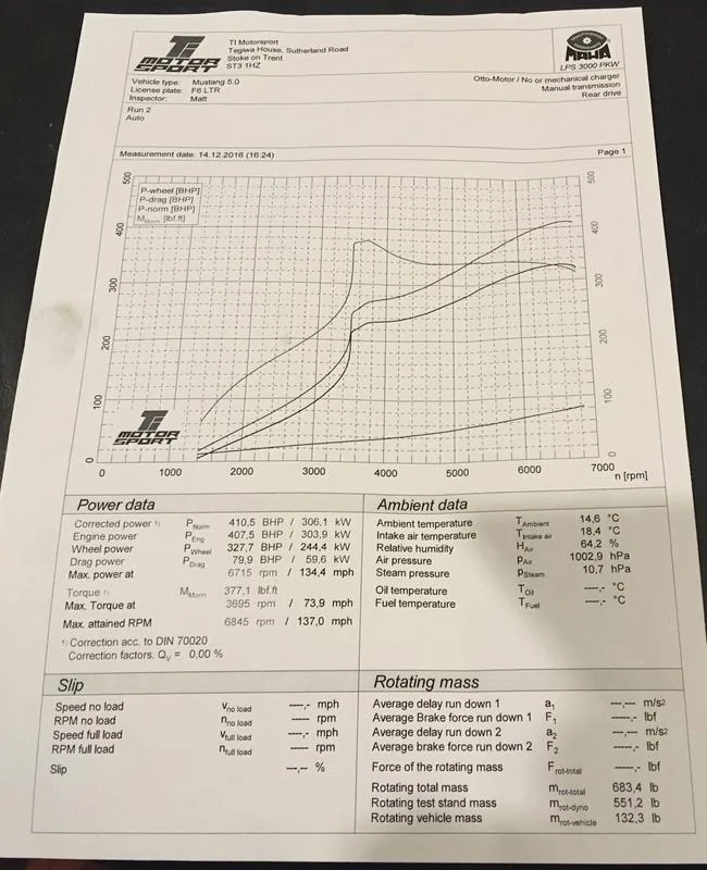

My car on the same dyno stock:)

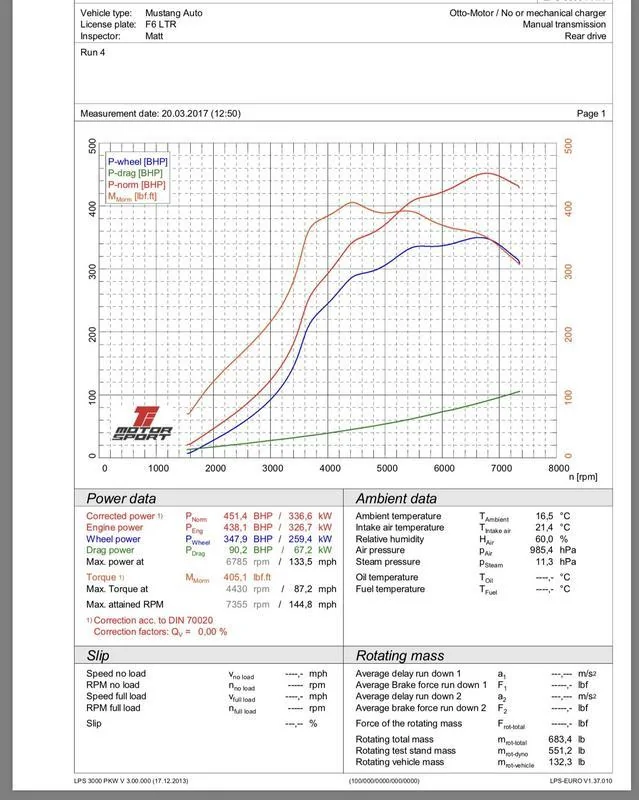

My car on the same dyno with LTH, CAI and Lund tune..:)
Either way I still mullered [MENTION=13598]Gibbo205[/MENTION] at Avon Park BEFORE the tune:lol::headbang::headbang::thumbsup:

in short, LTH+CAI+TUNE = +41bhp/+28lb-ft

Trouble was, it drove like a bag o shite:D:doh:
I wouldn’t go that far. It’s a bit more peeeky when the power arrives but it’s that bad :)
Sill very deiveable and well behaved.

Hang on. Gibbo was quoting 470bhp for the PMAS with Lund tune...?
not a chance on our cars and our lower starting hp.
i'm just under 450 adjusted and lund tuned with filter + exhaust etc.
