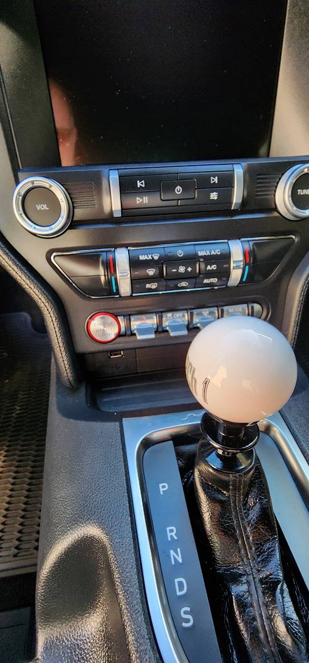

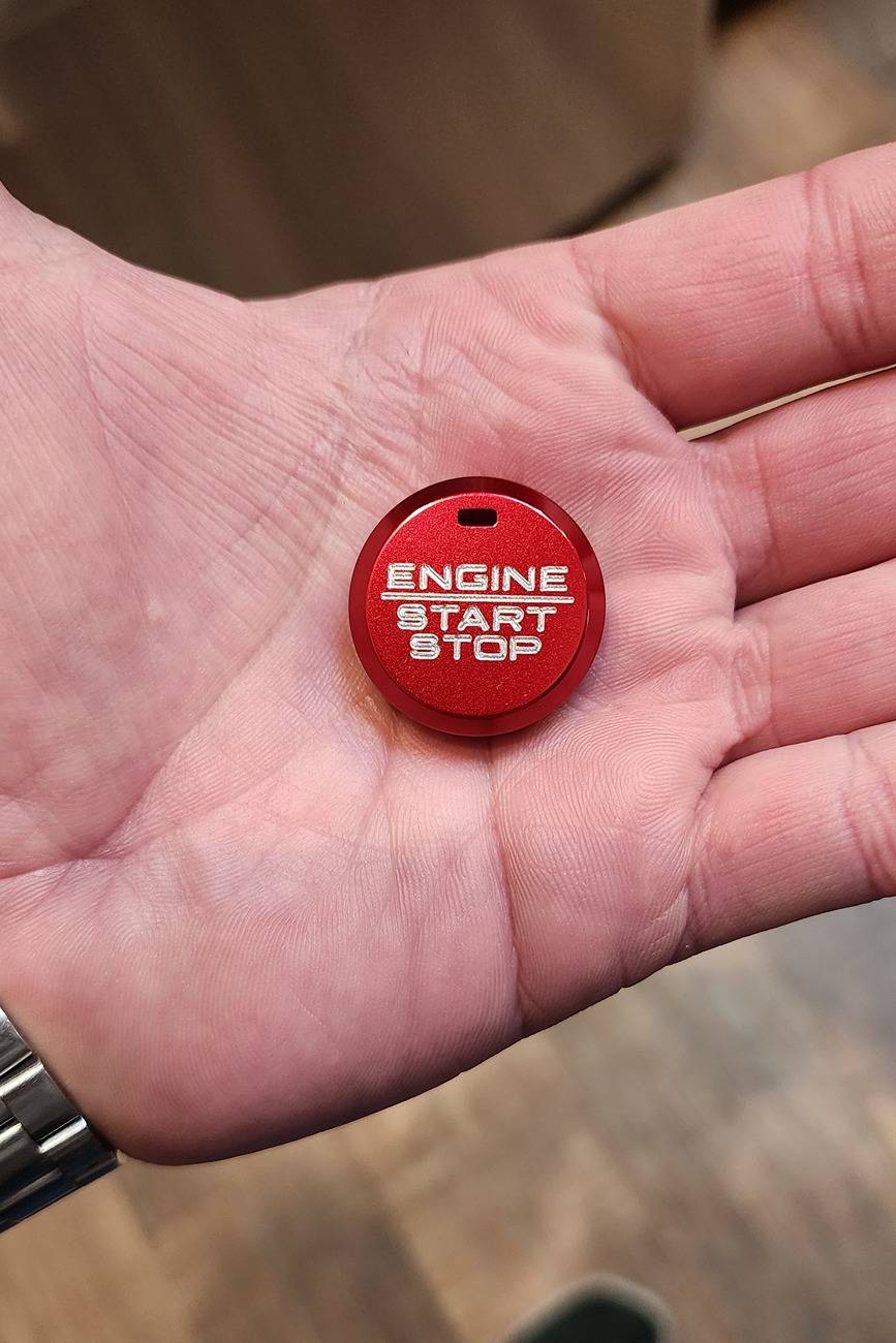

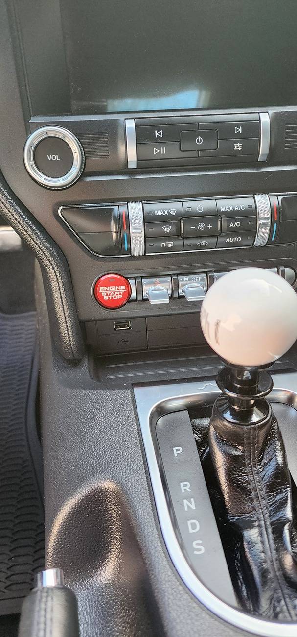

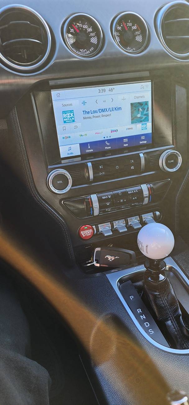

Hey guys

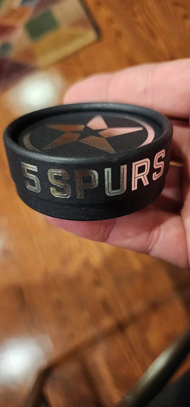

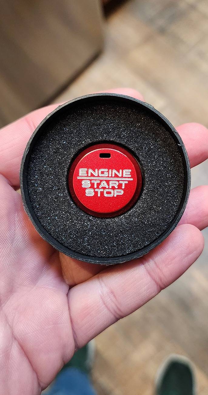

I finally got my 5 SPURS RED start button delivered today, after the USPS clown-show misdelivered and lost my 1st delivery. I am very impressed with 5 spurs and KEVIN. After contacting him about the misdelivery and them/USPS losing the button, He shipped me out another button to make up for the loss. Fantastic customer service, very impressed and I definitely will be ordering more stuff from him the future.

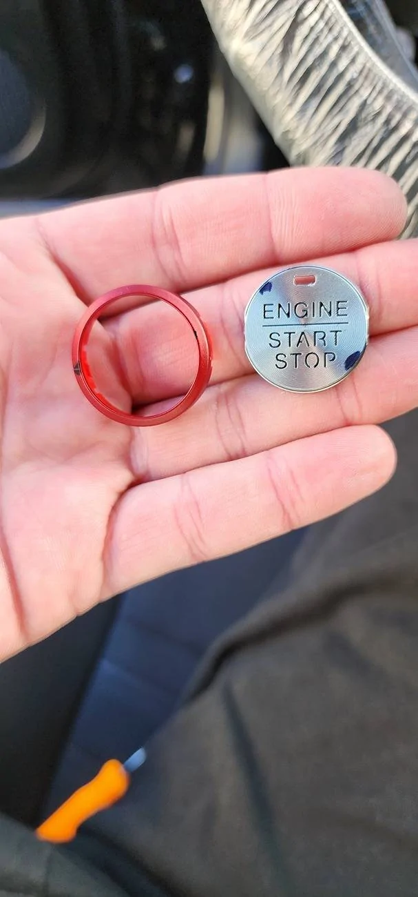

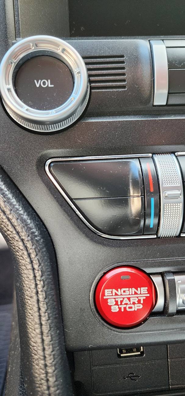

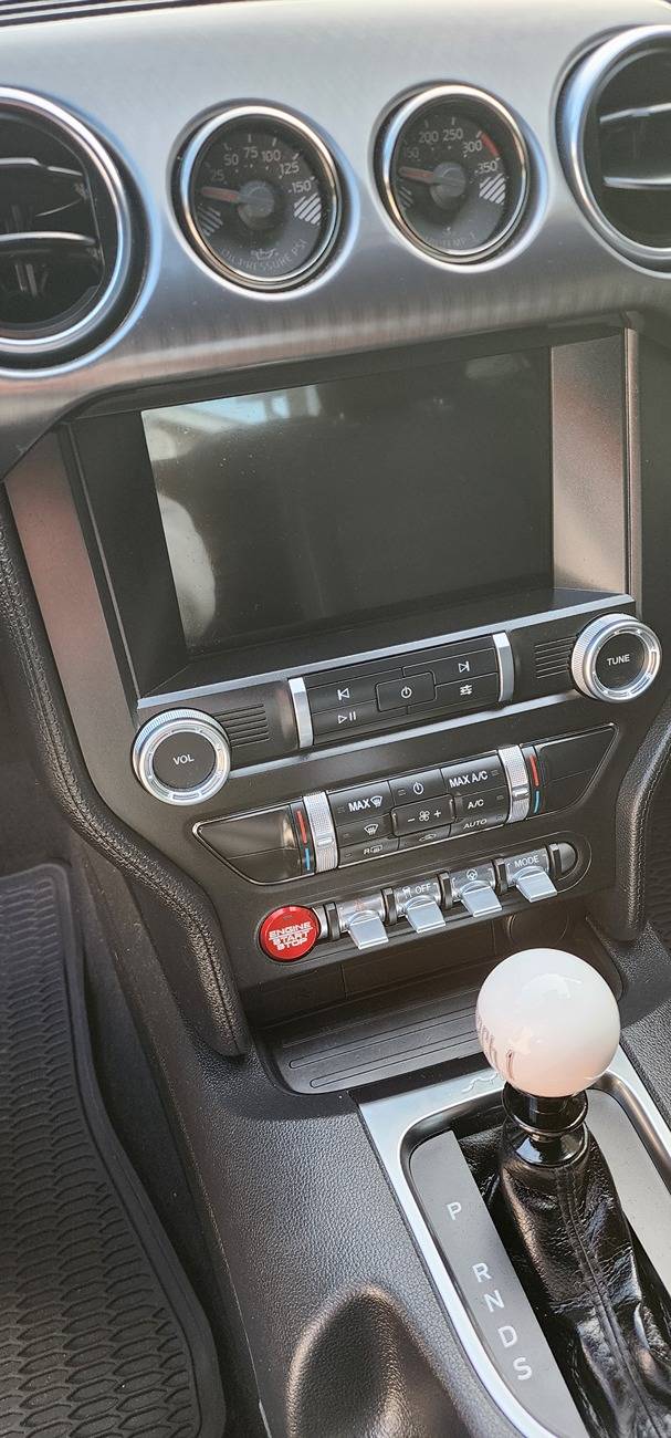

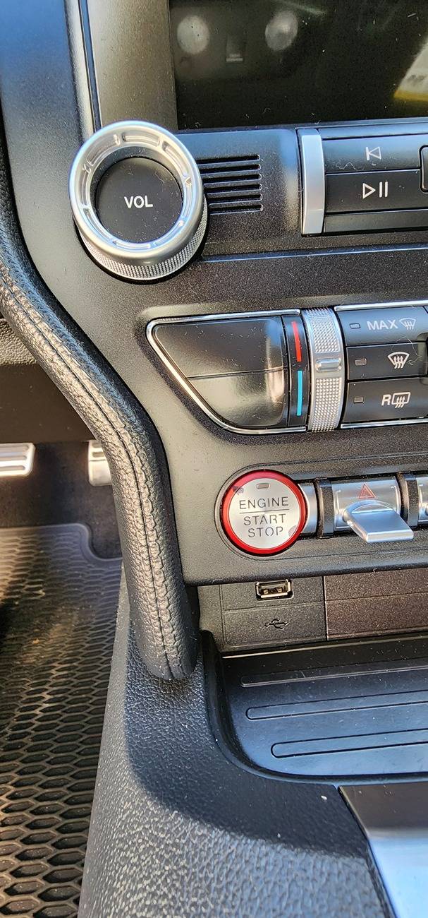

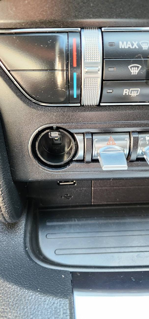

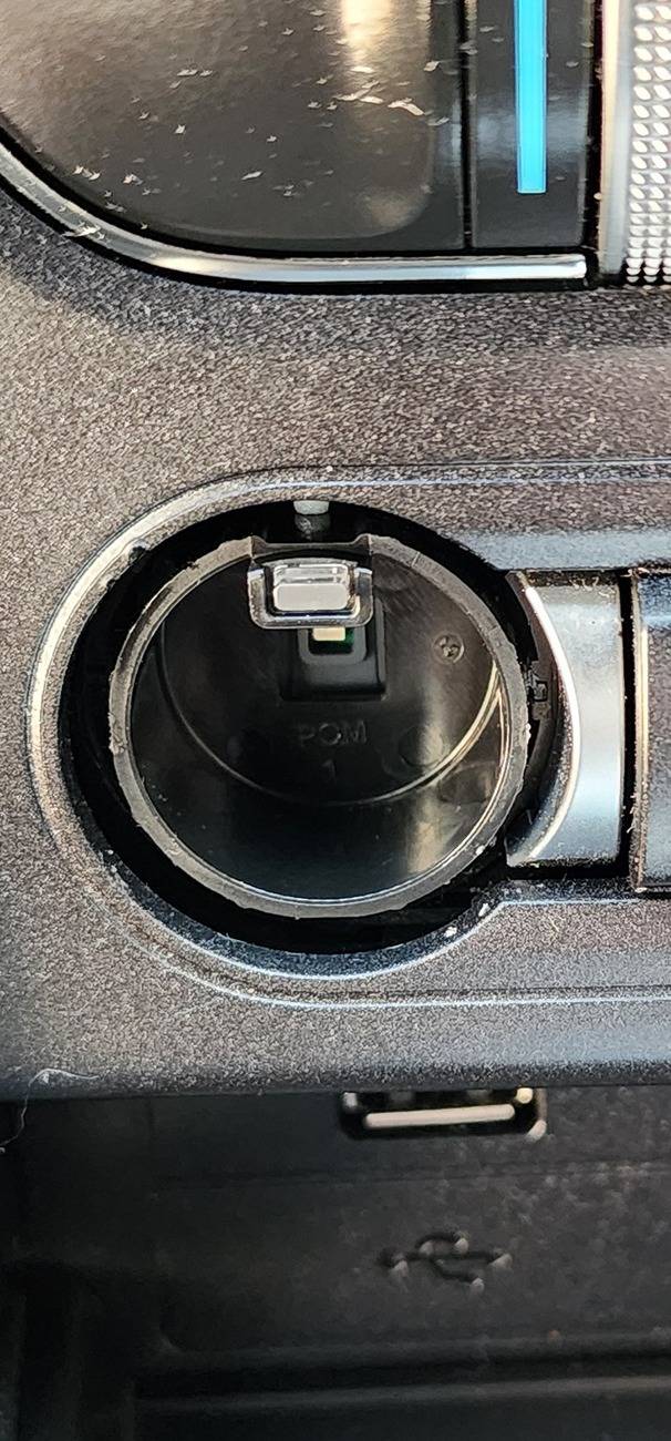

Here are some pics of install, The 5 Spurs button is definitely a quality piece and perfect fit and easy install. The trick to popping off the old button in 1 shot and not damaging the dash is to mark it black marker at (11am & 5pm) clip spots, then push the flasher lever UP, use a small eyeglass straight screwdriver and gently push in clip and pop out. It will separate as the stock button is 2 pieces. Then use a hook pick in the small light hole and gently pull, both parts will pop out, then align and place new button in and pop it in, hearing 2 clicks and DONE!!

Stock button is a 2 piece plastic piece. The 5 spurs 1 piece is aluminum and painted red. The Ford perf gt350 button upgrade is a shiny red plastic piece. Just looks and feels better. It's overall preference.
