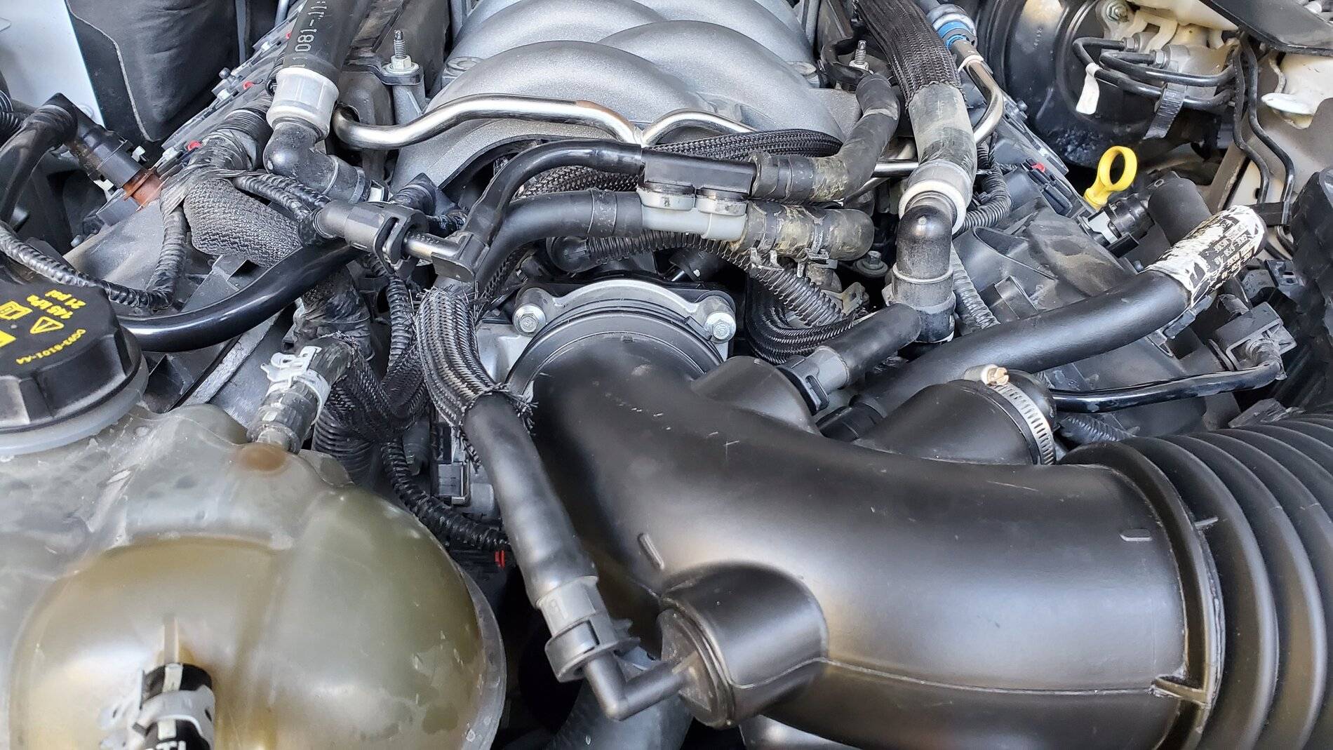

I modded the vac hoses for the 18 mani. Will they work the same when I put back the 15 mani ?

Tough to say. If they've been modified beyond the point of working in their original capacity then you're probably SOL.
Took a while. But I was able to put them back together 🤣
Loaded stock tune and now its good to go
