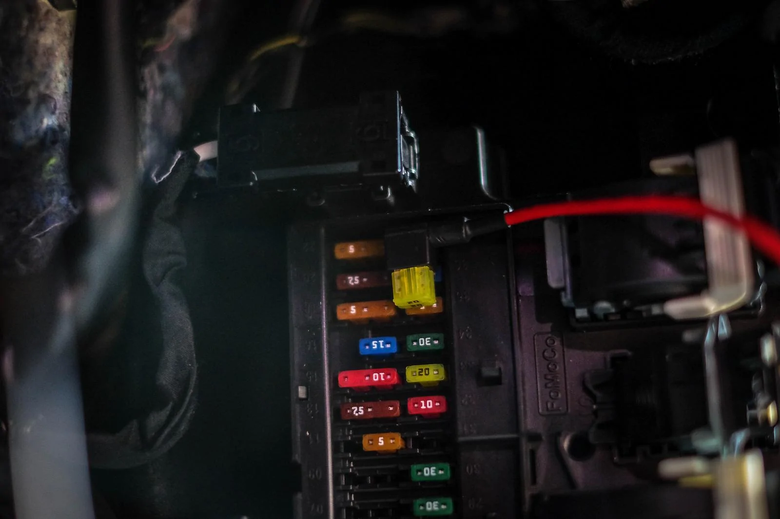

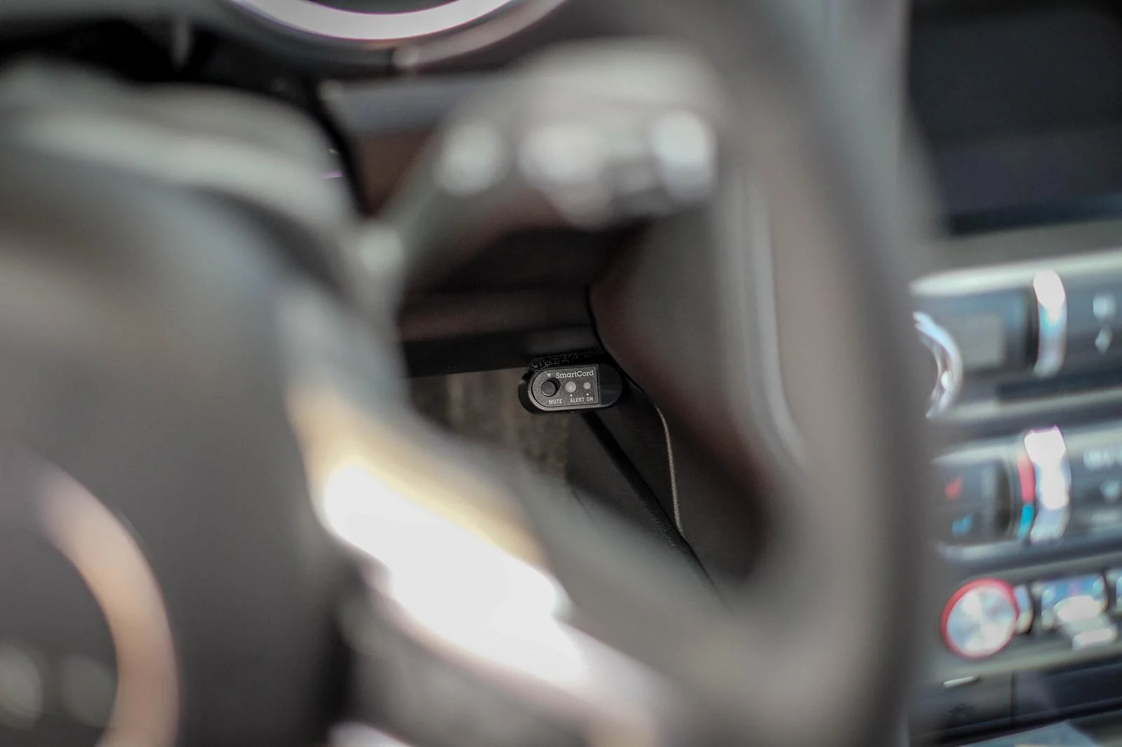

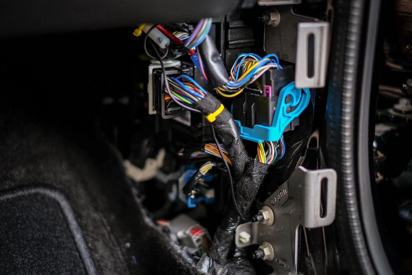

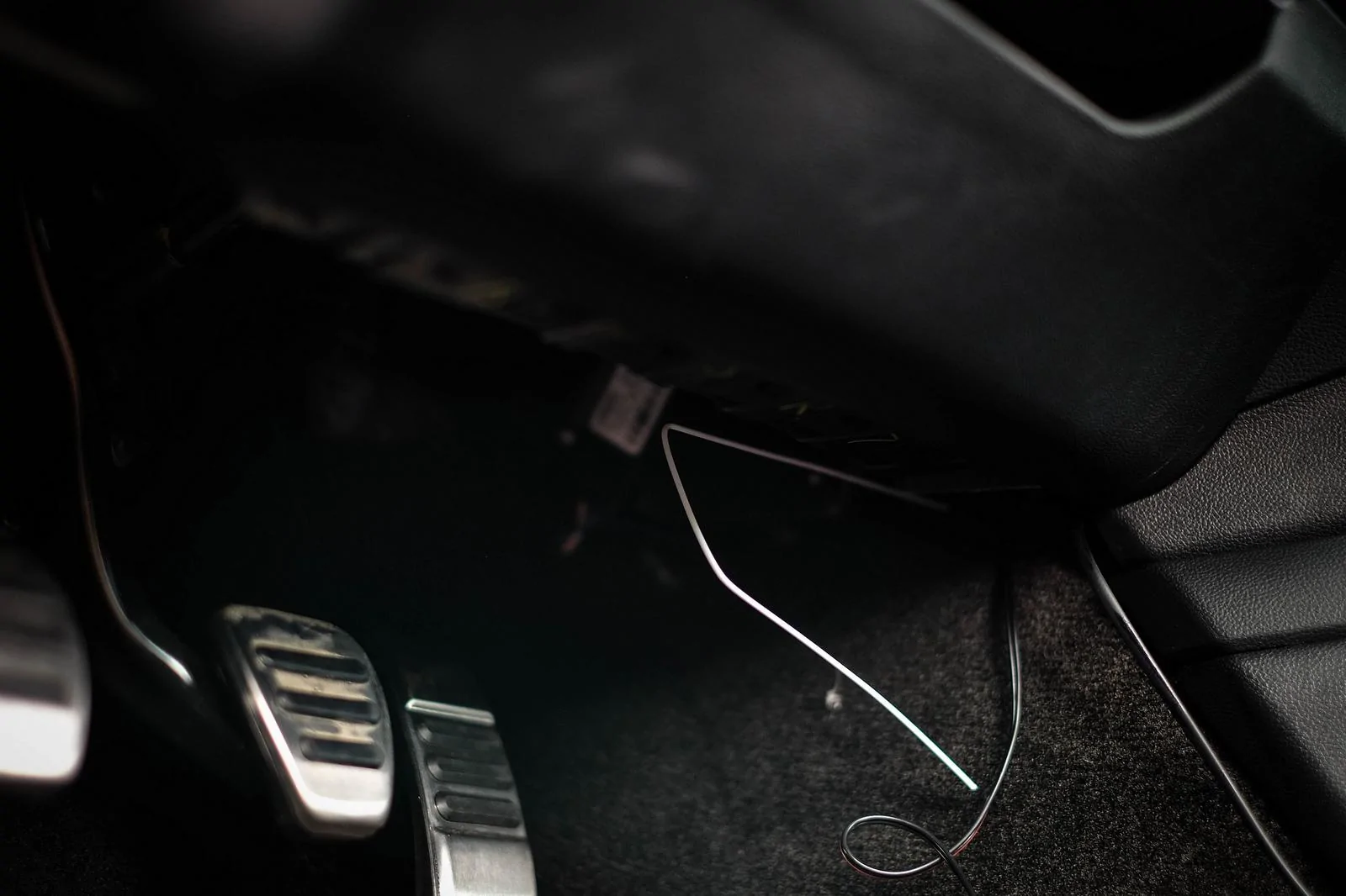

I'm a big fan of clean, hardwired radar installs and, as such, went with an Escort Max 360, Escort SmartCord, and BlendMount. I've included links below to everything needed with a bit of commentary for those interested.
I first decided to mount the SmartCord on the driver's side footwell area so that I have easy access to mute the radar, when needed. To my surprise, the RJ-11 cord (powers the radar) was quite long, but the power cables that tap the fuse box were pretty short. So much so that it jeopardized the positioning of the module versus placing it a bit closer to arm's reach. Arguably, it's easier to reach near the mirror and hit the mute button on the radar versus the SmartCord module. However, since it's relatively cheap, I still like having both options available. I started by taping the cable ends to a coat hanger and fished it across the transmission tunnel behind the radio. It was quite simple when exercising just a bit of patience and finesse.

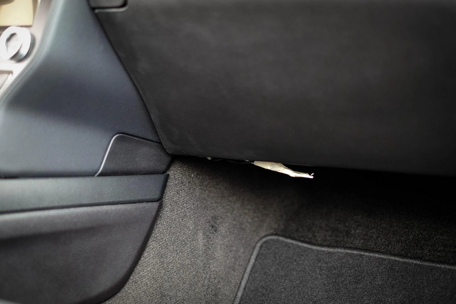

I then used a fuse tap on fuse #37 (heated steering wheel module), which turns on and off with the vehicle (see page 221 of the manual). I also used one of the easily accessible bolts to ground the unit (the first visible bolt on the second picture below).

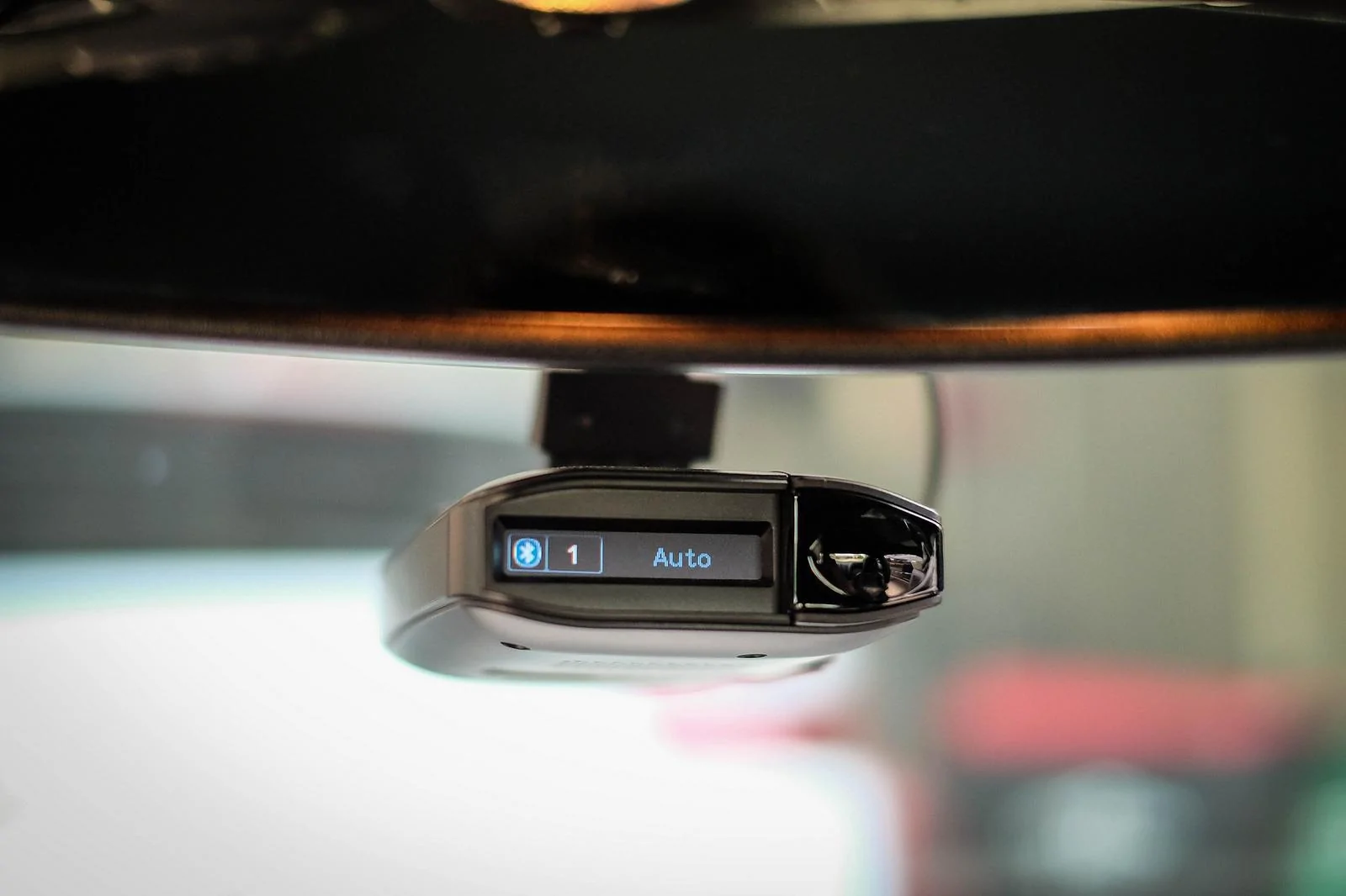

Running the cables up the A-pillar and to the mirror was super easy and required nothing more than a bit of tugging at the panels. I was also able to leverage the plastic tunnel right by the mirror to run the Escort cable inside it along with the OEM mirror harness. Note that I did have to remove the OEM clip on the mirror stem that secures the mirror cable, but no biggie there. As you can see, it turned out quite nicely.

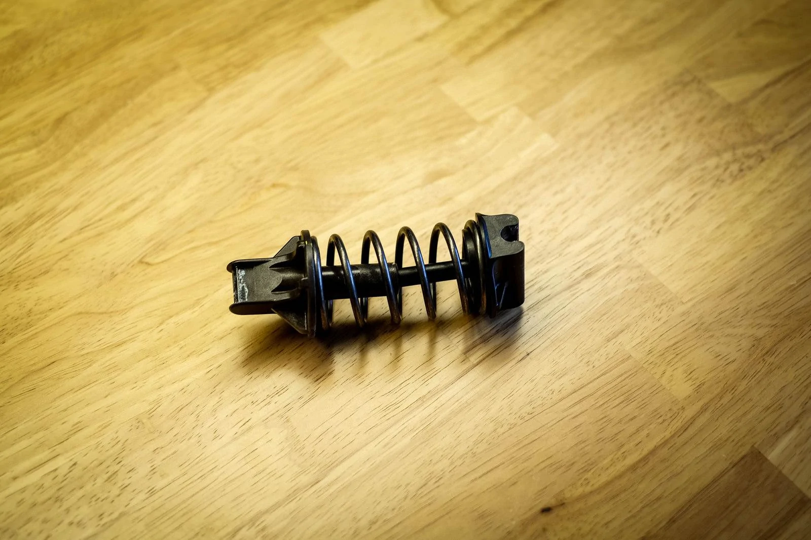

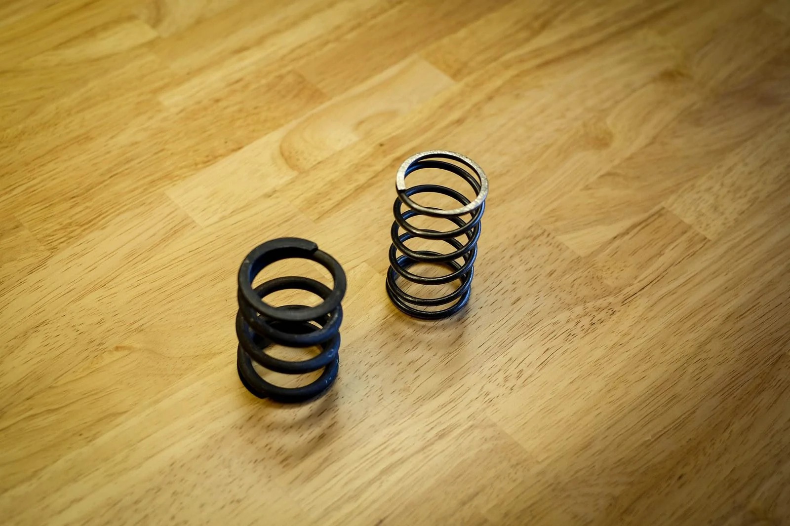

Heeding many people's advice, I purchased and installed @SteedaTech's 35lb clutch spring. What a difference! While the clutch is now a touch heavier, the engagement point is much easier to caress. For instance, when rev matching on the stock spring, the inability to feel the engagement point would mean that you either nailed the downshift (i.e., perfect rev match) or caused a bit of a jarring experience if you don't quite nail the RPM since the OEM spring over assists and encourages you to "dump" the clutch. Now, even if I don't nail the perfect RPM during a downshift, I'm able to slip the clutch just a bit to avoid excessive driveline shock. Obviously, that's not the goal of rev matching, but it certainly helps while learning the car. All in all, a very worthwhile upgrade. Of course, videos of the car on a lift don't show how much of a pain in the ass it will be for most of us doing this in the driveway. It sure was a lot of fun contorting myself in the required position to remove and reinstall the spring. Being 6' 4" and 220 lbs doesn't help matters.
Left: OEM spring, Right: Steeda spring
