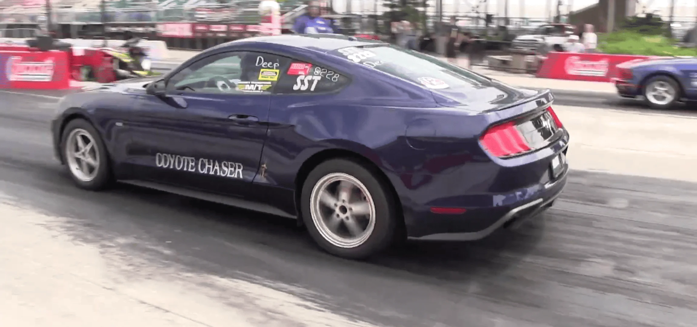

I am running 275/40-17 Drag Radials on 17x10 wheels.
My car is similar to yours, I have the 10R80 transmission and 3.15 rear gear.
The big advantage; the combination of the 26" tall tires and the transmission's 4.70 first gear, makes for a good launch!
The negative; my car looks really stupid.

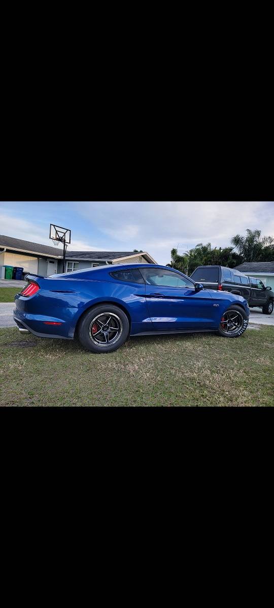

Suspension setup?
Also on vms 17x10 rears... mt street ss 305 45 17
