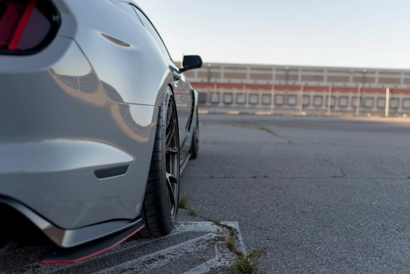

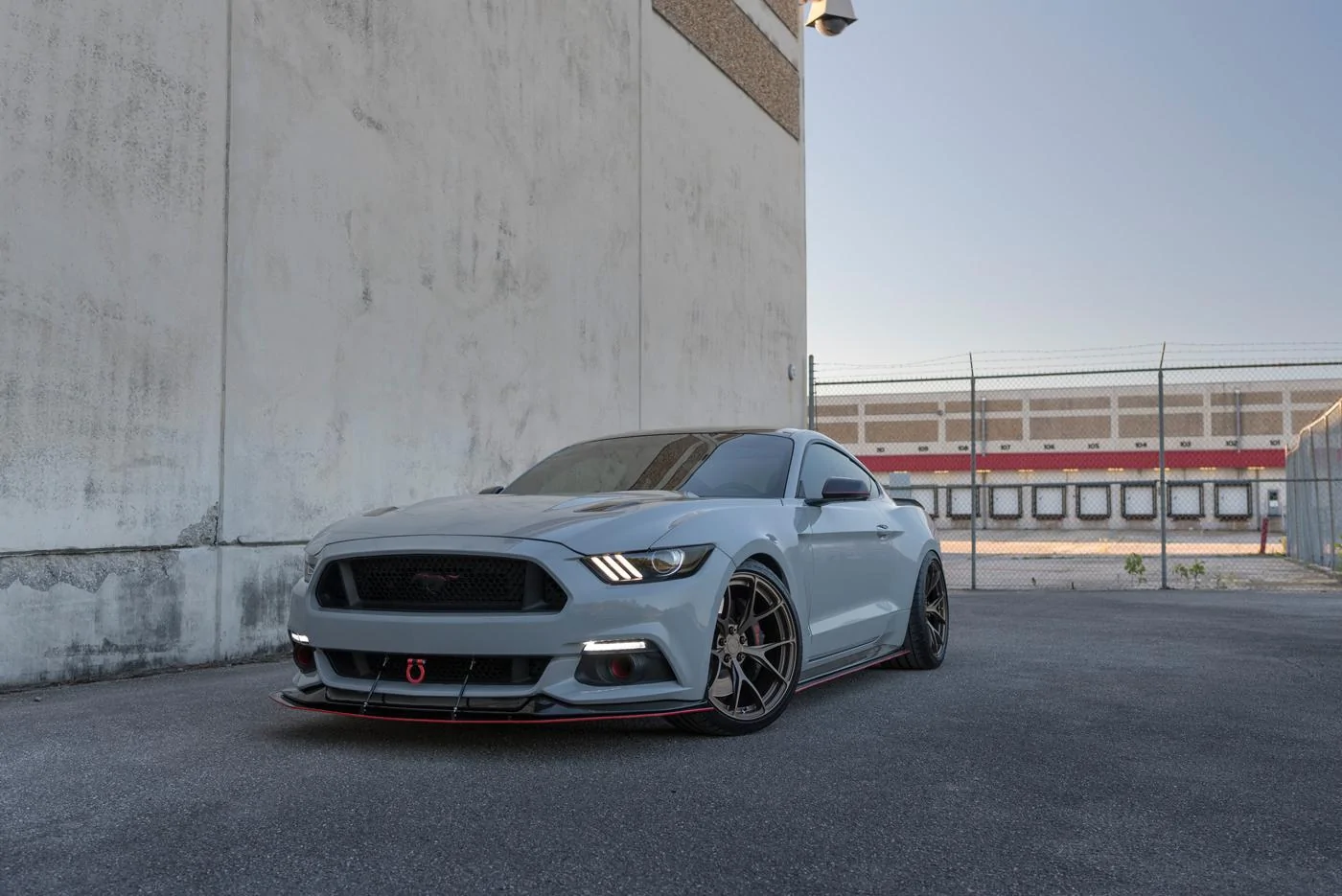

That is so bad ass fitment.yeah whats your alignment, mine is like todds 20x11 +45 rear i'm running 305/30/20 which is less sidewall but if your rubbing on the inner rear. Can you you see what it's rubbing against as we have alot of space inside, people have run 12" rears.

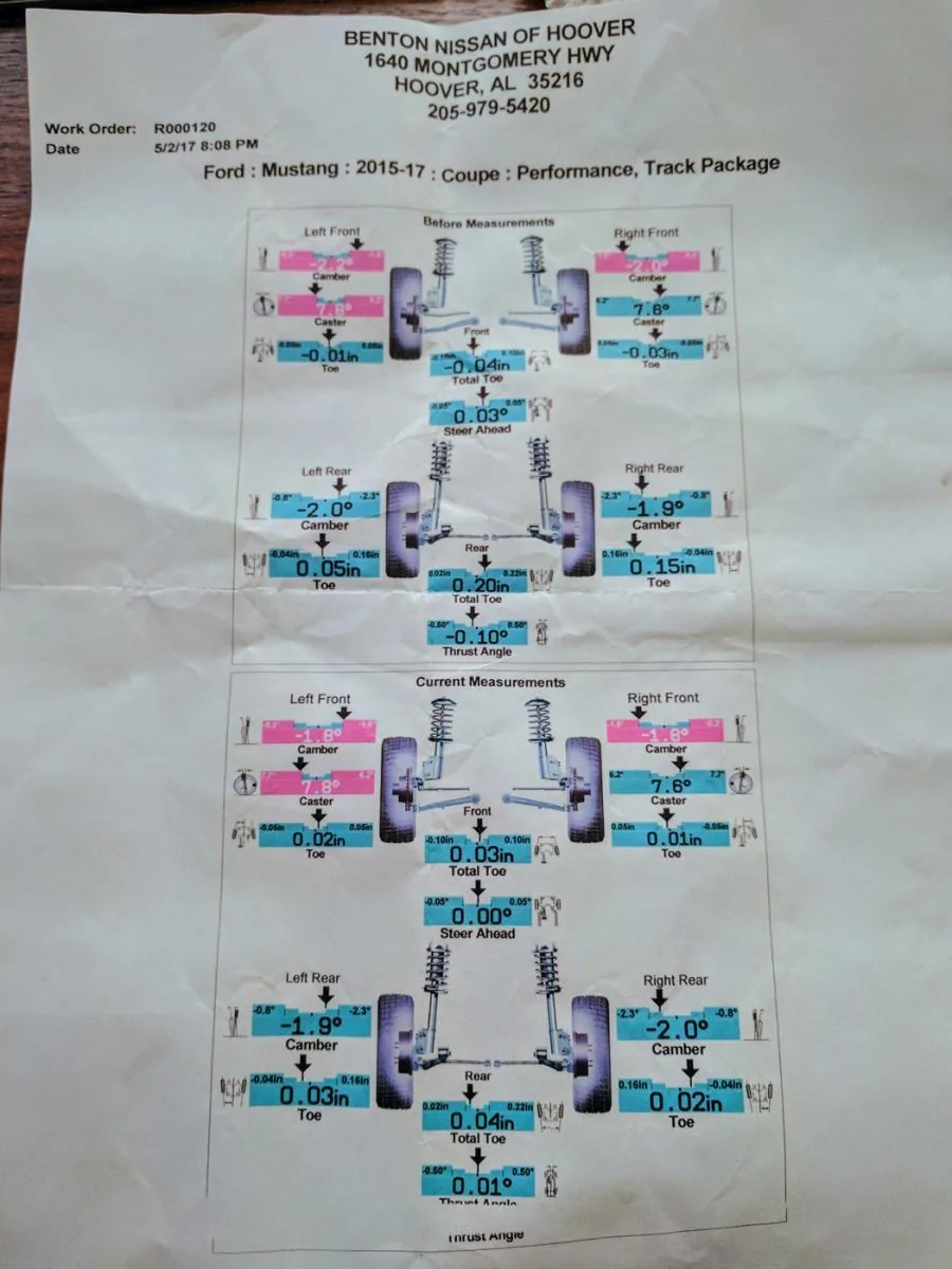

attached is my last alignment ignore the caster its never been in spec and front camber is intentional
Need to get some camber and tuck the top in.I'm rubbing the lip on the outside when I hit a bump or turn.
