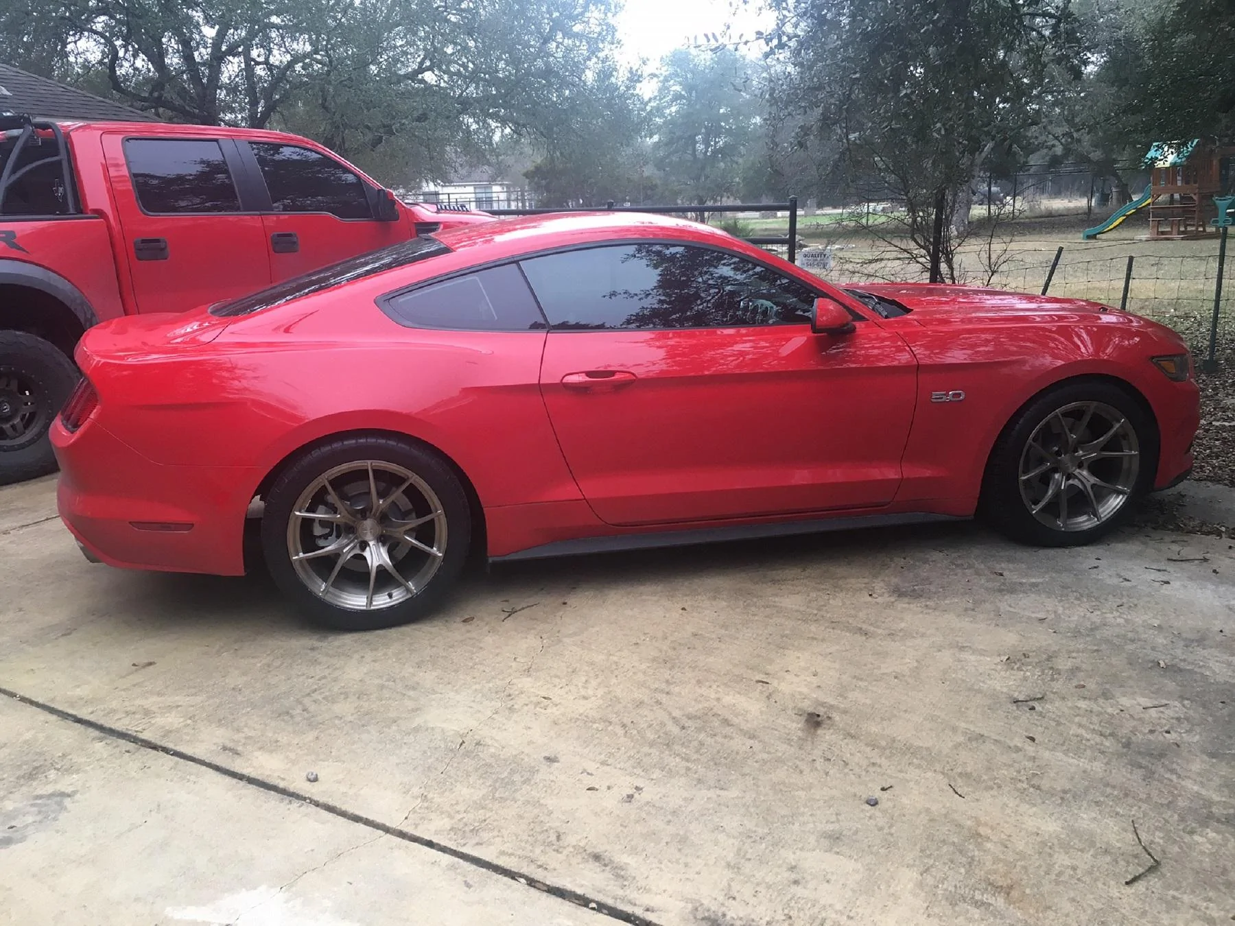

I am running the 285/35 in the front. Changed out the 235/50 so my original height was only 27.3". I have 345/30 on the rear which stayed at the original height and you can tell a bit of a difference so it might be even more noticeable on your setup. I'm on BMR min drop springs if that makes a difference.
I personally don't mind but I know it bothers some people.
