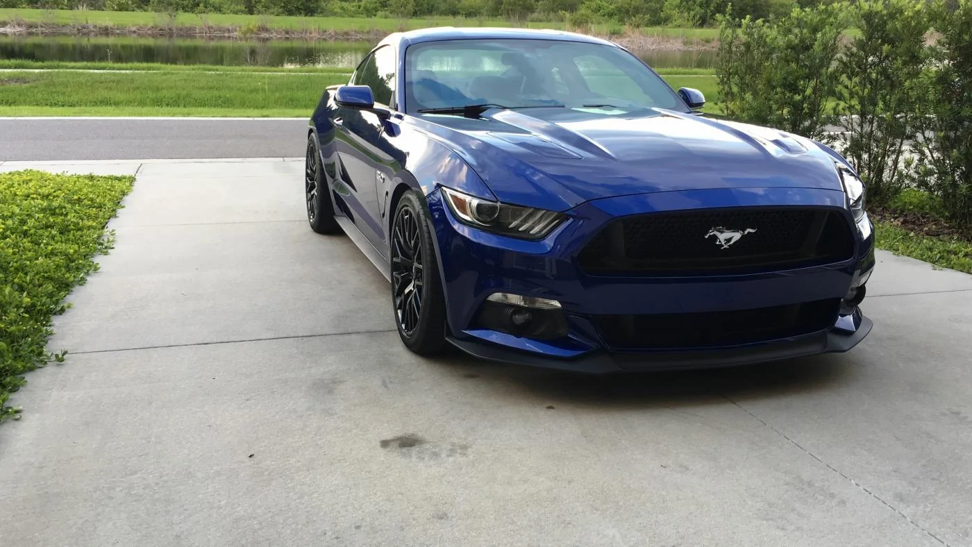

Post up a pic with your staggered spacer setup please.
I went ahead and cut mine last night. Was a pain but not impossible. DONT SIT YOUR KNEE DOWN ON THE HOT CUTOFF PIECES ON THE GROUND :lol:
Heres the fruits of my labor :cheers:
The rear is ever so slightly more tucked in than before, which Im happy about but the fronts are close to being too far in which is why Im debating picking up some 25mm for the front to try out. I took it out on the highway last night when I finished up to check for vibration and try to re-bed these squeaky assed brakes and didnt have any issues so all is well again!

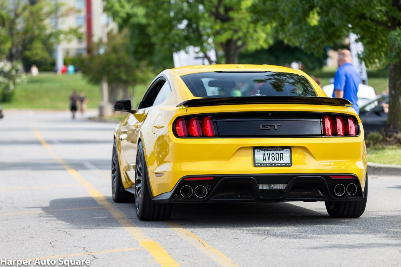

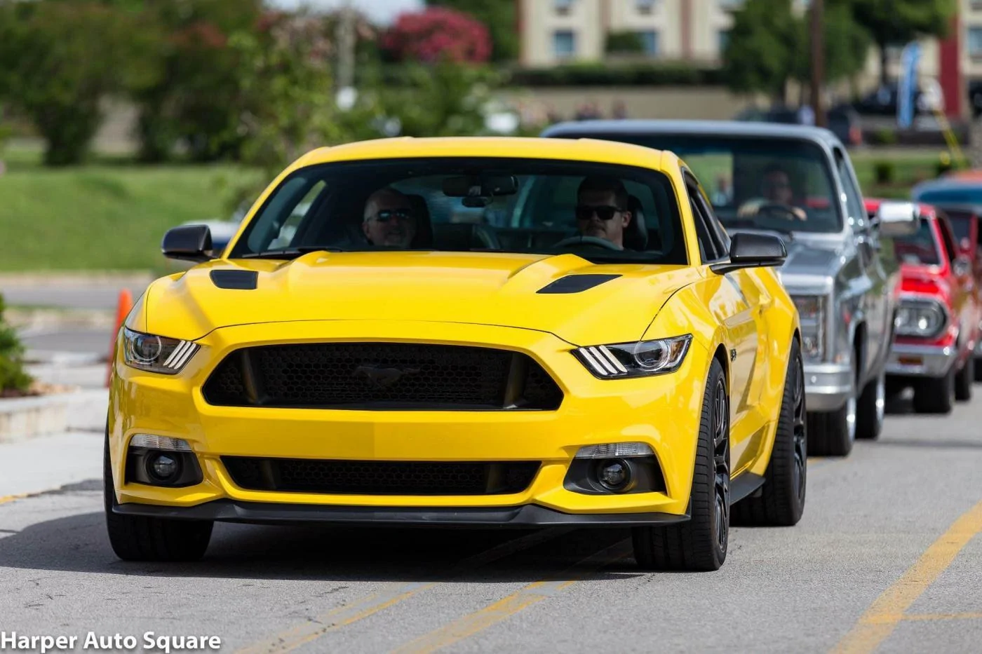

Heres mine Eibach 25mm all around
Enzo
Nov 24, 2015
61
597
311
Orlando
Enzo
2018 Mustang GT PP1
25mm all around. Factory springs.
that yellow looks so good. reminds me of my yellow honda s2000. i had same black and yellow theme.

AV80R
Oct 27, 2015
211
129
NE TN
2020 GT350 Twister Orange L0376
Thanks man! Love those little S2000's
