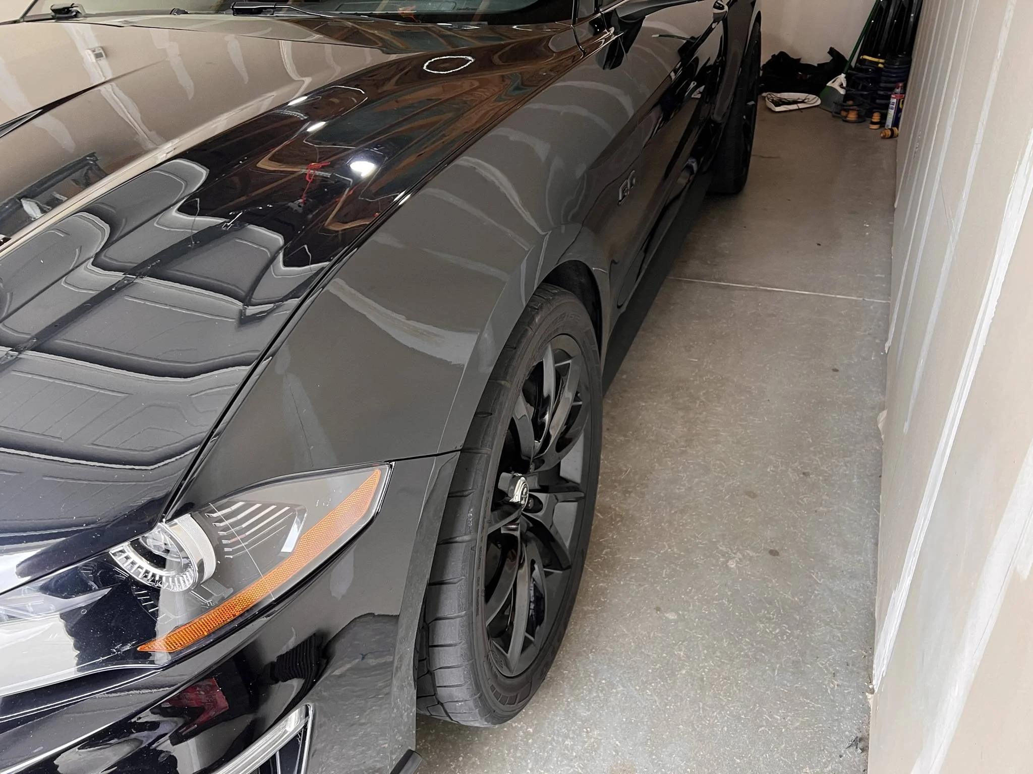

I currently have 20x9 +24 front rims with Nitto555 G2 285/35/20 tires. I am in the market for some new tires for the fronts. I like the fitment but have noticed rubbing inside the fenders. I was lowered on Ford X springs but raised the car back up to prevent further damage from hard rubs. Would 275/35/20 continuing causing rubbing issues? Want to see if anyone out there is running a similar setup.

Fortunately, with a 9 inch wheel width you can easily fit narrower tires. I'd go with 265 to be safe. They'll actually fit better on those wheels.
