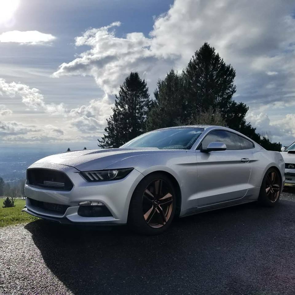

Hi the wheels i ordered on on backorder, i ordered 20x10.5 squared with a +25 mm offset. I was debating switching them to all 40 mm offset. What would you guys recommend, this is my daily, and id like it to look nice? Im on coils, so i can change my ride height.
Either 20x10.5 +25mm all around
Or
should i switch them to 20x10.5 40mm in front and 25mm in rear?
i have the ecoboost performance pack brakes.
pics are of my ride height and set up now. (stock wheels)
Sorry if this post gets recycled a lot.
