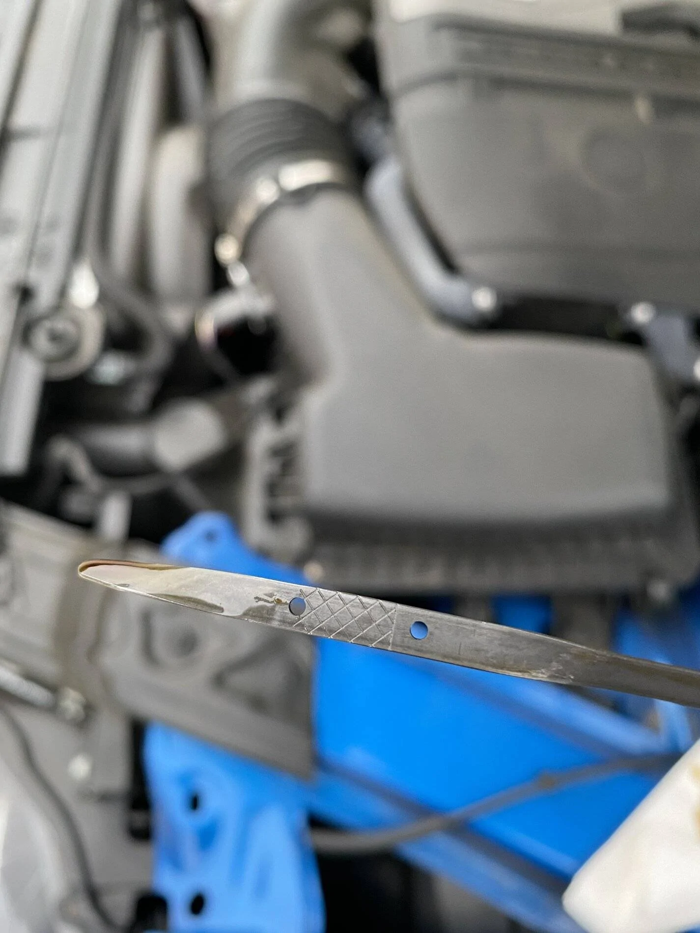

Hi! So I have a 2019 GT manual and my last oil change was in October of last year, I usually check my oil but I slacked for the past month or two and I just checked it after turning off the engine for 15 min, and the level shows below the minimum line, I haven’t heard any weird noises or felt anything unusual so do you guys think I’ve caused damage or do you think it’s fine? Thank you?

Oil is supposed to be between the 2 holes in the dipstick according to the owners manual.

Yea I know but I didn’t notice that it was low for a month or so, and was just wondering if it could be messing things up or if I’m fine since It could have been worse with lower oil level 😭

It’s fine. Add a quart or so.

It holds 10 quarts, you are fine. As Cory said, add a quart or so to get it back between the lines. You haven’t hurt anything.

Dealership once put in only 8 when 10 are required. Drove 40 miles and according to oil analysis, all was fine. Sure, you drove more but I had less oil. I would not worry. Have done my own oil changes since then. Even free is not worth it when the do a bad job.
In my car, full is in the middle between the dots, not at the top dot. measured 10 qts went in. Unless Pennzoil is shorting us, LOL.
