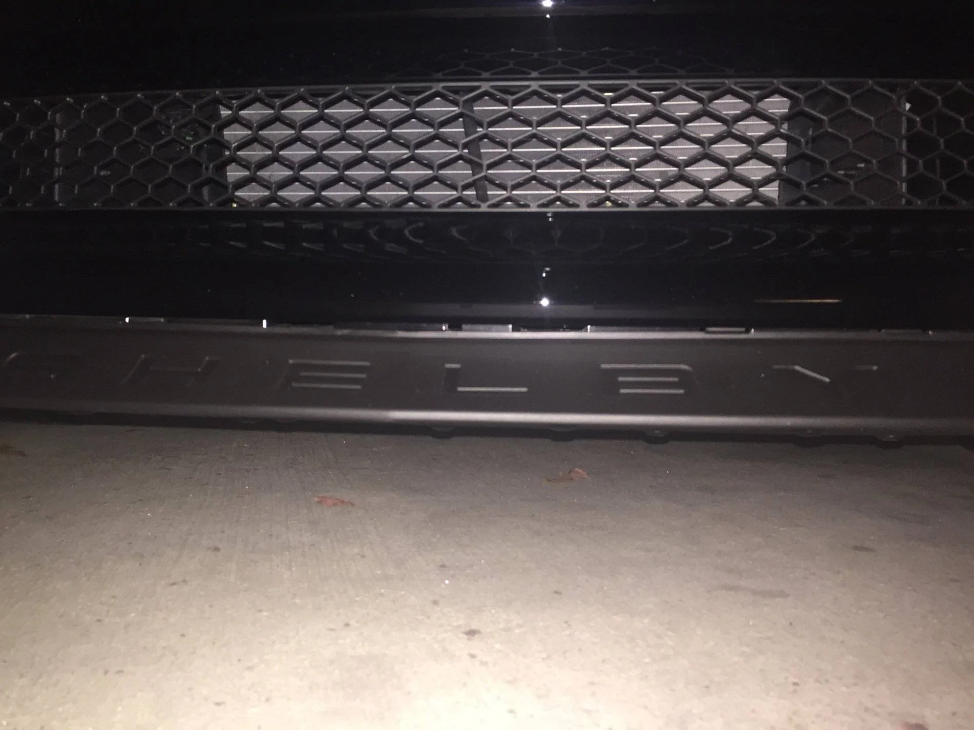

Another thing that dealers seem to overlook at delivery is the car cover. Check your window sticker to see if your R came with one. The R car cover is different than the non R car cover FYI. Also, get down and inspect the front spoiler for gaps between it and the bumper fascia. Many have been installed incorrectly.

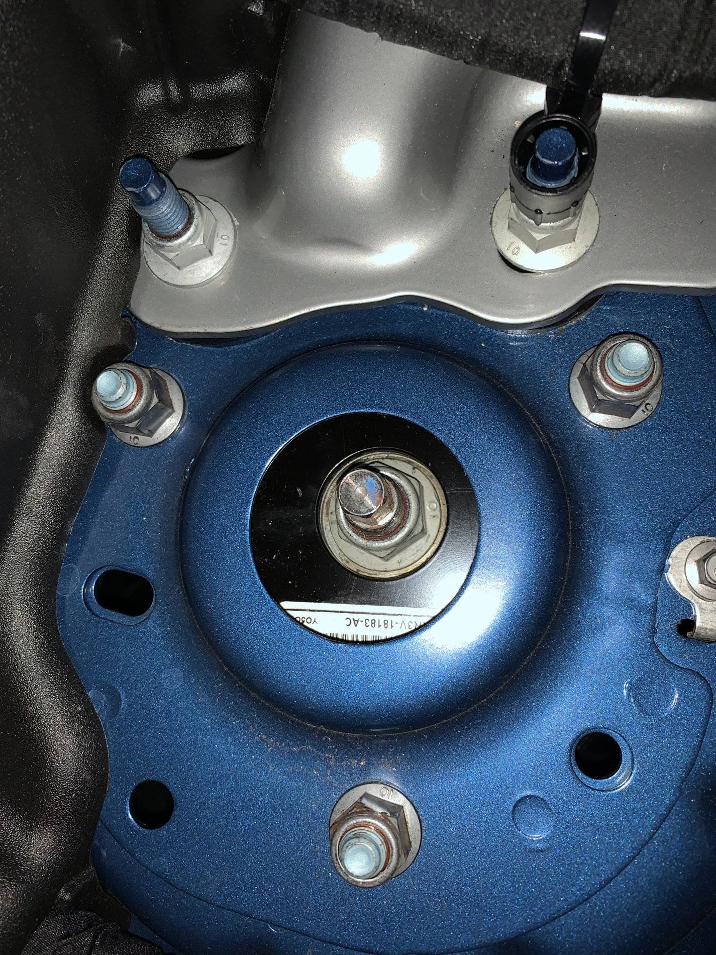

How can I check the camber plates were installed?

@911GT350R the 19' Rs all came standard with adjustable camber plates, these are dealer installed parts so once a dealer gets in an R to sell it's on them to install them, realign the car, then sell. The easiest way to check is you can visibly see just enough of the plate with sticker on them through the top of the strut opening. Take a look at @dom418 picture above, the black plate with the white sticker is the adjustable camber plate. You should be able to read it enough to even see where it says "driver side/passenger side" for each one

Here's an example of an incorrectly installed front spoiler.
