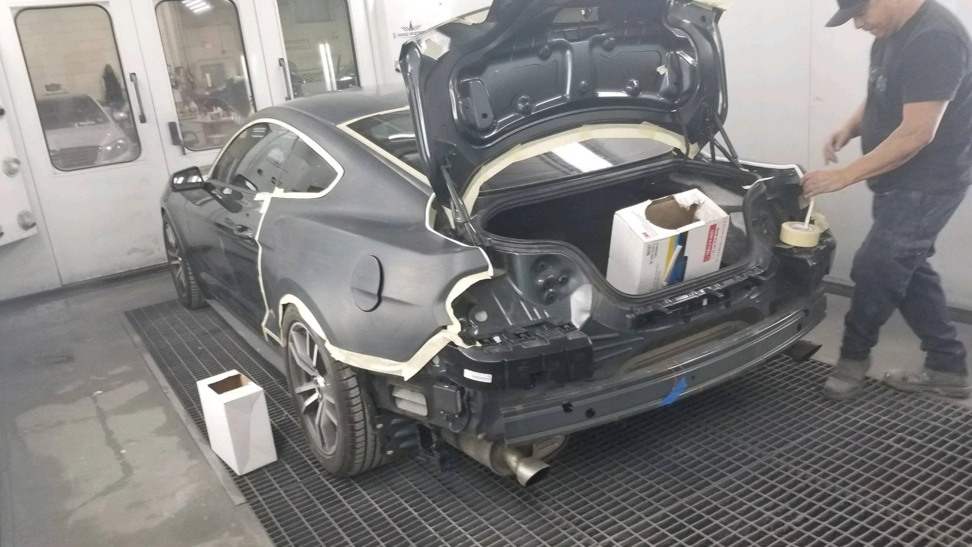

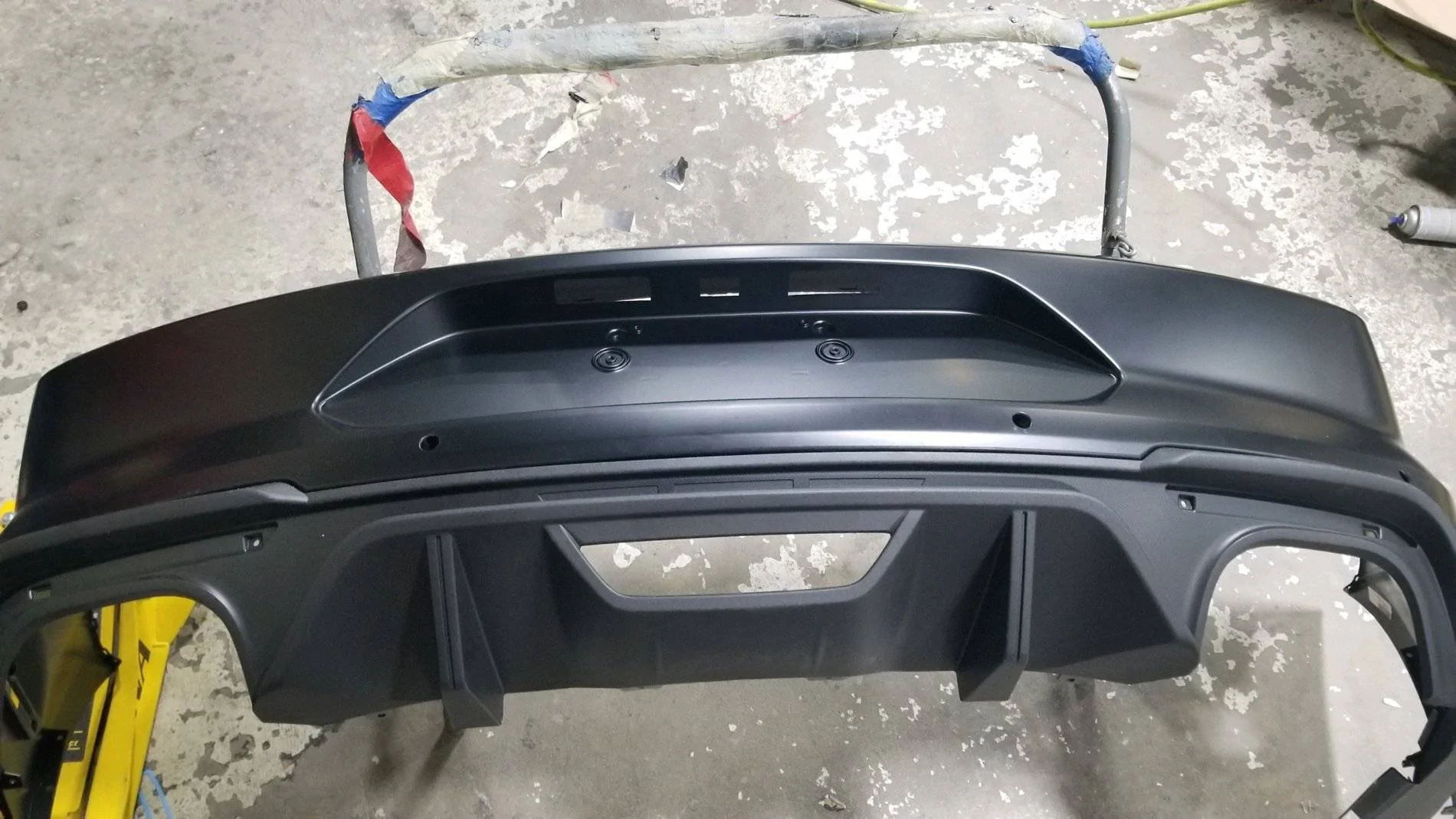

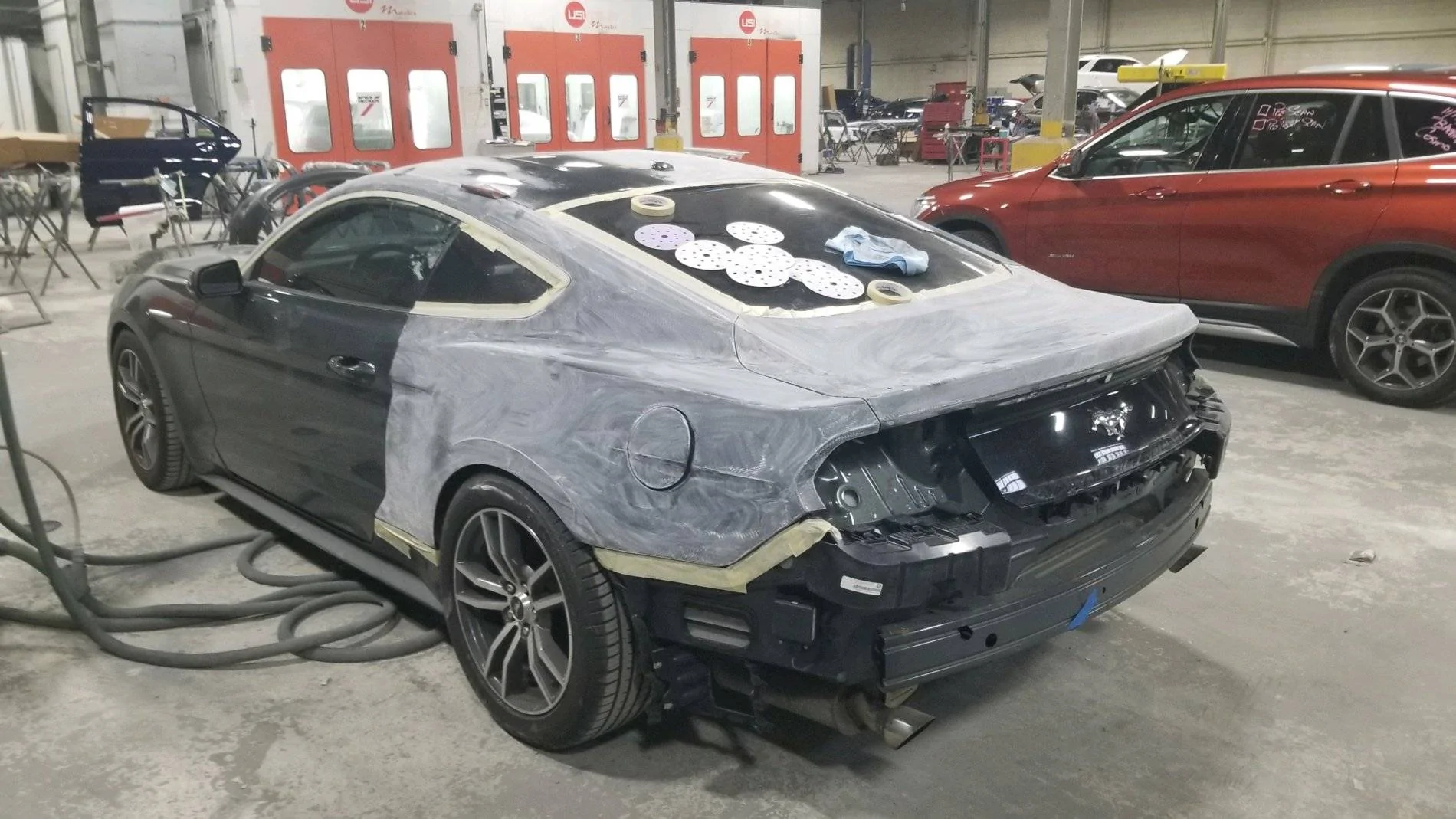

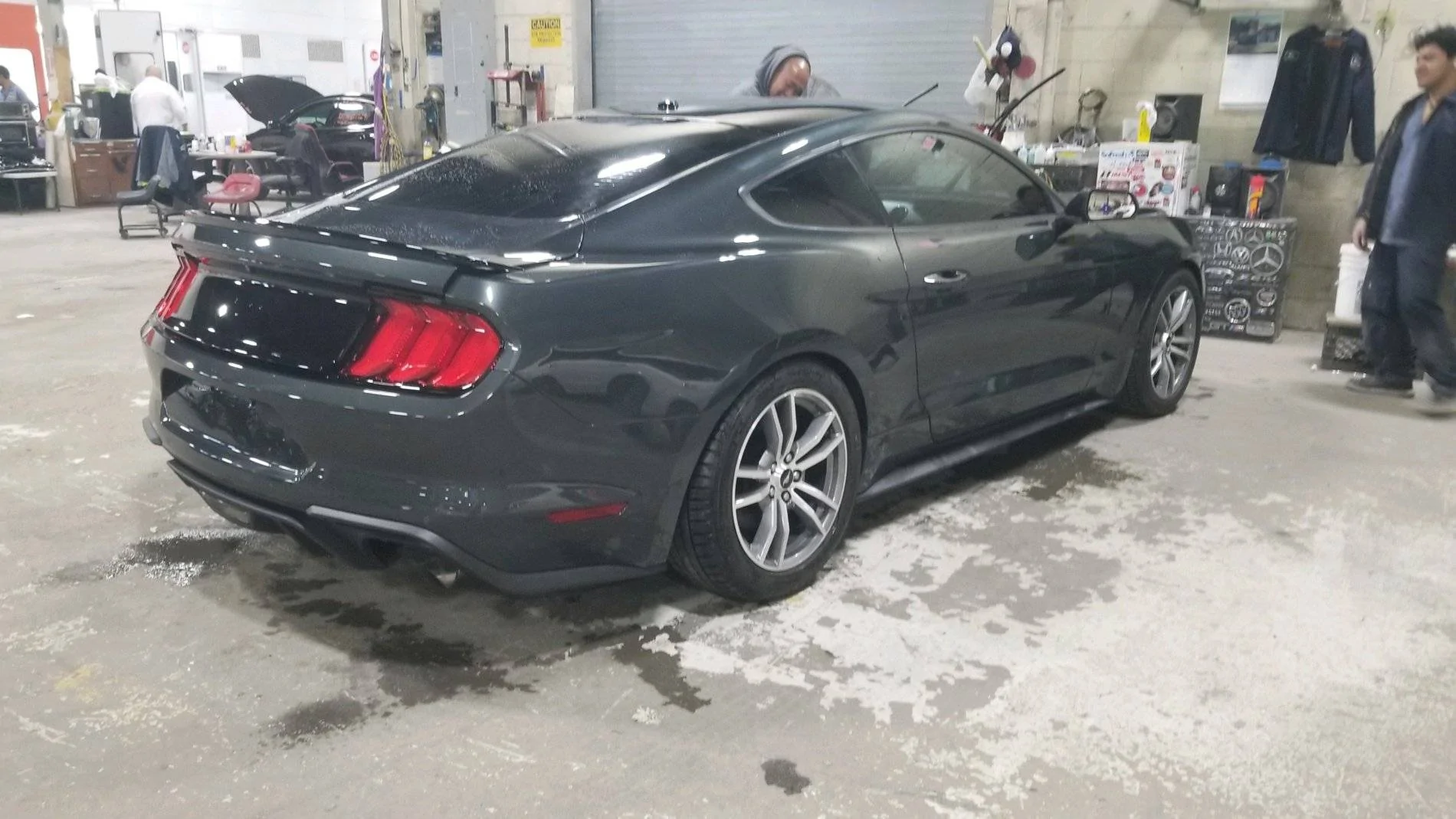

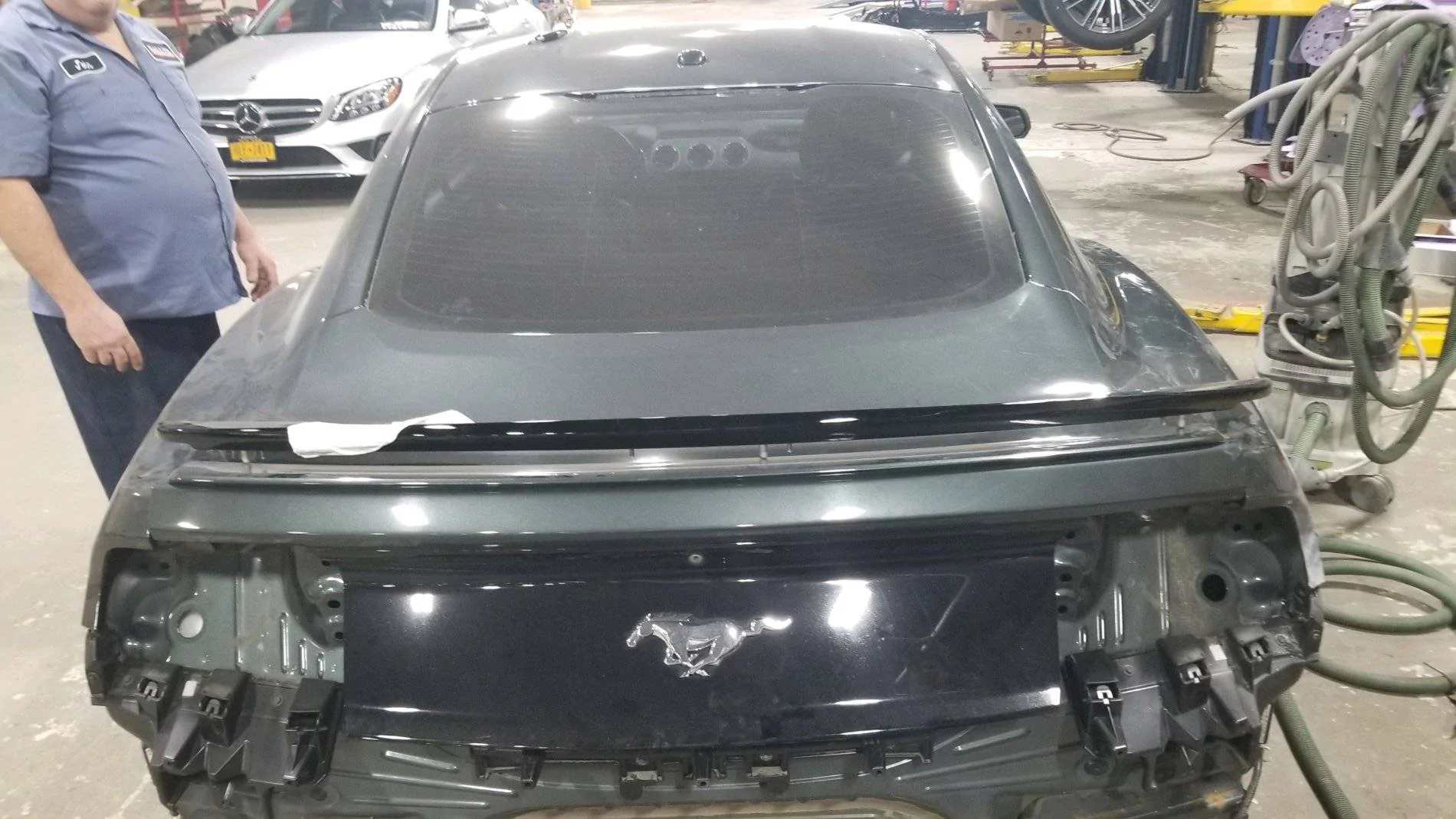

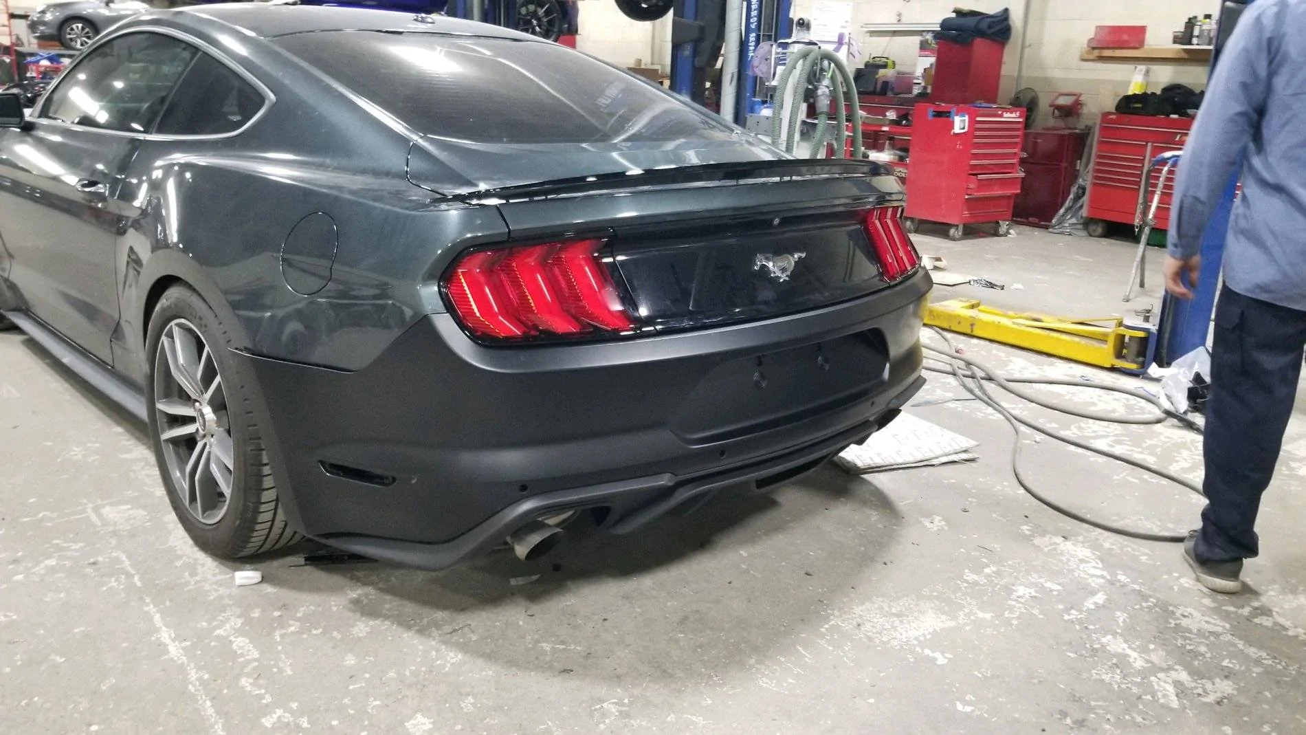

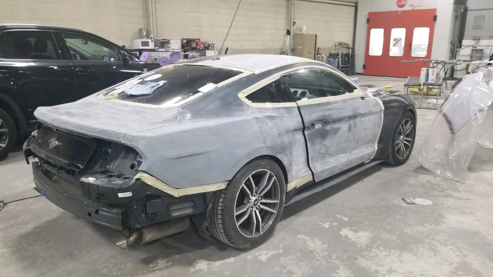

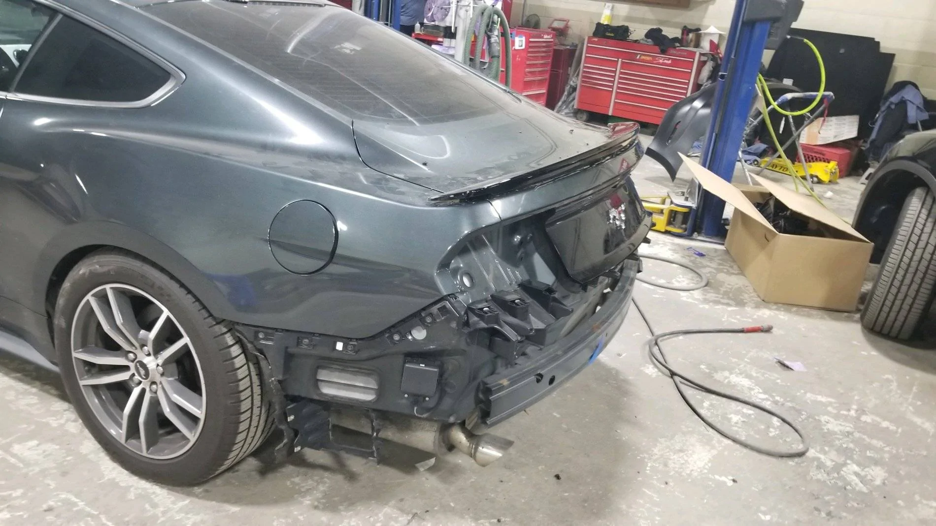

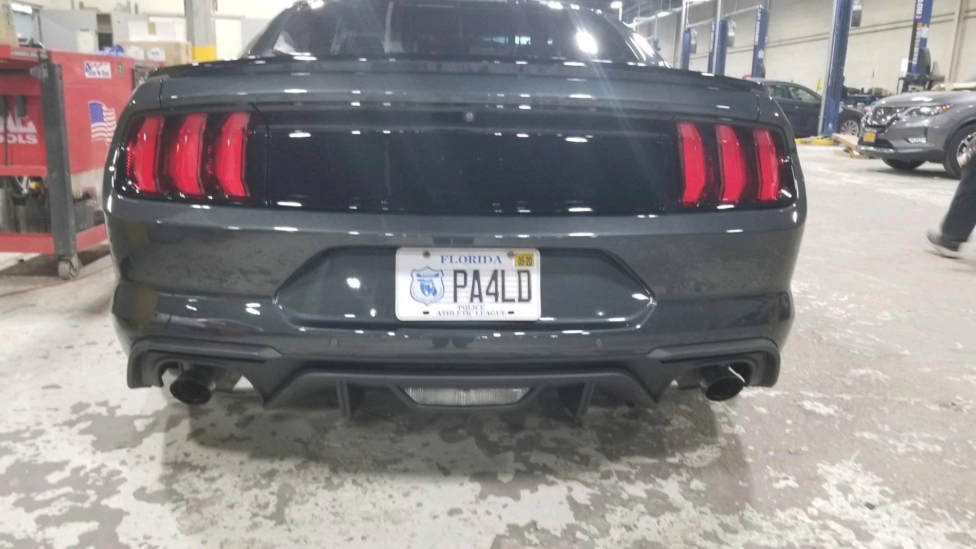

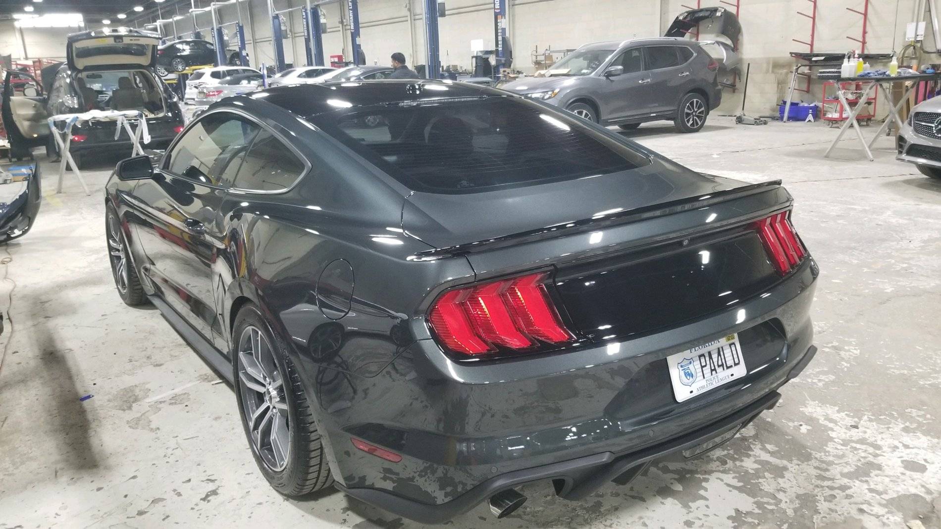

I did the 2019 gt peformance pack rear end on my 2015 mustang EcoBoost. Wing , bumper, tailights. All oem parts

I did the 19 rear end swap , I posted pics on this thread. Bumper (quad tips), tailights , wing.
