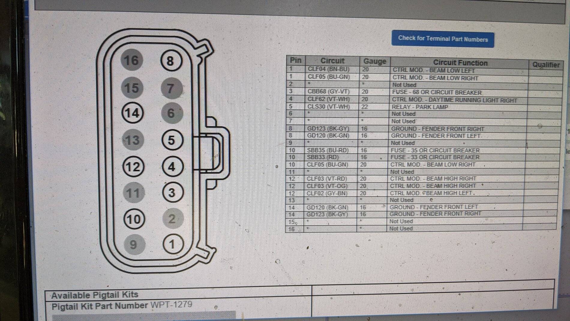

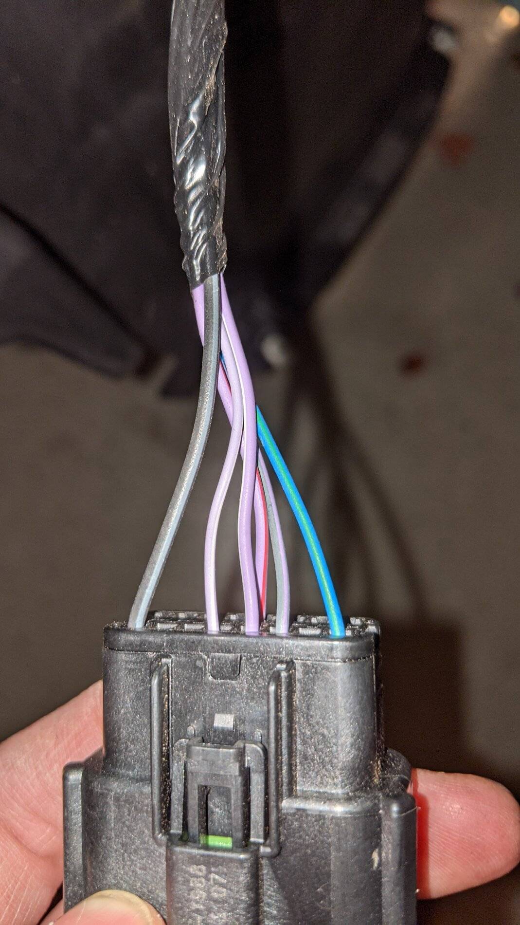

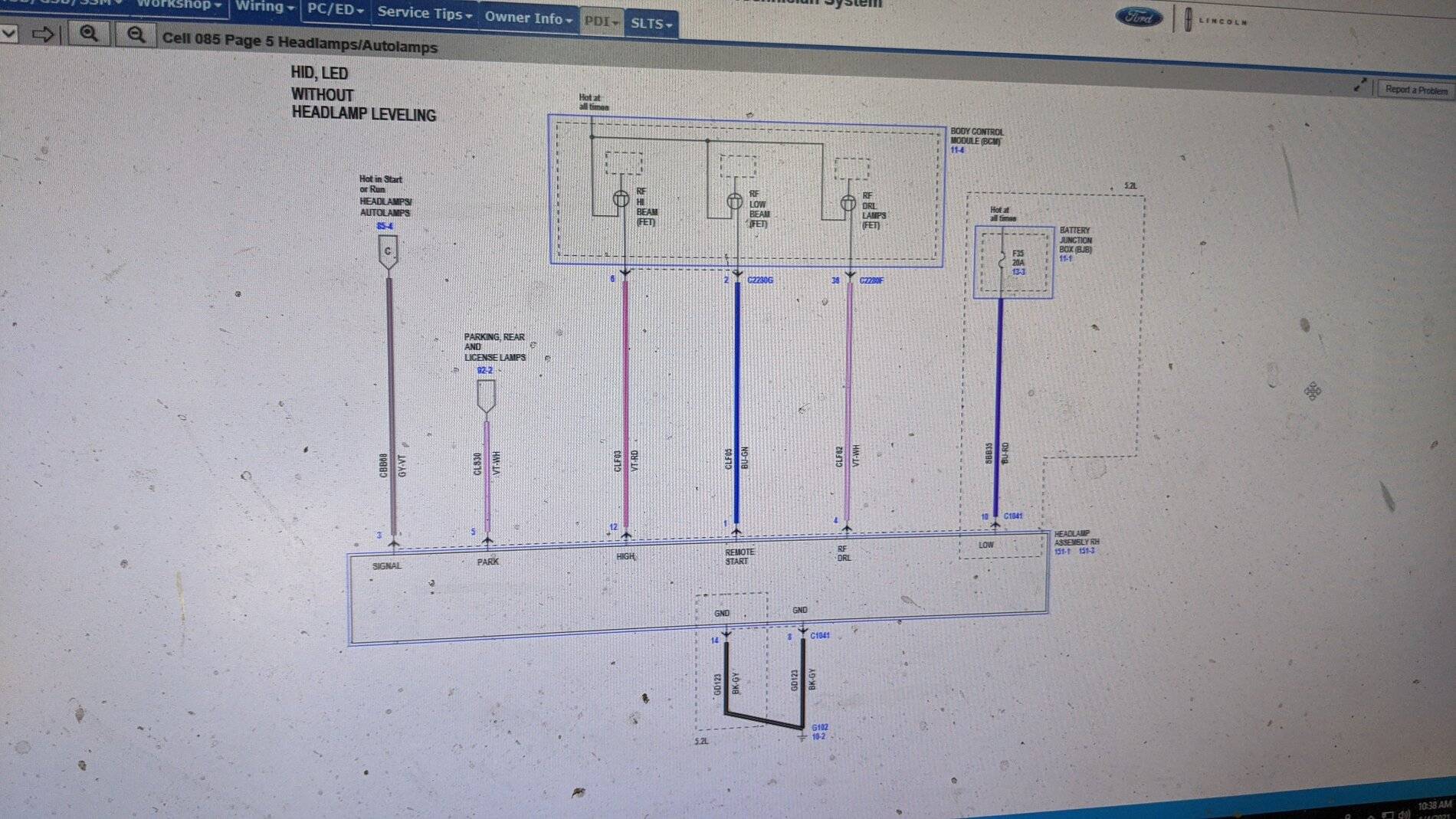

just got back from the ford dealership to which the electrical mechanic explained to me that the best option would be to run the wire to the fuse box and give the DRL grille lights it's own power source, and by using a relay. Running the lights by just splicing the existing DRL will most likely short a fuse, or give engine codes.
The wires were also explained; Holding the passenger side Headlight plug, the wires are starting from the front row facing you(clip face you), right to left are wire ports(openings) 1-8, then the wire row further from you is 9-16(again right to left). Wherever the BROWN and GREEN is, or (car depending) BLUE and GREEN which is what I have, this is wire number 1.
The wire the you should connect the relay into is is wire opening 4 which is violet and white. DO NOT CONFUSE this with the wire numbers 5 which is also violet and white right next to the first violet white. the ground wire can be attached to the battery ground or maybe there is a fuse box ground wire as well so you don't have to stretch it to the battery.
Hope this helps.
