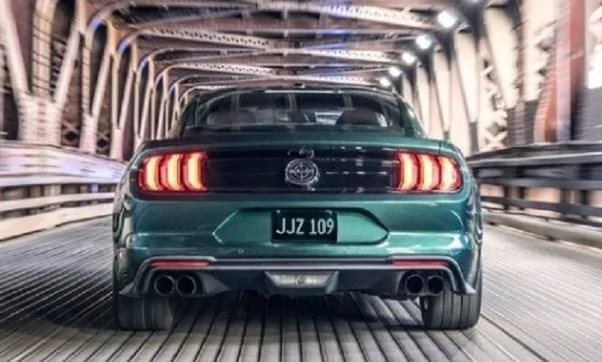

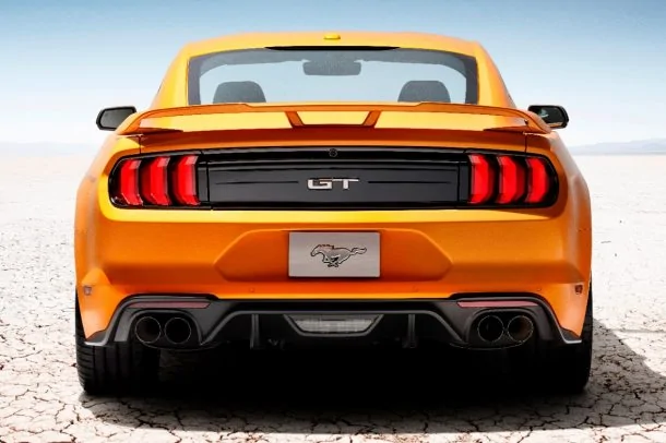

Before you lay out any coin, be aware that there are two different rear valances to choose from.
The Bullitt rear valance is different to the GT one. It's not as "busy":

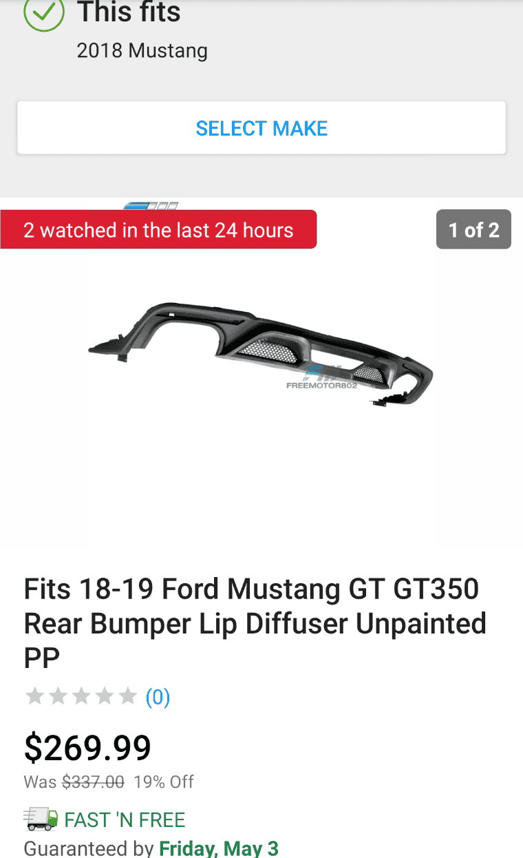

Ther is a nice gt350 looking style rear valances that came out that fits ecoboost and GT that is very nice looking for the 2018/19

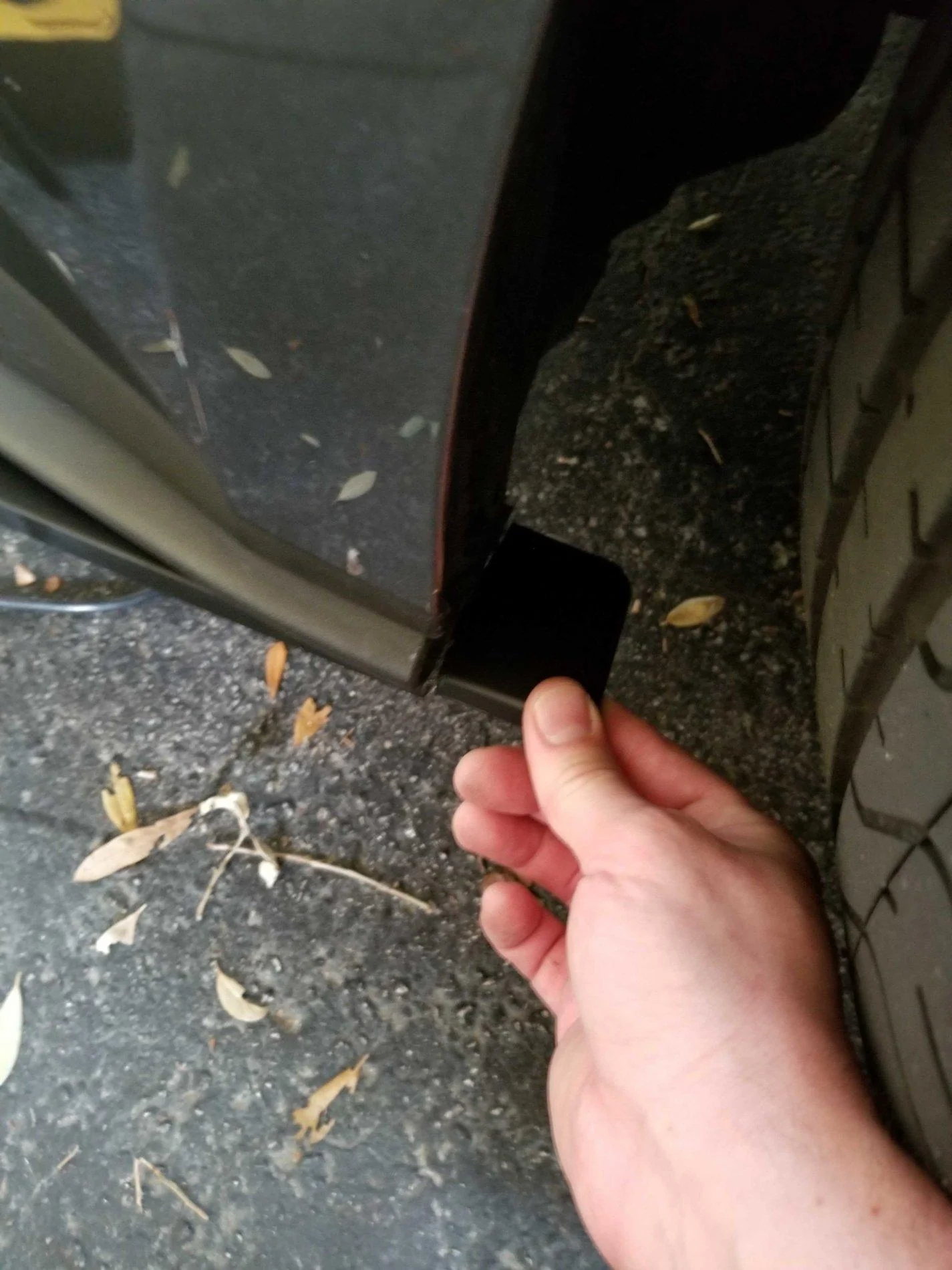

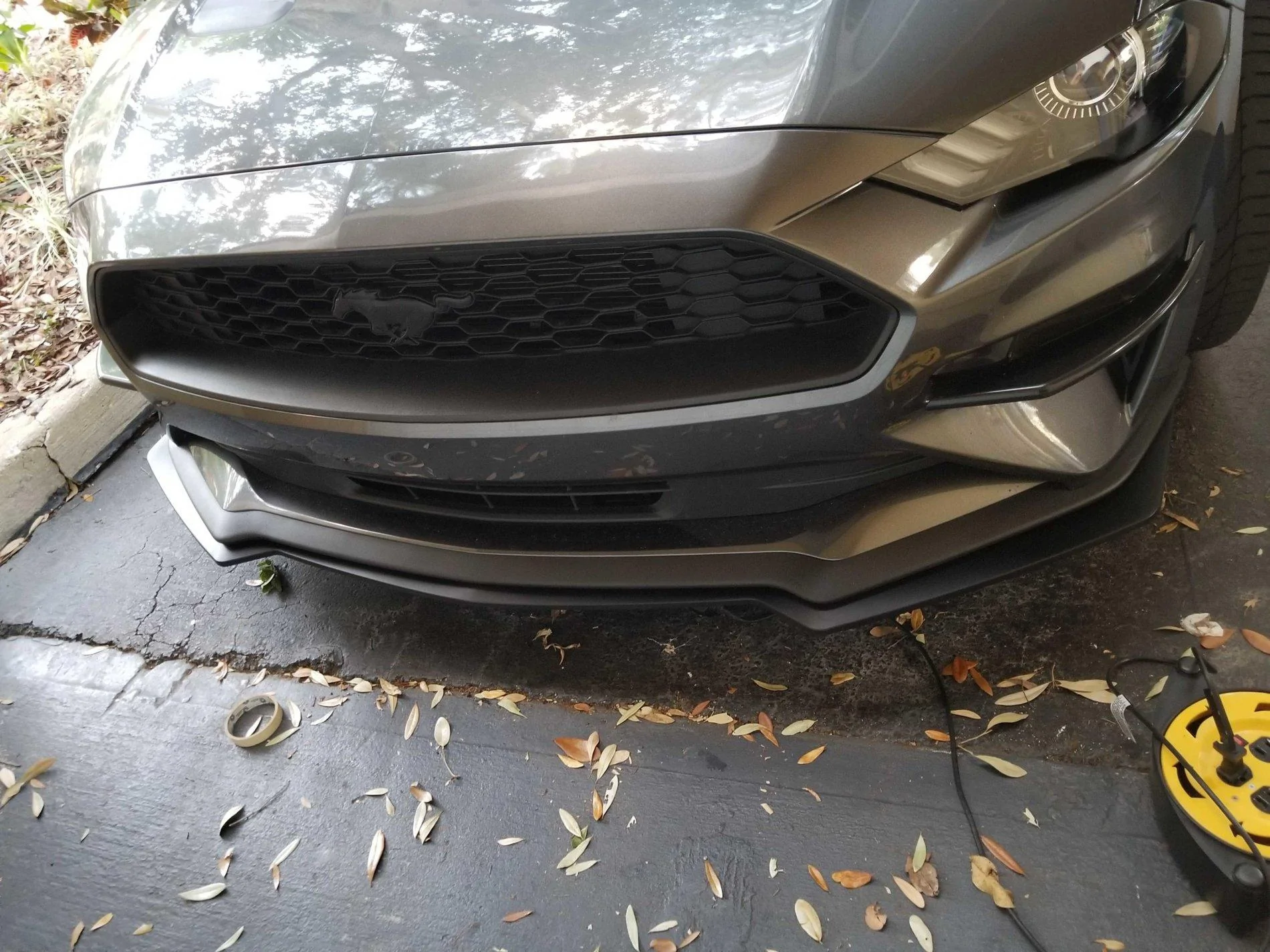

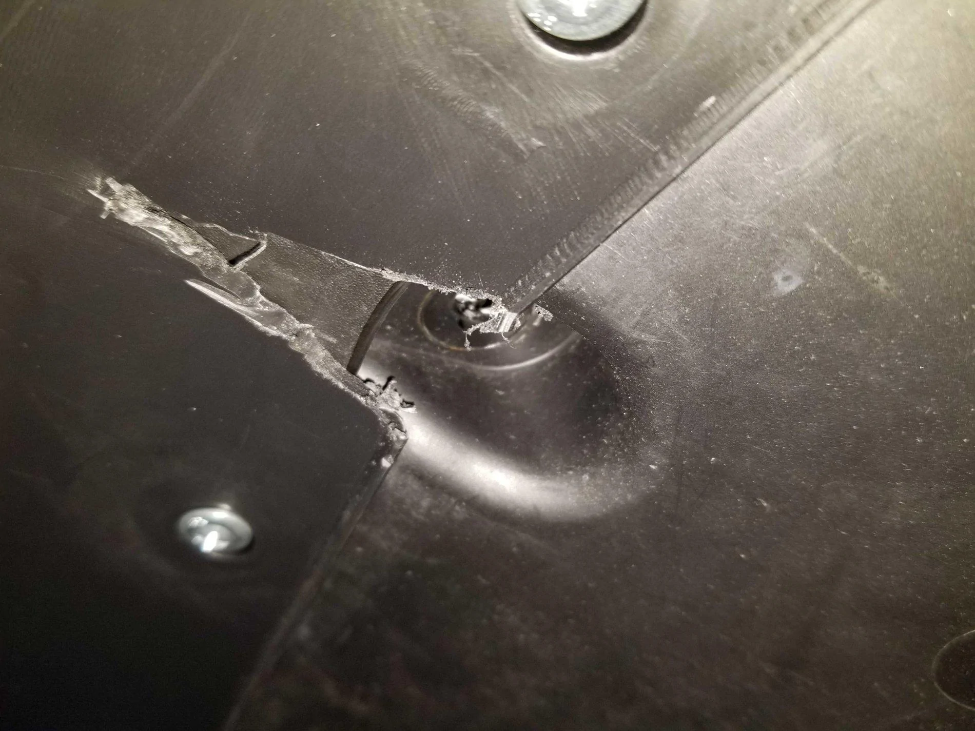

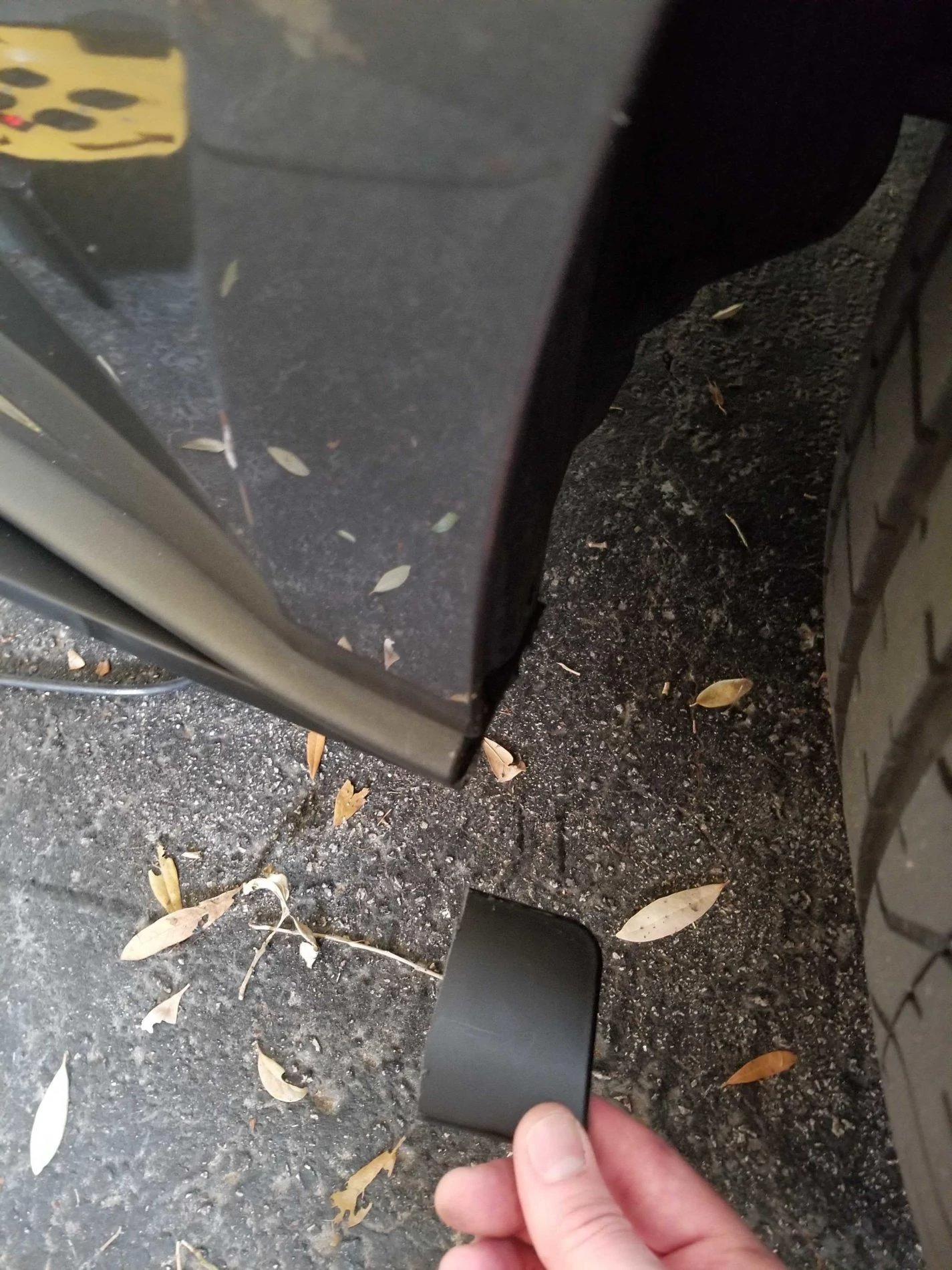

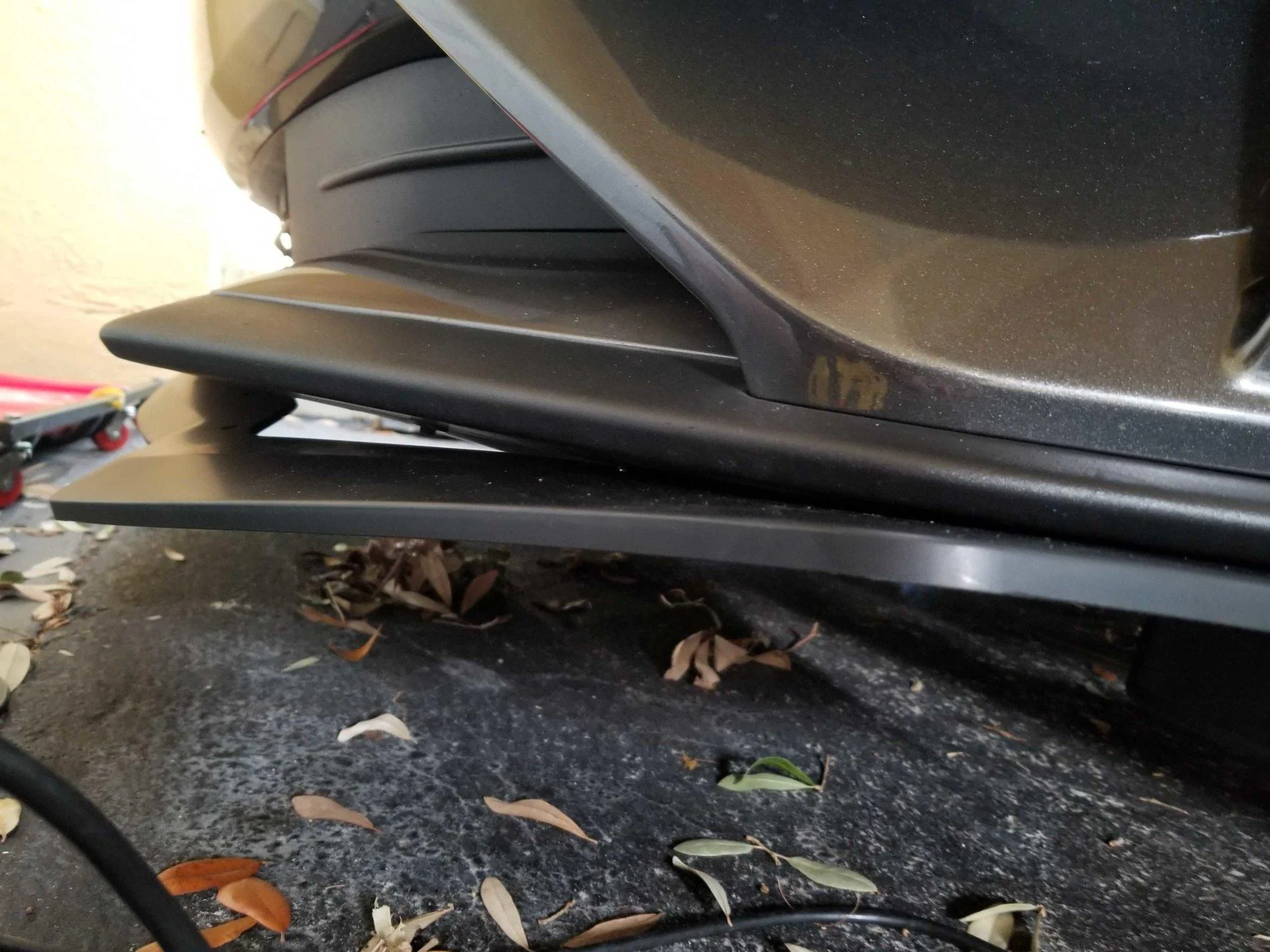

so i got this splitter installed, but i think the GT and Ecoboost bumpers are diff somehow... my 2nd screw is not 5" from the wheel well, more like 2.5. so the splitter stuck out almost 2" into the wheel area. i had to trim both sides. then the splitter was bowing quite a bit bc it acted like it was being squeezed from either end (prob was) so i cut a slot in the middle to relieve some stress. only added screws where it was totally on the front lip, bc some holes where on the edge of the lip and the belly pan. pain in my ass, dont think IKON even bothered to check on an ecoboost model, but i had bought it so long ago, i couldnt return the thing.
so its on, after some finagaling and forcing. good enough. wouldnt pay for it again or recommend to any ecoboost owners really, not as easy or clean an install as the GT apparently. but if you want cheap, it can be done.
why or how those bumpers are different i may never know. but id swear they are. go figure. ford right. haha
