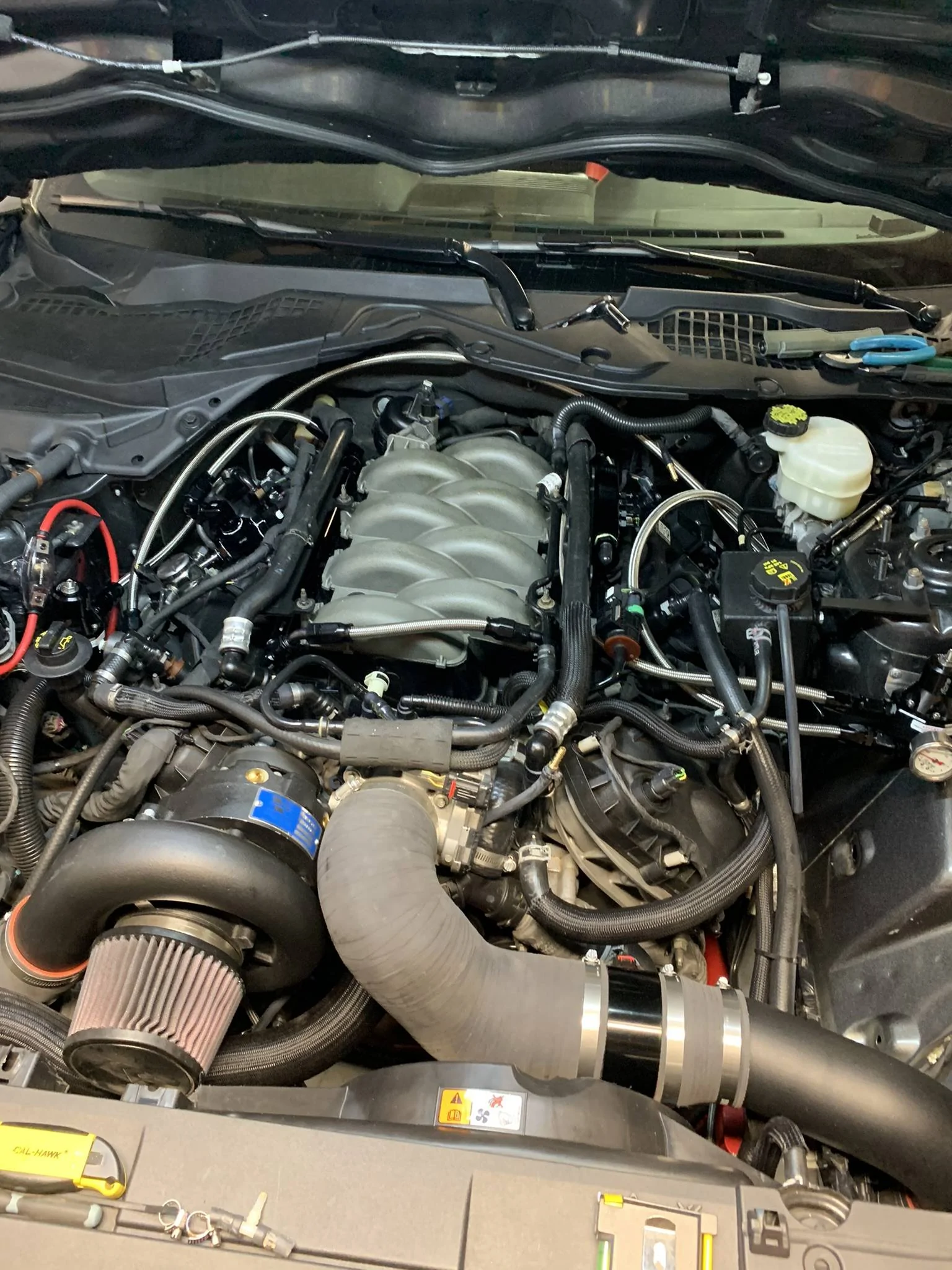

I’m in the process of finishing up my dual pump/ dual regulator on my 2018. I’ve read different ways to setup the fuel pressure but at this point I’m mixed up. Can someone please help me out how to set it up properly???? Thanks for for the help btw it’s a vortech setup on 3.6 pulley for e85 if that matters.

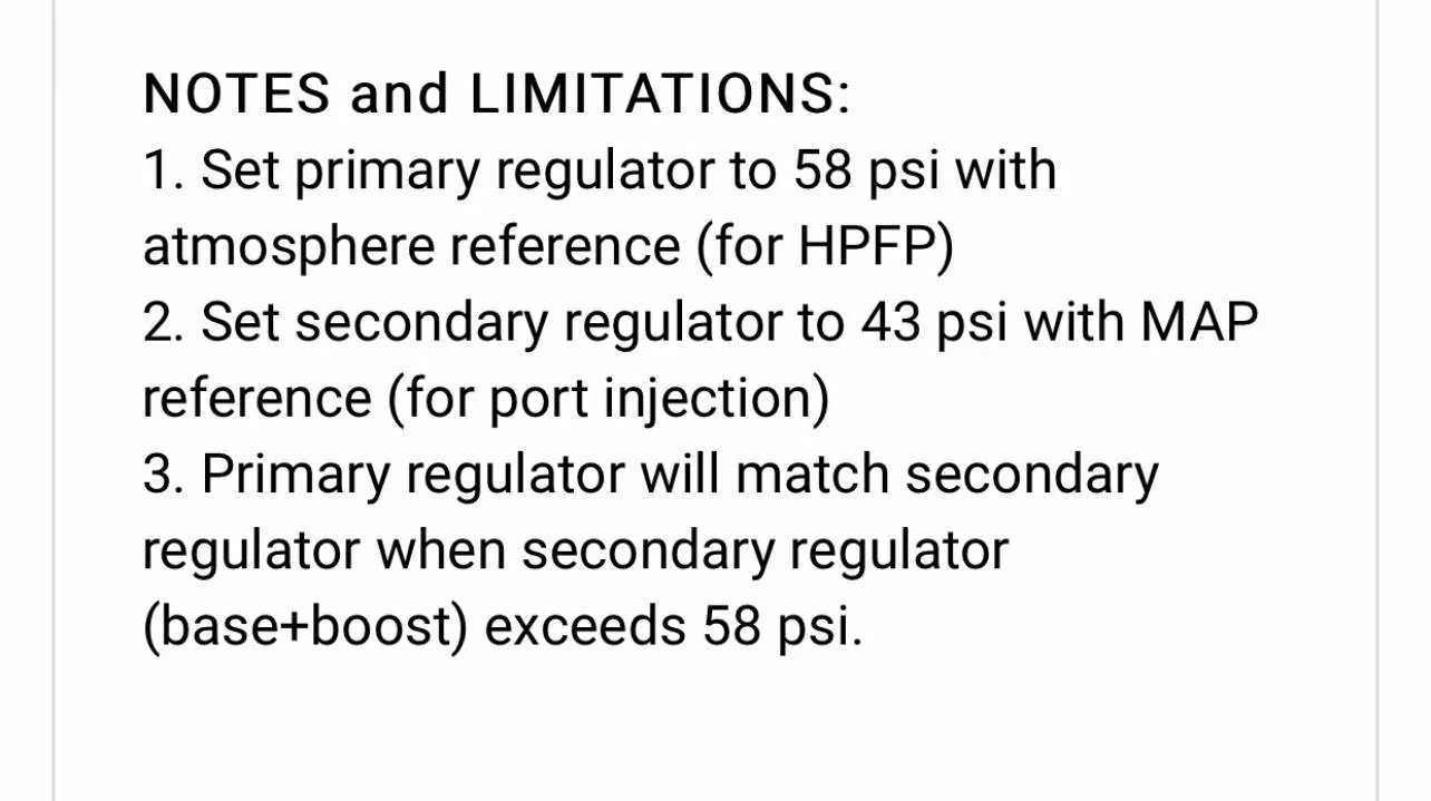

For the PI side you want to set it to 55 psi with no vacuum source. Once the regulator is connected to vacuum and sees manifold pressure at idle it should drop down to 45 psi. For the Di side, set it to 60 psi and leave the vacuum line off so it stays at a constant pressure.
That is how my tuner told me to run mine and I have had no issues since.

I set mine as it stated on the Fore website and have no issues.

Looks what you guys are mentioning is pretty much same thing. Thanks guys
