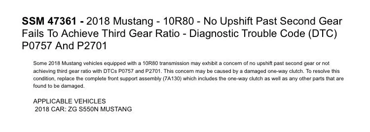

Here is the actual Ford SSM bulletin regarding the 10R80 2nd/3rd gear clutch failure issue:

Cobra Jet, That would be it! I asked if there was a bulletin for it and they said no. I wonder if that bulletin is because of mine, haha!

Yeah, they fixed what Cobra Jet just posted. Exact same issue.
