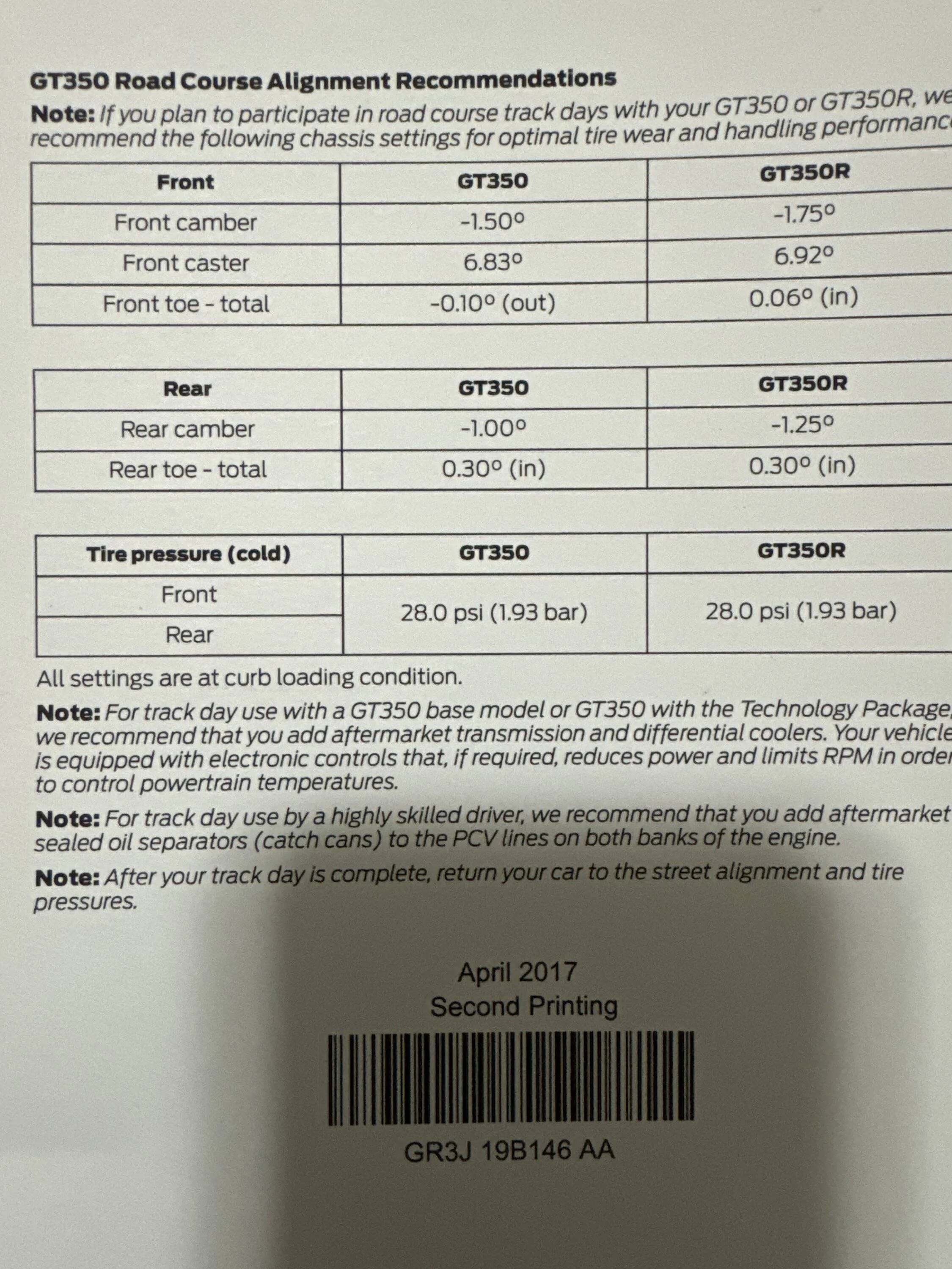

Just picked up a gen 2 2017 with the tech package. A single sheet was added to the owners manual dated April 2017 that stated you should get an after market trans and dif cooler if tracking it. I thought the tech package and base cars had these coolers standard in 2017?

All 2017s & on have the Track Pack components standard.

As stated, all 2017s have coolers, so you should be ok. That supplement may just be a carryover. If you can't tell by looking under the car, the tech cars had that very thin rear spoiler you can look up pictures of to see (unless your spoiler was replaced I suppose).

Thank you. I’ll try to look under there to see. Not certain exactly what I’m looking for under the car for the dif and trans.
It was the April 2017 printing date that through me off as perhaps early 2017 cars didn’t yet have the coolers.

I'm sure the problem is resolved but another thought that occurred to me is you can also toggle through the digital gauges and make sure the transmission cooler is working as another way to tell. It is my understanding that on the Tech packages you had to enable it through Forscan to get a reading. Might save crawling under the car.:like:

I’ll try forscan too thank you.
