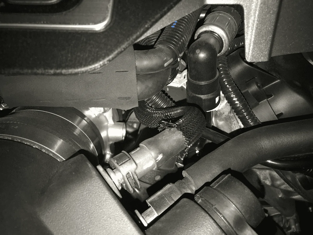

I have installed cai, done my own springs, Change my own oil but I cannot figure this out.

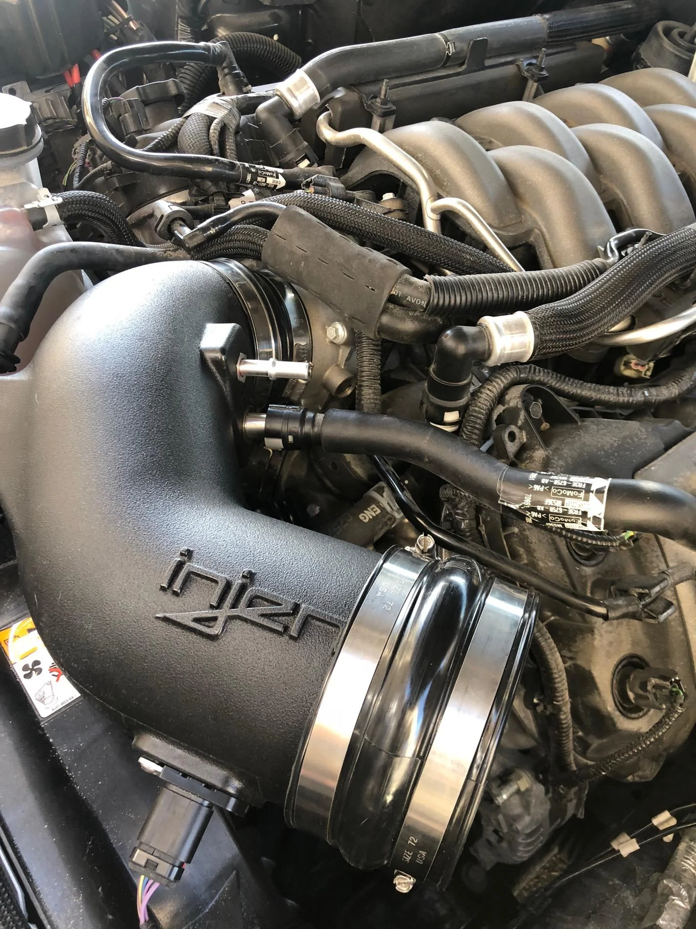

I bought a 2015 mustang injen intake and installed it but ran into problems when connecting the “tubes”. If you take a look i have everything connected except for one hose. I looked every where but everything seems to be connected.

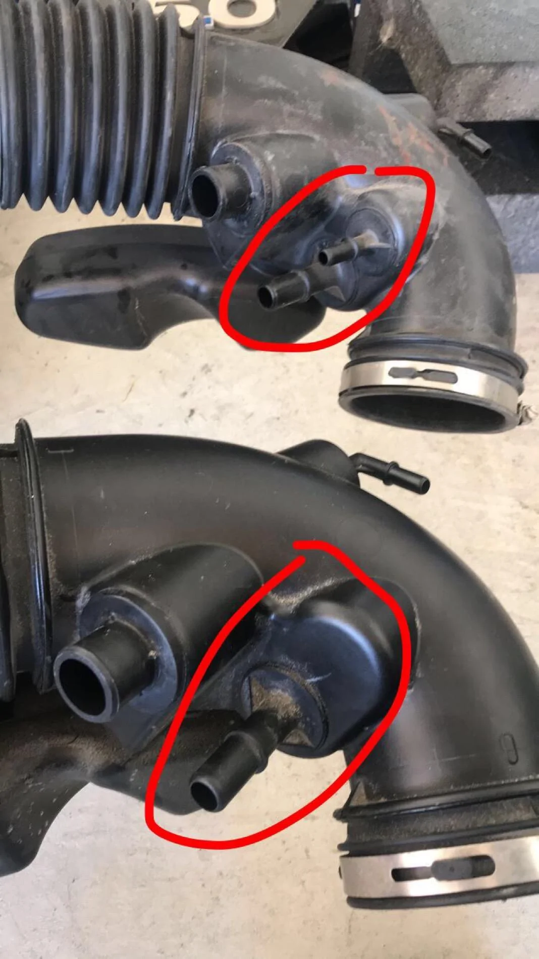

If you take a look at the second picture you can see to stock intakes for 2017 mustang gt...mine only has one spot for the connection and my brothers has two.

1 goes to the valve cover for the PCV breather which you have hooked up. the other is a hose that goes under the intake manifold on a 2015, am guessing was removed on 2017 models?
you could just cap it and be on your way

Yeh. 2017 models don't use that fitting. My 2017 kit came with a plug and the instructions for the mod as well. The 2015 - 2016 kits don't fit 2017 models. You should be able to remove that fitting and install a blanking plug with same thread. :cheers:
