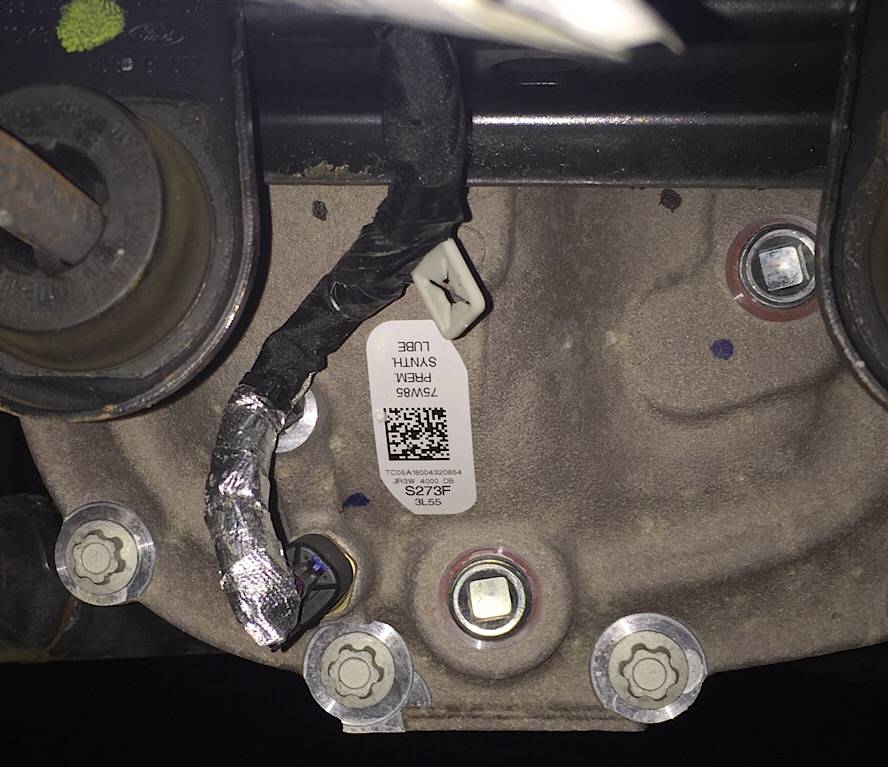

Unless I missed it - look under the rear of the car. On the back of the diff pumpkin cover, there should be a white decal attached to the cover. The gear ratio is listed on that decal.
Of course if someone messed with the rear differential by swapping the whole diff OR just the gears, you’ll have to use other methods of determining as noted above.
Here’s a pic from my 2018, the code on the tag of “3L55” is a 3.55 rear. It’s also a Torsen rear.
TIP:
- If the rear diff has Trac-loc guts, you won't be able to see through it with axles removed. There will be a "bar" in the hole which is for the spider gears.
- If the rear diff has Torsen guts, you'll be able to see through it with axles removed.
