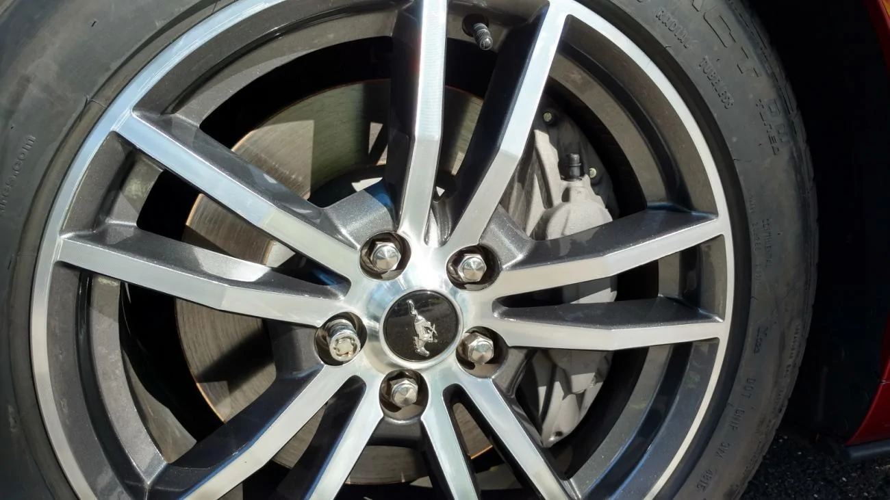

Yes - you have even pictures of GT in that link there with these wheels on. EB PP brakes = GT non-PP brakes. In addition, look at the pictures JamesinLittleSilver posted and compare to your brakes.

First advise you got was the best. Perf Pack EB has the SAME front brakes as the base (non-PP) GT. Any old 18" wheel will fit without issue. Might find some 17 inch wheels to fit. 14-inch brakes just aren't that huge.
I doubt you'll find 17 inch wheels to fit. My winter rims on my Ecoboost Performance pack have VERY little clearance to the brake calipers. In fact one of the wheels has 2 rows of weights and the second row only clears the calipers by about 2 millimeters.
But there were TONS of options on tirerack.com for me so I'd say any 18 inch should fit.

Okay, so 100% the link on eBay I posted rims will fit my EcoBoost Premium 2017 with Performance Package?
I keep getting answers that are no from Ford and eBay seller.
Thank you
They are confusing the ECO PP with the GT PP, those are the same wheels I have exactly.
