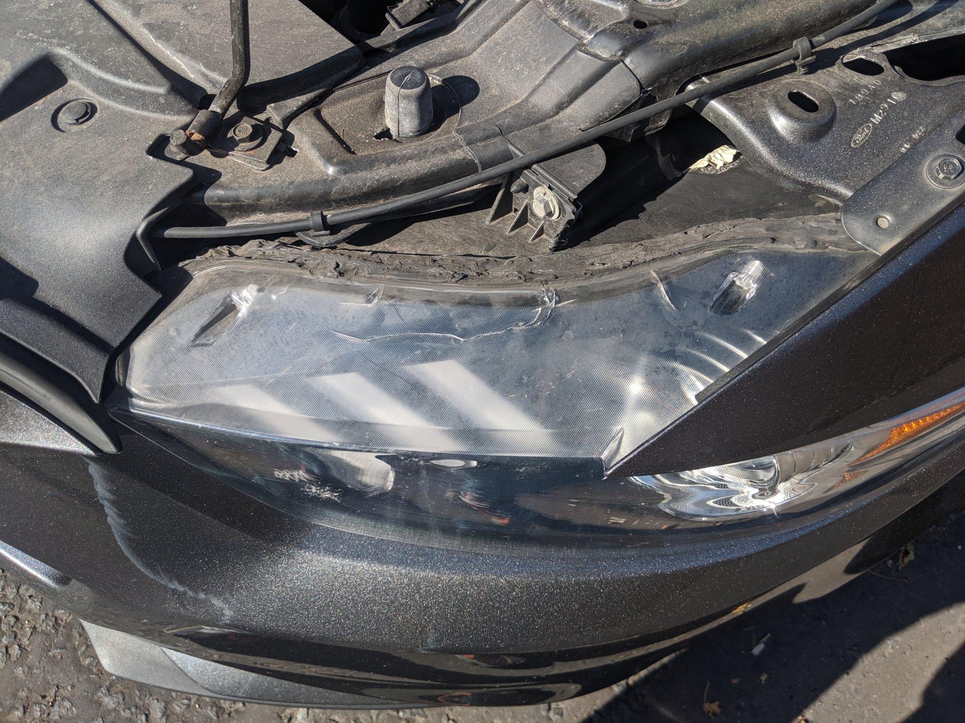

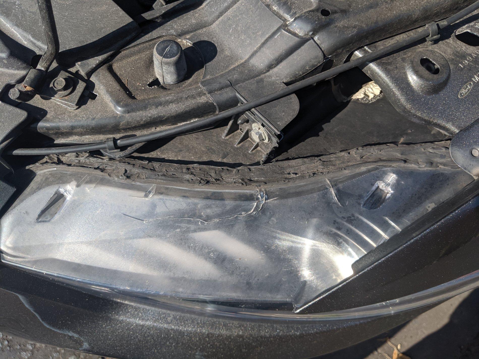

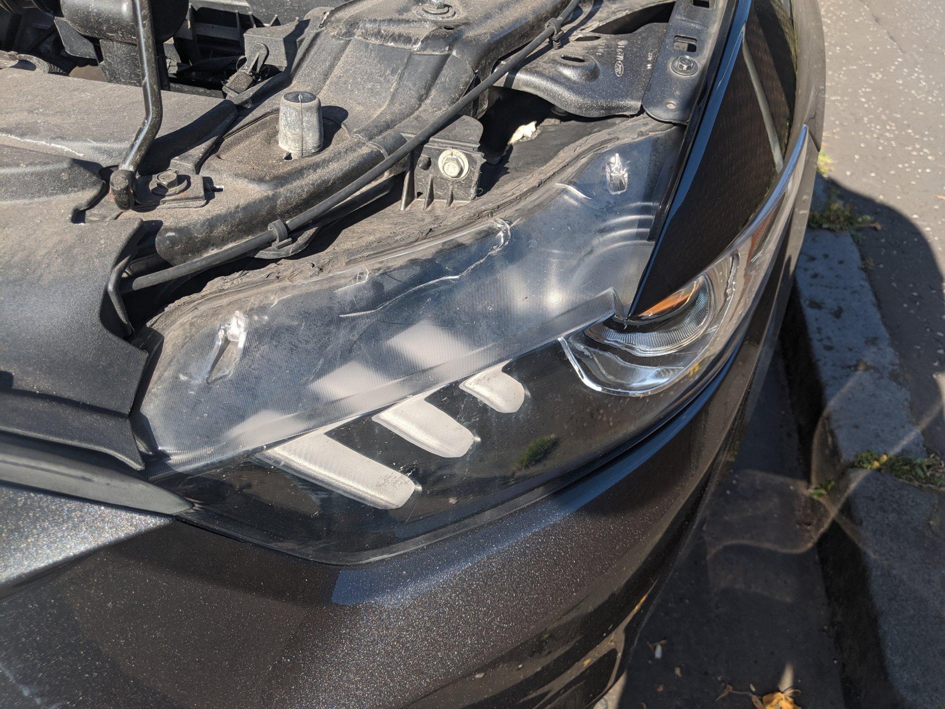

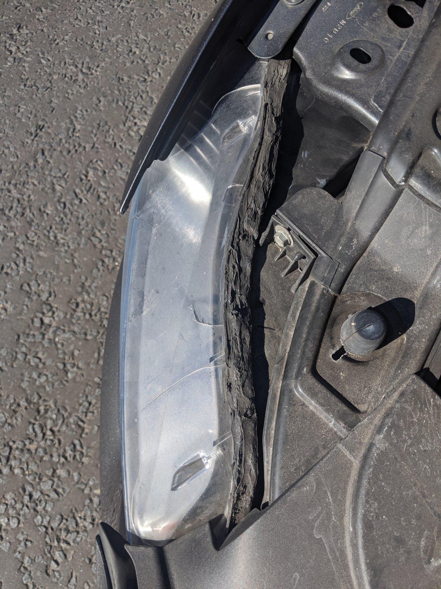

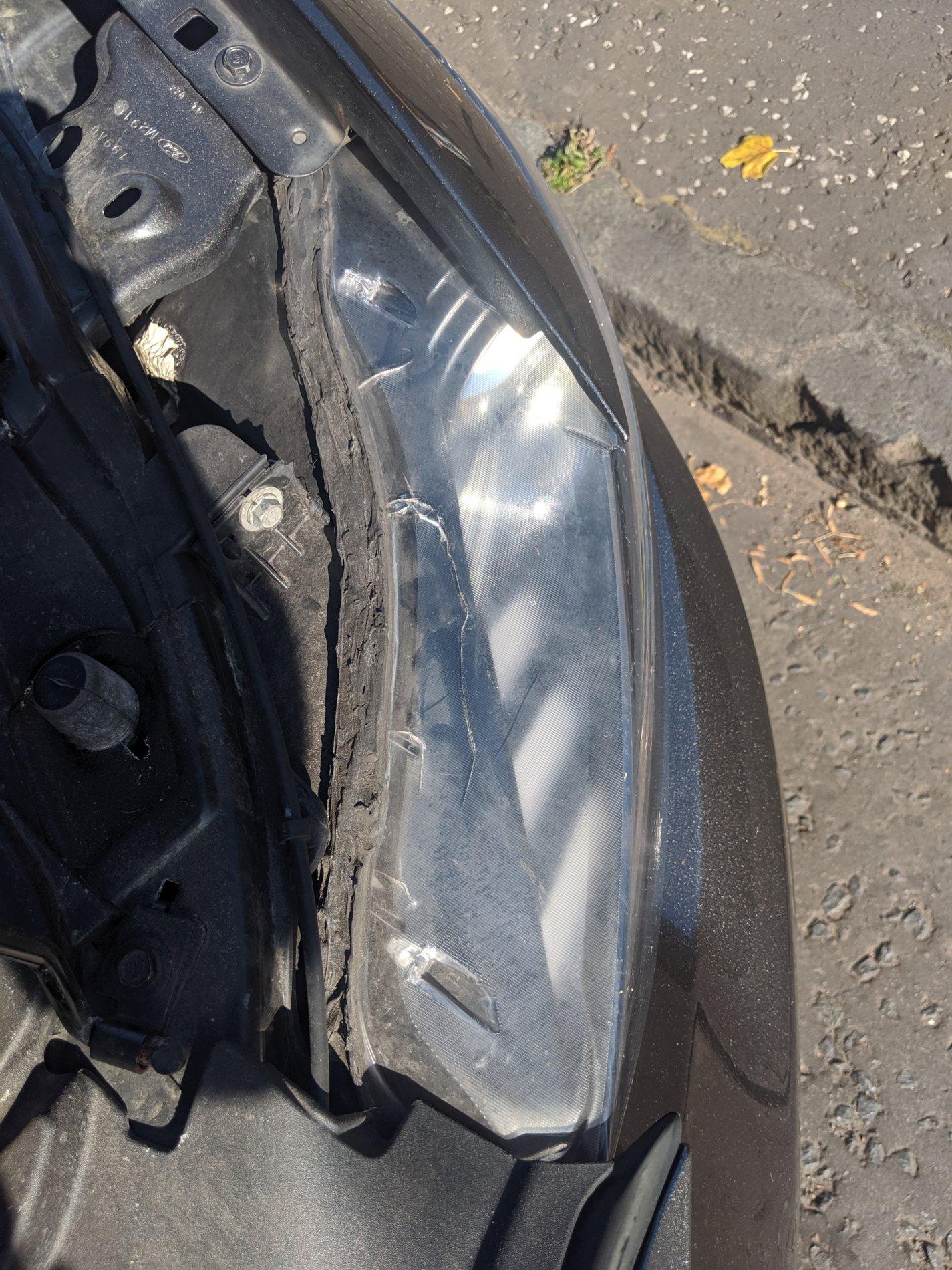

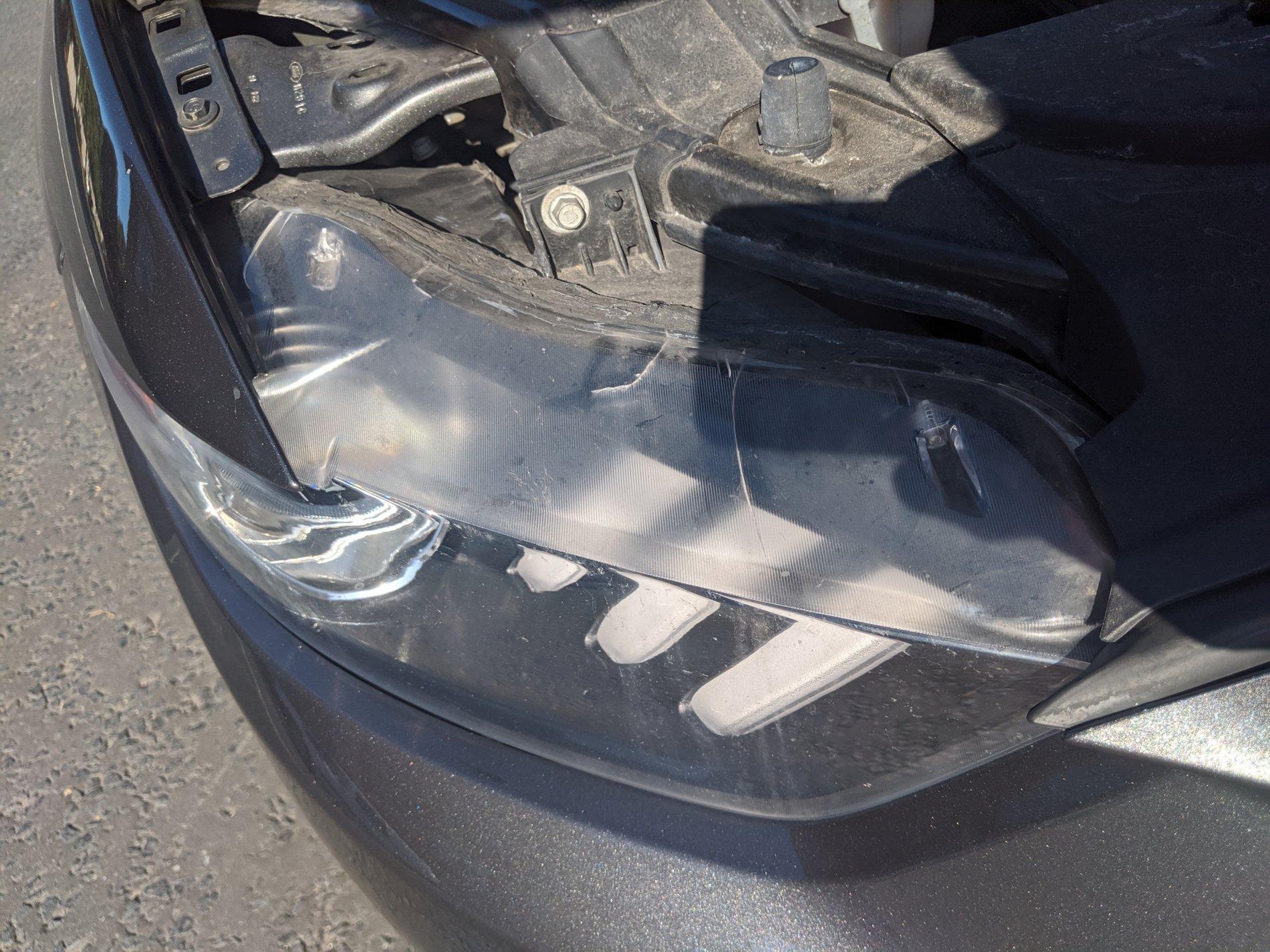

Right here you fellas. Hopefully they're clear enough!

And the award for dirtiest engine bay of the year goes to...........:cwl:
Christ those lights are bad, if you can try adding some more sealer to the cracks and tidy up the existing sealer you could add some black vinyl over the top where the cracks are, will at least tidy it up and hide the cracks.

Those lights will need to be completely disassembled, all existing sealer removed and then everything resealed properly based on what gifts are left behind.
Anybody saying apply more sealer or anything else other than the above is having a laugh.
Im even wondering if they cut the entire top lip off the channel on the lights. The amount of liquid you have in there, you would need some pretty big gel packs to absorb.
Problem you have is time. If it wasn't a daily, it wouldn't be too bad as winter is around the corner.
