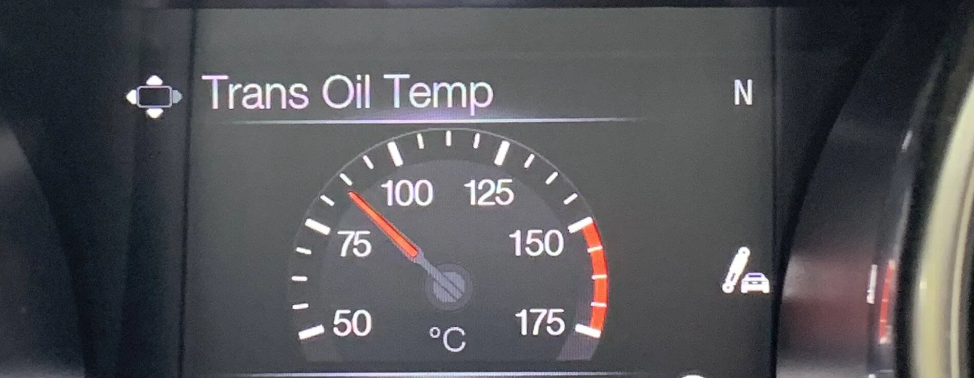

I activated my trans temp gauge on my '16 tech...in the most hottest and humid weather (90's F) and even in the occasional stop and go traffic I've encountered, I have yet to break the 125 mark (Celsius) on the temp gauge... ever. Put it this way, I spent a whole driving season with just this gauge as primary wanting to see how hot the trans got. Now, I am sure if i wringing the car out like a FP Track Attack car it would be a different story...but for the street I have no concerns.
Oh and BTW add mine to the list of 16's with zero oil burn, zero issues other than the plastic rocker panels rattling at speed which was remedied by pushing back in the push pins underneath...
My 16 was the same as well as no oil issues. Street diving is not an issue as you point out. Track driving for more than 10 to 15 minutes is another story
Agreed. I have really enjoyed mine and no issues on the street.
