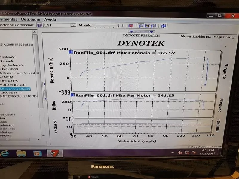

Stupid question as it sounds like pulling the fuse is the standard thing to do when doing the dyno. But, I'm wondering why, I would think since the pull is in 5th gear that there wouldn't be enough torque advantage coming from the drive train to kick in any traction control. Just curious.

Because the car senses the rear wheels moving while the front tires remain stationary and reports it as a fault, and goes into a limp mode...i watched my first stock pull hp get cut in half on the second pull because of this....pulled the fuse and no more issue

Stock on stock tune my base GTPP put down 401hp/395tq with out pulling a fuse on a dynojet, haven't been back after mods. Going to vary due to temp, moisture, altitude, and Dyno as well as who calibrated the Dyno. But it does seem just a little low.
