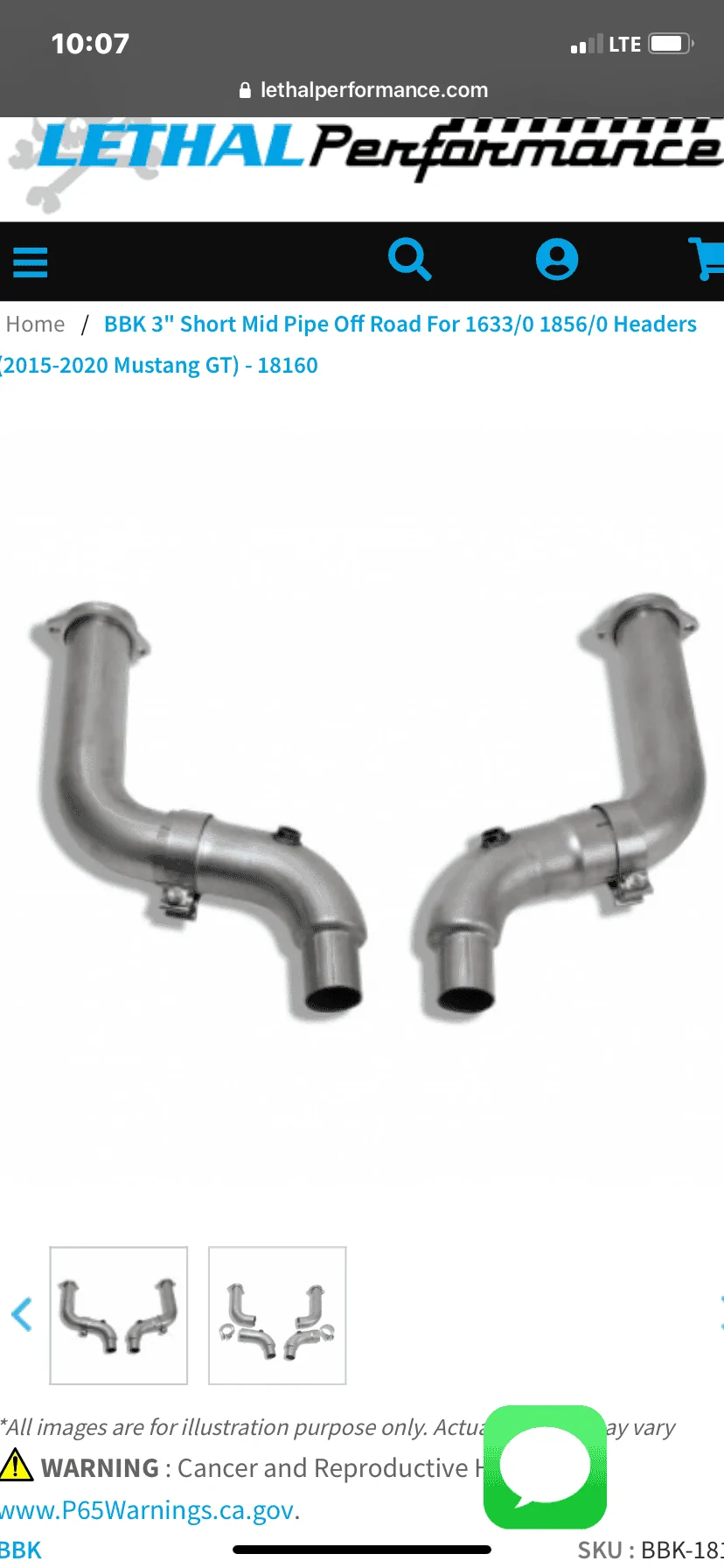

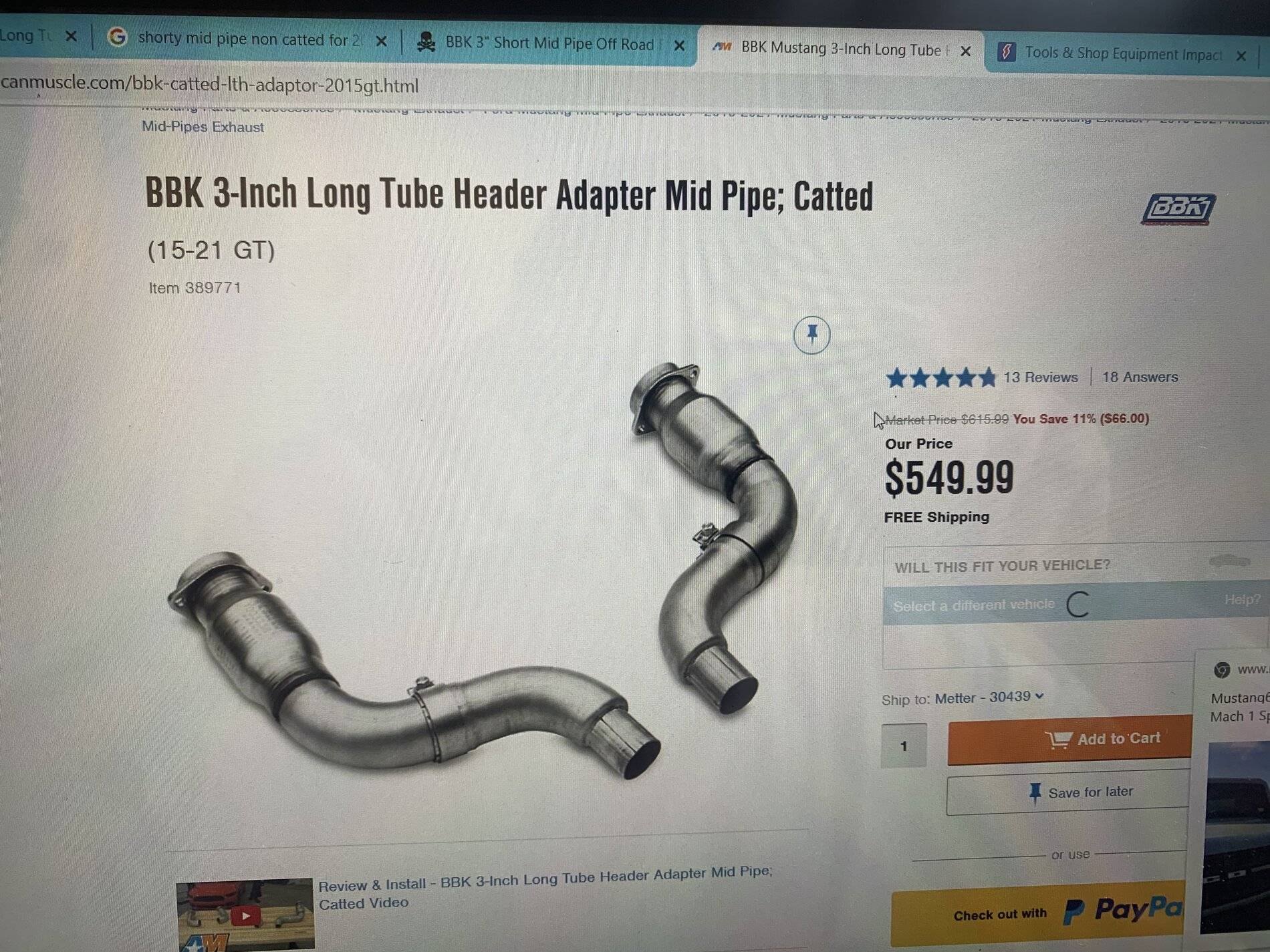

Ok so I have a 2015 and I’m trying to do a cat delete with bbk long tube headers withbbk off road Shorty mid pipe non-coated version all they have are the Katter versions if I Get a pipe made and do it without the cats is it gonna run without the tune I Has anyone ran into this problem there’s a picture of the cat version and the non-Cat version They don’t make the non-cat anymore

It'll run with them or without them fine. If the tune is for cats and you don't have them, all you'll get is a check engine light for the cats not working. If you don't want the cats, take the mid-pipes to any muffler shop and have them cut them out and replace them with straight pipe and call it a day.

I got BBk Long tube headers I just put them on I don’t have the flange to both up to it
