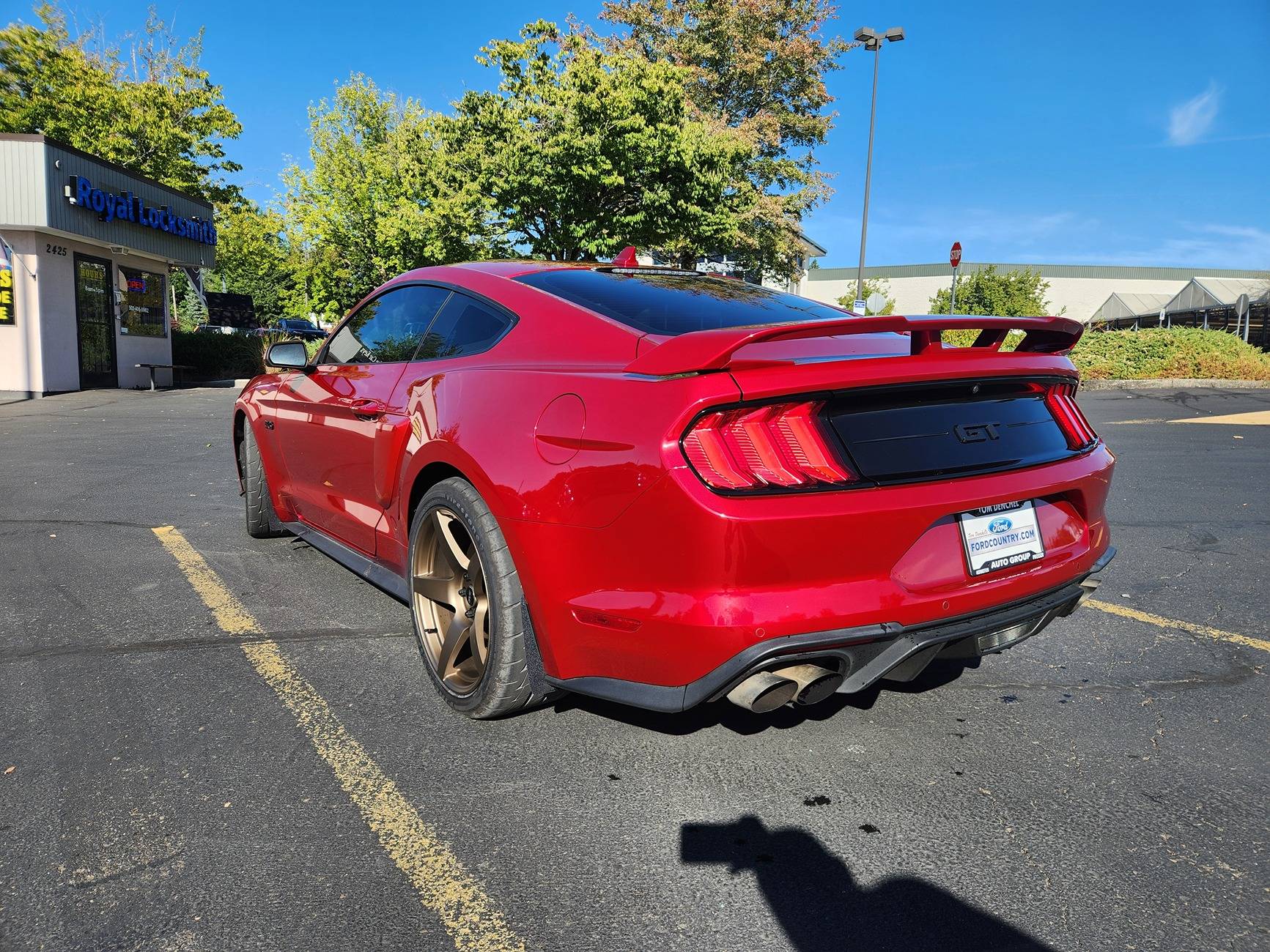

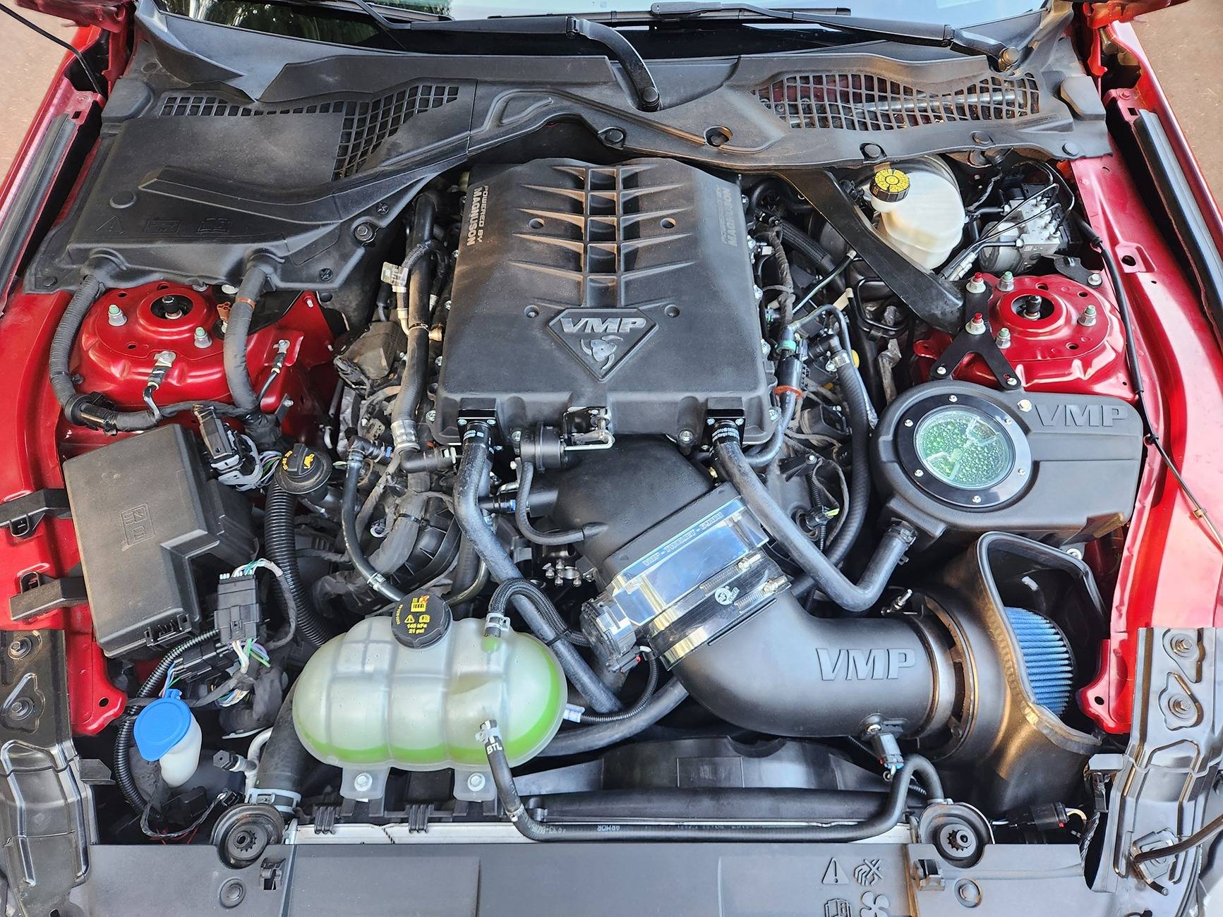

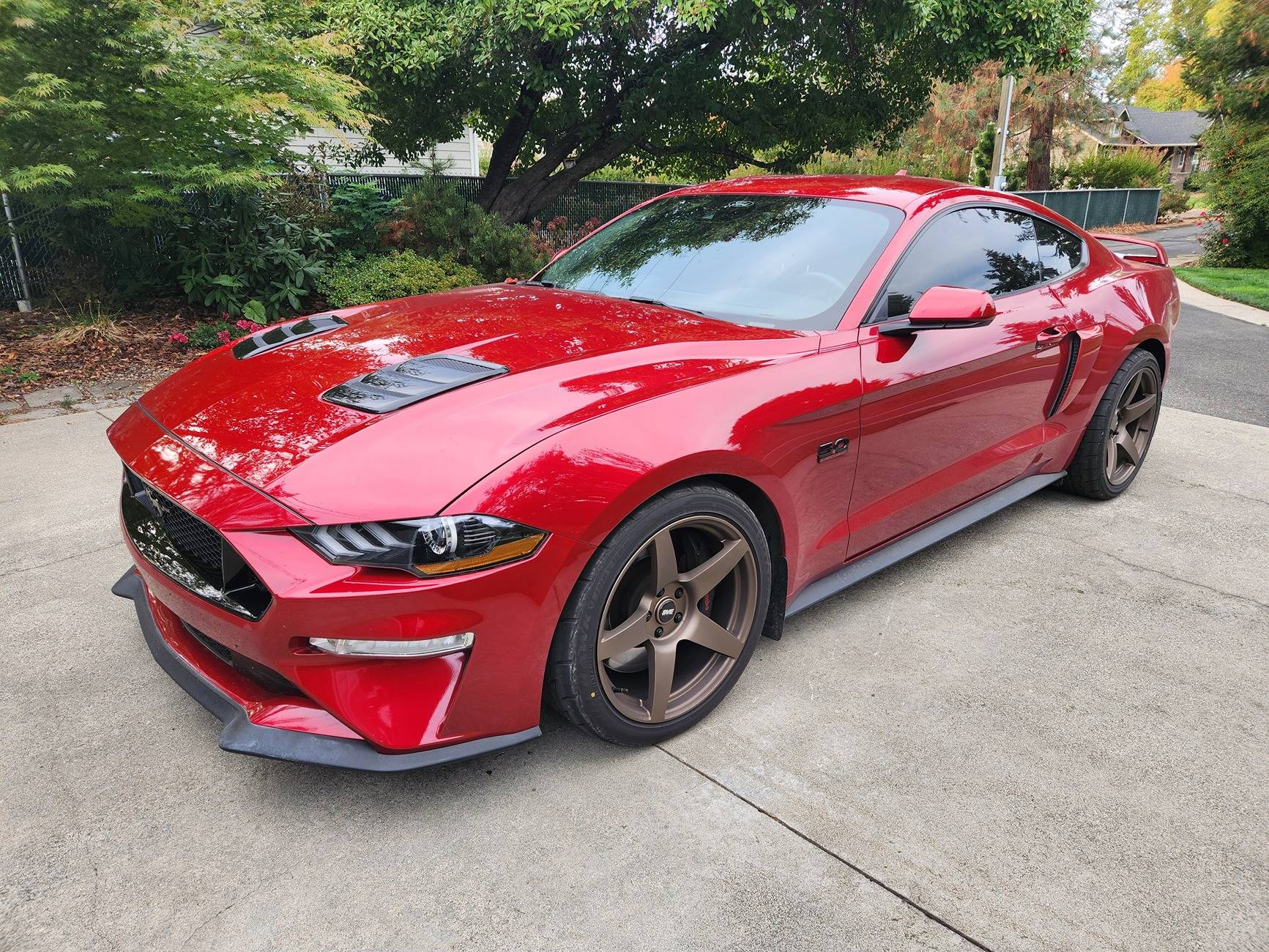

I have the Odin as well. To get any kind of traction I had to replace with 11 inch wide rear with a 325 width. I bought one of the SVE wheel packages from LMR. I was breaking traction at 100 MPH on the stock PP1 wheels with P zero summer tires. I have the Firestone Indy 500 tires and they have been great so far.
