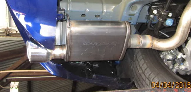

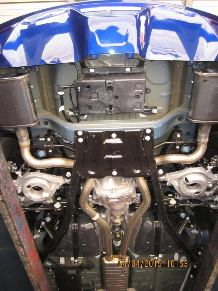

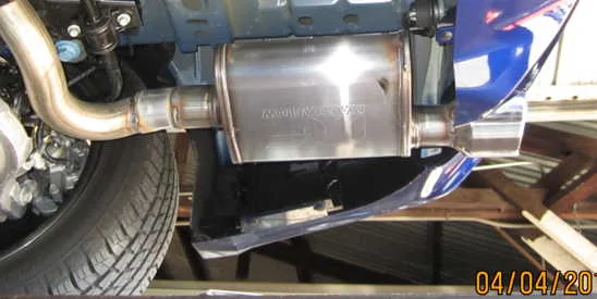

I do not know about extra bracing in back underbody of the convertible (to possibly add drone). I have some pics from when on the rack at the muffler shop. It looks pretty minimalistic under there. Hard to imagine a coupe having less! I'll have to check out the underside of a coupe though. I figured too that resonance from under trunk would travel through the trunk to the cabin. I had thought a soft top would be less likely to reflect sound back into the cabin than a hard top. But thinking about it, drone is more like a sub woofer (low frequency) that does not reflect like higher Hz frequencies, but passes thru surfaces (why sub woofers can work in a trunk). Hmmn... So my thoughts of insulating against low freq. sound waves, well it ain't gonna work. ;) So back to removing the source of the drone by different mufflers, Helmholz res. tubes or rolling the dice and seeing what BBK's will do to the drone. After thinking thru this mental process, I think I sadly agree (darn you Bmac!) that headers don't seem like they would be likely to significantly change the resonant frequencies currently being produced at the mufflers. But I may not have anything to lose (except $500 bucks for parts and labor ;)) for having them put on.
I do want to try connecting with Russian again before making a decision on headers. Here is the underside of a convertible.
