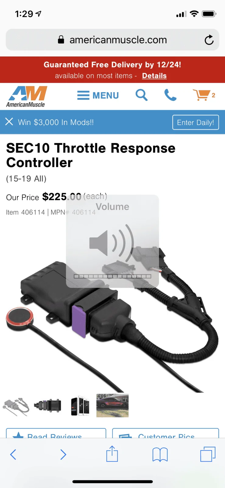

Has anyone installed this type of throttle response controller yet, to help with the throttle lag on normal mode? If so, has it made any difference with the lag on normal mode? Thanks everyone.

Thanks for the response I appreciate it. It's just so many different information out there, so u dunno what to believe sometimes. I read a lot of forum regarding the acceleration lag going from reverse to drive, or from park to drive. People have said it's throttle lag, and some have installed pedal commander to fix the issues. I've watched videos of people reporting it has made a difference when on drive mode. It made it feel like it was on sports mode, even when it's just on normal mode. To ur opinion would installing something like this help this issue on normal mode, even when I have an Lund Racing Ngauge installed already?
