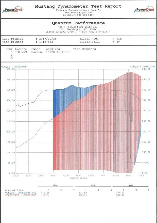

Mustang Dyno corrected for DynoJet numbers *i dunno emoji*
Tuner at the shop explained it that way.
I took a quick look at there Website and Facebook and saw they have some feature that "estimates" dynojet numbers. Not familiar with this feature but I would ask them for the uncorrected numbers . Last sentence four lines from bottom talks about it:

W/e just run it at the track and see your ET. That'll settle it. With 480 whp, you should be seeing what, about 117mph? Or thereabouts?

Everytime a Mustang dyno does *Estimated dynojet numbers, it is complete BS. Before I bought my Dynojet I was shopping all of the makes, and I actually had the MD dyno rep tell me that they were BS when shops did that, and they deeply disapproved of the practice. If I were to guess, those look more like Flywheel estimated numbers. By corrected, the operator most likely adjusted a setting to multiply the actual numbers by 1.10, or 1.15

^ Interesting information.
By looking at some of there post and the picture as shown below they may have done it by 15%. Top right corner lol :
