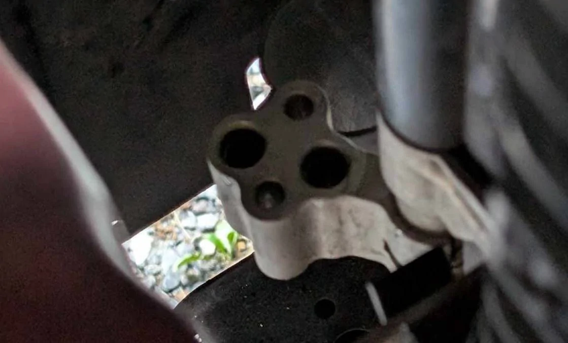

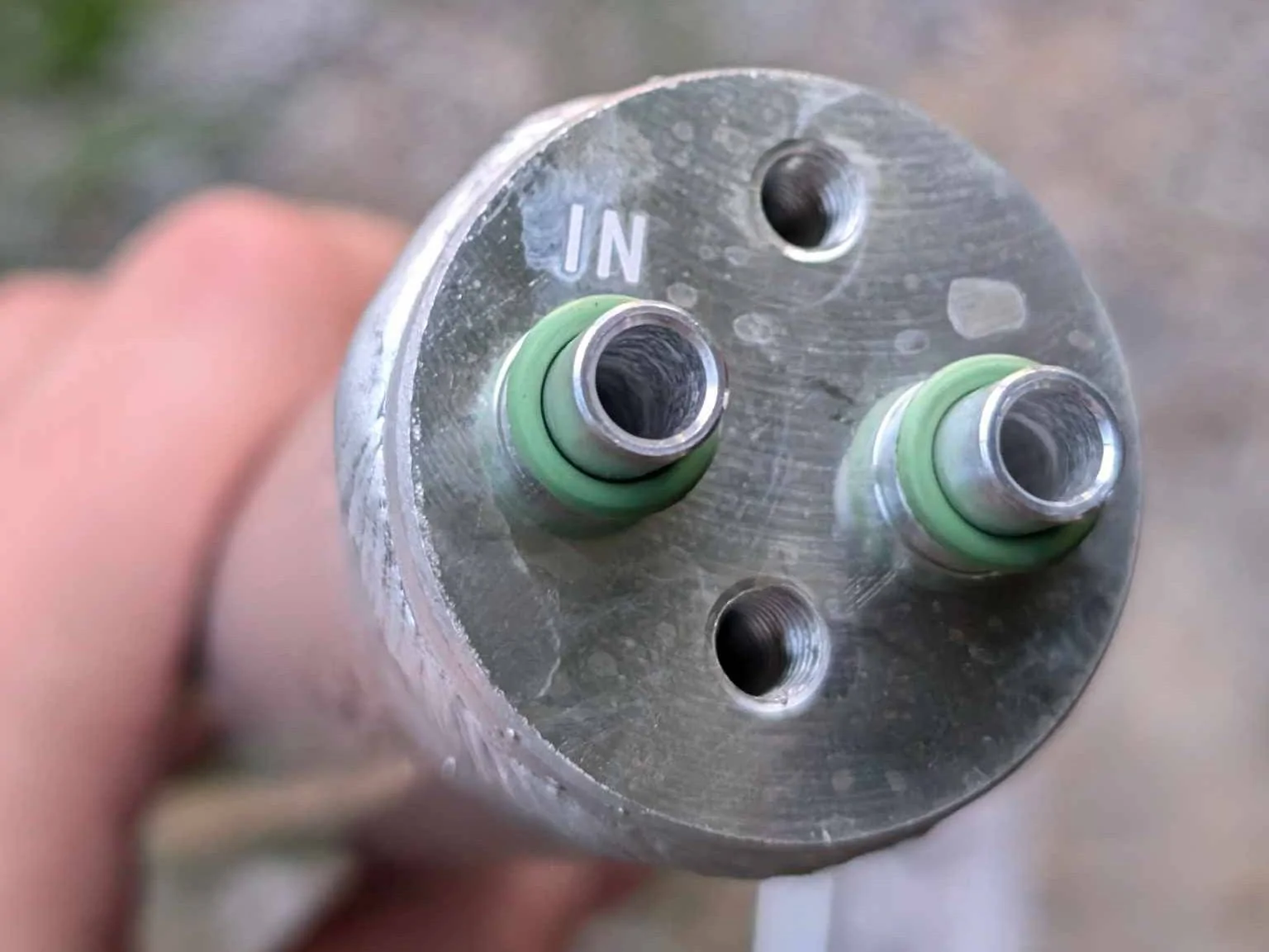

So my AC compressor clutch went out on my 2016 Ford Mustang GT. I replaced my compressor and now I'm trying to replace my AC drier tube. My new AC drier has on port labelled as "IN", however I do not know which port on the condenser it should go to. Does anyone have an idea of which port on the condenser corresponds with the "IN" port on the drier? Thanks y'all!

You've probably already figured it out by now, but the bolt threads will only align one way.
