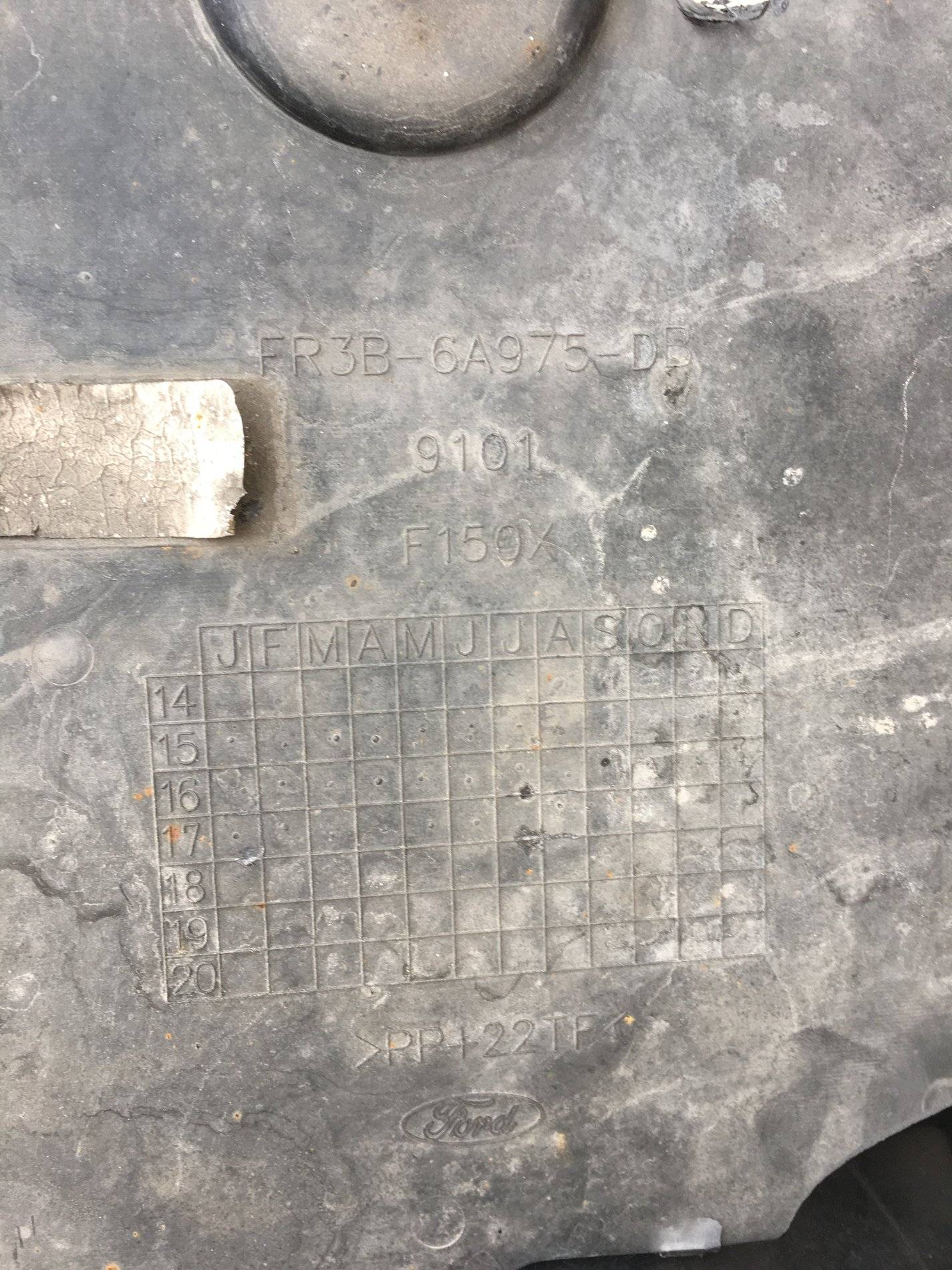

I can’t remember the exact amount of screws on mine but I think it was a lot. I just took mine off yesterday for a bumper installation. My belly pan model number is a bit weird because I can’t seem to find it on whitelake or any other site except ebay. I’ll post later tonight the screw estimate and push pin count cause I have to take off the belly pan anyways.

Thanks. I was actually able to find a 10 pack of the screws on Amazon and I ended up using 9 of them in addition to the screws I already had, so it definitely takes a lot of them. I think the splitter takes at least 6 additional screws on each side where the stock splitters use push pins. Luckily you can get 250 push pins and the screws needed for like $25 total on Amazon.
