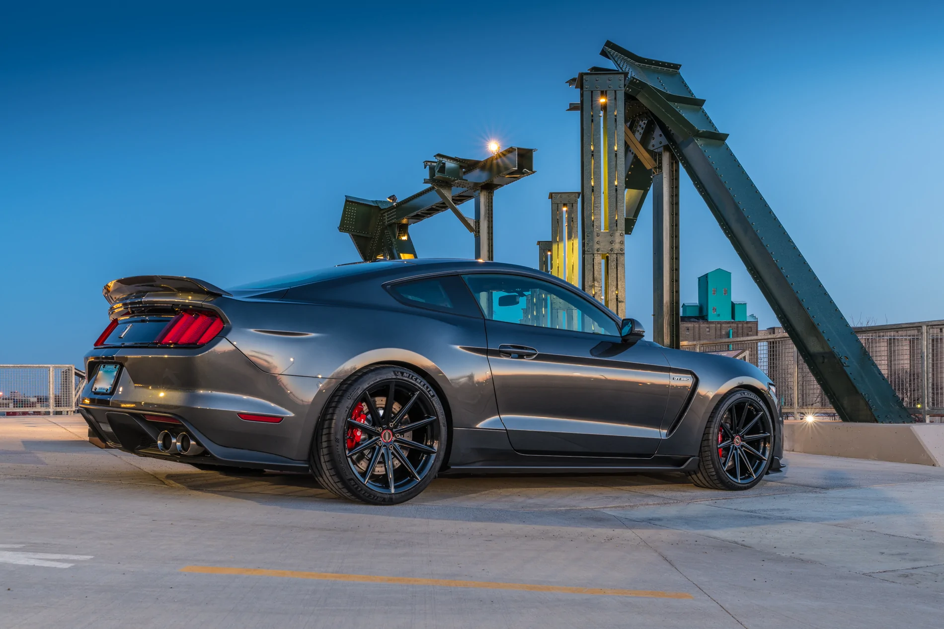

I am looking to buy 20" wheels for my new to me 2019 GT350. From what I've seen on the forum, I should be able to run 285/35/20 (front) and 315/35/20 (rear). Stock suspension, no plan on tracking. I want to run this size so I can put on all seasons. Want the 35 profile to fill the wheel gap / help me with NJ roads.
Should I be concerned with rubbing / fitment running those sizes? Also, if anyone is running a similar size (specifically 35 profile 20's on stock suspension), I would love to see some photos to help me visualize.
Appreciate the help, excited to be here!

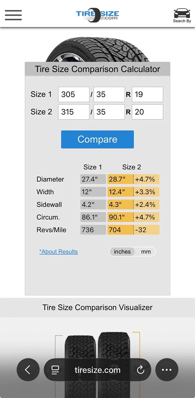

315/35/20 is pretty tall compared to stock tire diameter. Might want to consider a 30 profile tire

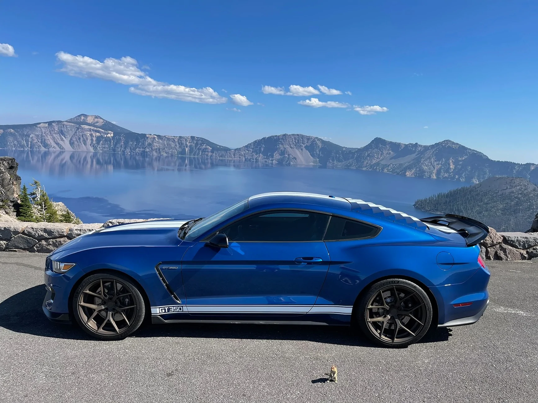

I am running 20 X 11 wheels front and rear. Tires are 295/30/20 in the front and 305/30/20 in the rear. Also have Ford springs in to lower it about 3/4 inch.
