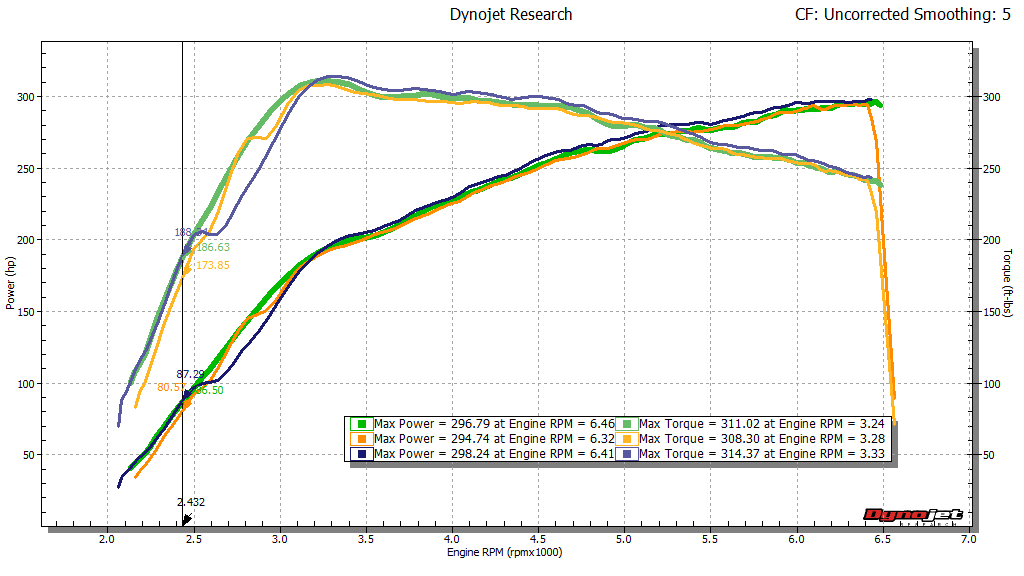

Was the dyno run, uncorrected or corrected? If it's uncorrected, it's the power the car was making under temp, humidity, barometric pressure at the time of the run. A corrected graph is one that adjusts the H.P for a standard conditions. It makes a difference.

Usually in the upper R/H corner of the dynograph, it will state corrected with smoothing, etc. The example below is a dynograph of my Fiesta ST when I was getting it tuned.
