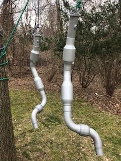

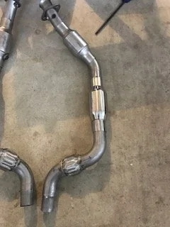

Never found one, so I got the Lethal Performance catless one. Welded in 2.5" cats, bottle resonator, flex section, and coated with a few coats of VHT. Haven't yet updated the MPT tune, but will soon after some data logging.
