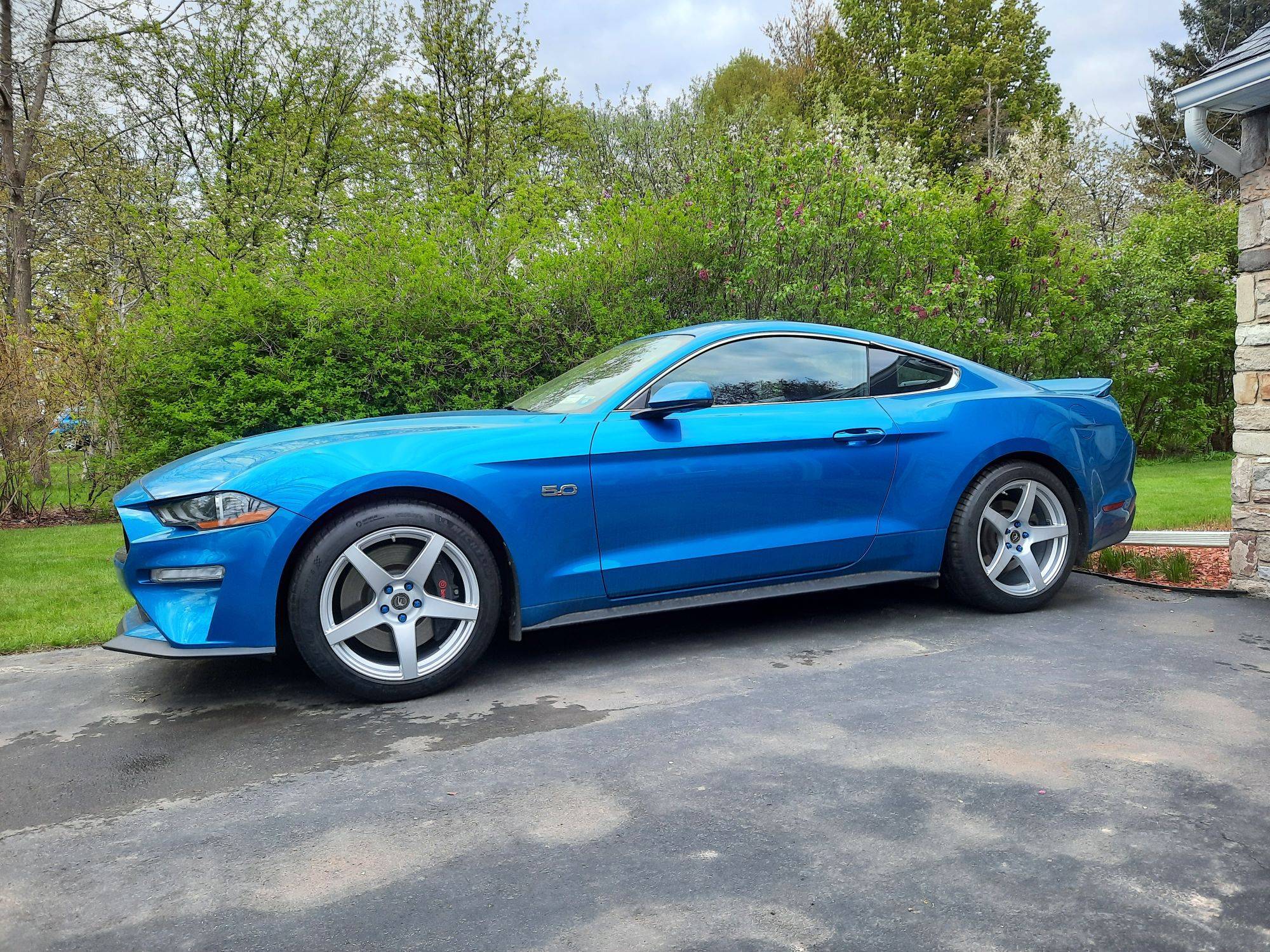

Try Forgestar brand. They have many sizes/styles under $500 per wheel. These are 19 * 10 +40 ET offset. I went squared but easy enough to get 9 frt/10 or 11 rear width. This one comes in at least 4 colors stock, Silver, grey, matte and gloss black.
https://lmr.com/products/Mustang-Wheels
https://www.steeda.com/2015-2019-mustang-wheels-and-tires
https://www.americanmuscle.com/2015-mustang-wheels.html (Be careful here. Many folks have issues with them.)
Thanks for the "helpful" reply to my actual question, as opposed to another opinion of what I SHOULD do to my own car.
I appreciate it.
I'd completely forgotten about Forgestar. They actually offer custom widths and offsets if I recall.
Nice wheels and a beautiful color on your car.
Is it lowered? If so how much?
How's the ride?
